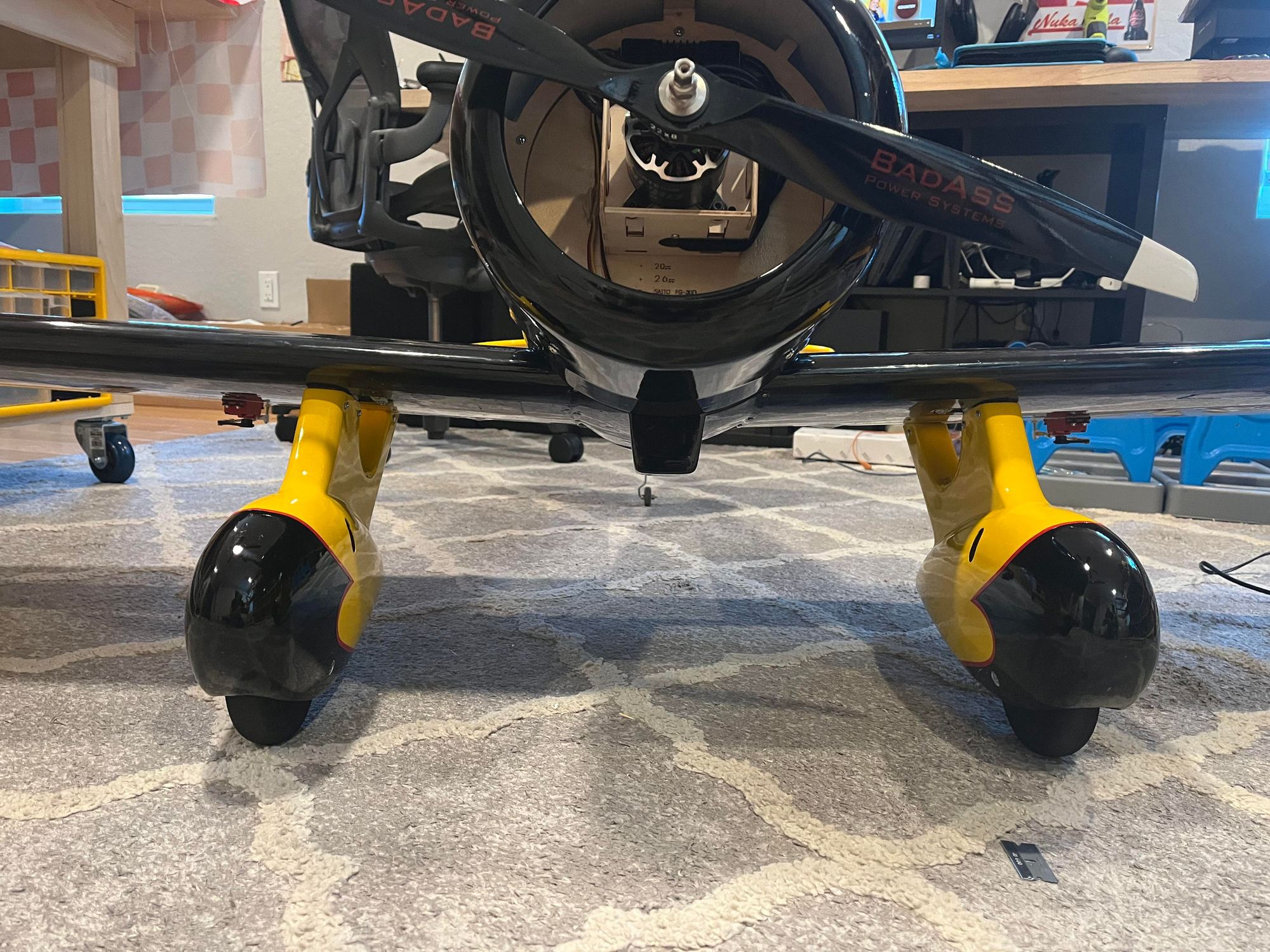

I did widen the landing gear about 6in to give it more ground control. Works much better, way less tippy.
Wont let me add the link yet but here is everything but the https portion
youtu.be/HF8CwOJ4zi8

I went with a 12s setup. I think I went with a pretty light setup, not sure how everyone is getting such a light build. Mine is right at 14lbs and it is a handful to control on the ground. Flight characteristics are good, the most unsettling thing is cutting throttle removes almost all of the tail control, so just dont be choppy with it. My setup is centered around the sound more than anything.

So for the gear, you opened up the wings on the underside and make some new wooden supports inside the wing and then cover it up? about 3inch each side?

I did open up the wing, installed new hardwood one rib farther out. Pretty easy to do with basic wood working tools. It is about 6 inches further apart now. I did get a chance to fly it with the new gear locations and it is so much better on the ground.
