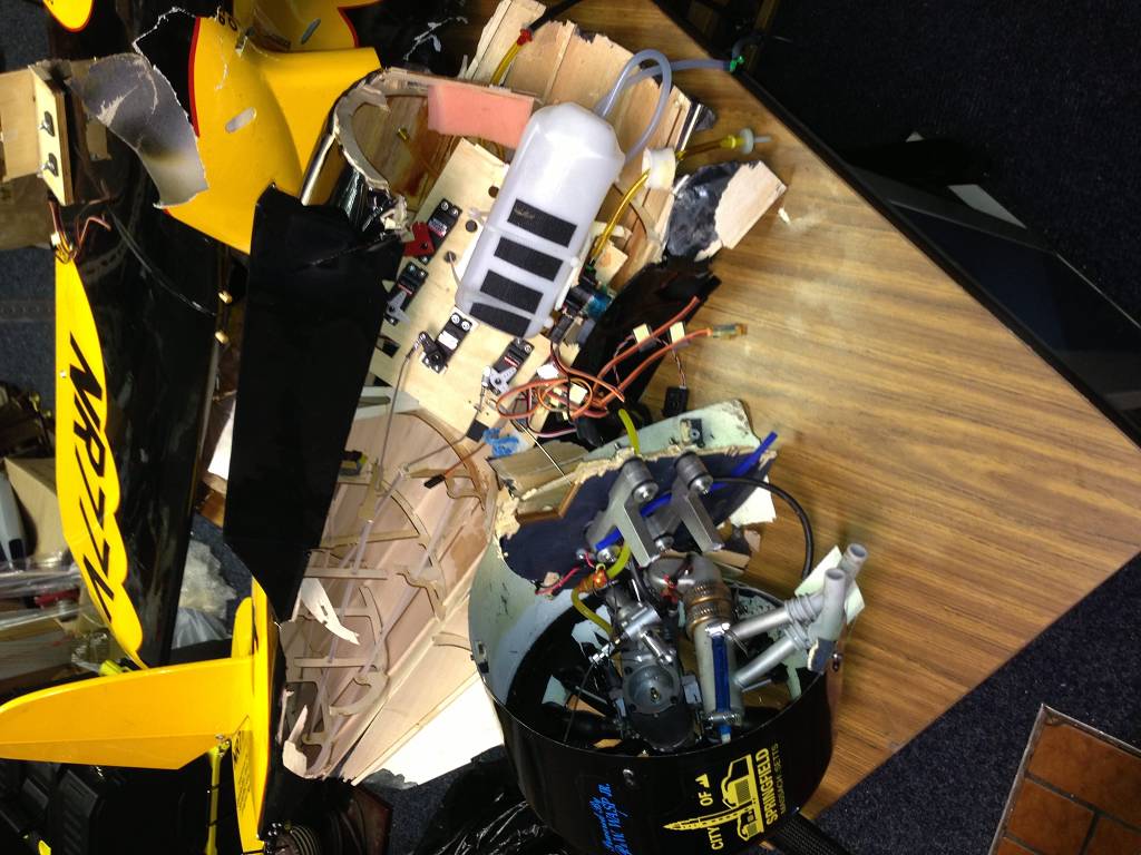

Finished my Gee Bee and flew the maiden fight Saturday 05-18-13 It flew great and required no trim adjustments! Second flight got the smoke working, and landed in typical bouncing GeeBee style fashion LOL! Need more practice to get the right speed and throttle for a smoother touch down. A fellow member made a video of the two flights which are seperated by a couple of other planes flying that day, so watch the video for the second flight and landing to see the smoke on! Unfortunately on my third flight, something went wrong, and I lost connection to the receiver, plane stopped responding to my controls, and went straight in. Lucky no one got hurt. I had been very meticulous with everything installed, ranged checked, did everything by the book, but something caused a lockout or brown out. I flew this with a spectrum DX8 transmitter. I turned the plane on again, and everything was still working fine. The next day without charging the battery I checked the radio gear again, more range checking with a t1000 telemetry module hooked up, and all is working fine. I have not figured out what failed yet. http://www.youtube.com/watch?<wbr></wbr>v=bbqWsXLibes&amp;feature=share&amp;<wbr></wbr>list=UUtrGjp6iPi1RIcdtglP1ajQ
You may have to copy and paste this entire link to your browser. I will have to build another one soon because this was a great looking plane, and flew really nice! Pete

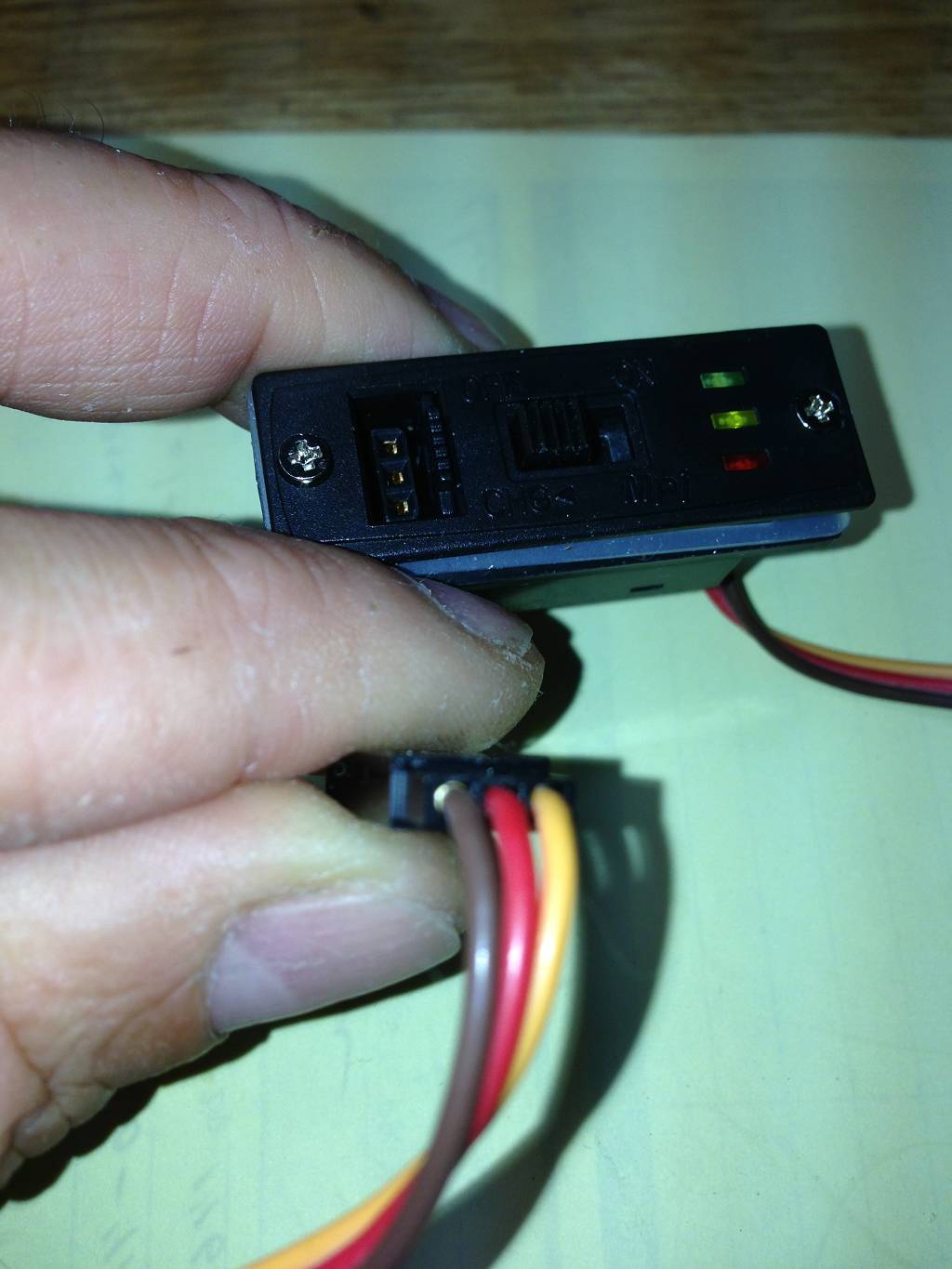

I went through the radio gear still in the wreckage on my bench very thoroughly today. I turned everything on and began wiggling wires and connections. All at once the Orange LED on my receiver flickered out! The problem was located in a brand new 25.00 MPI switch with LED voltage monitoring, and charge jack. The brown wire (negative side) pin connector was not fully seated into the connector plug socket during factory assembly! This meant the pin was too short to make good contact with my battery connector, even when tightly held together with a safety connector clip that was holding them together! As you tap the connection with your finger, you can see the receiver turn off, and stay off till you tap it again! So not just a quick brown out, but a prolonged disconnection, preventing the system from rebooting in a second or two that would have regained control. I am relieved to find the cause of this 1500.00 crash.

Well at least you know the cause of the problem....sadly, MPI isn't going to do anything about your loss......

Here are a couple of photo'showing the pin not properly seated in the connector, making it too short for a solid connection to the receiver battery. Another photo shows the end result! I bought new stuff, put it together and everything seemed to work fine, so I went flying. Now I have learned I must do my own quality control inspections on all manufacturers products in order to help prevent such expensive losses!

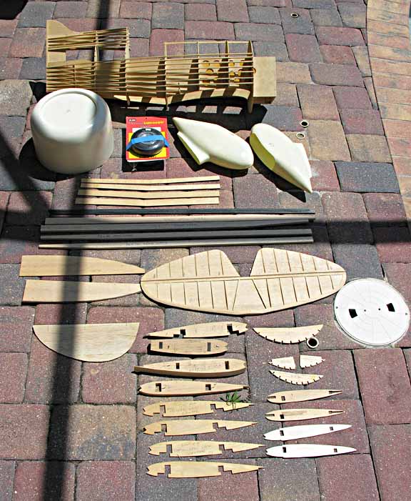

There for the taking. 72" in span and all the hard work completed. Flies like a dream.

The cockpit looks more to scale than the seagull ARF. Do you have the plans? What manufacturer's kit is that?
