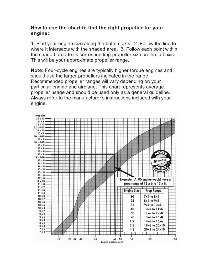

I have an OS .75. I flew it around 20 flights and couple of crashes. The first two flights are ok, no problem doing loops, rolls or hammerheads. In the third flight after a hammerhead the engine kills. This is the second time this happens!!!. I've been lucky to land it without mayor problems, but I am puzzled about it. Any clues?

I have cleaned the carb after my crashes and that was long time ago. I let the engine rest for 20 - 30 min after a 13 min flight. I have a big tank to fly up to 15 min, and I think the clunck is working ok since in the first two flights I do all kind of acrobatics, specially hammerhead. I don't think I have leaking since the firewall is always dry after each flight. I have a 13x6 prop, and I set the high speed neddle at the top of high pitch whine. If running too lean is the problem, why the first two flights are ok? My engine is mounted at around 270 degrees, would that be a problem? Attached is a engine size vs prop size. I think I am within the range....

pbuenafama, you are going to have to physically check clunk and tank for leaks, once satisfied everything is ok, tune engine like you normally do, then richen engine 2 clicks. You should be able to tell pretty fast if engine is going to stay running. If not land and richen 2 more clicks or untill engine stays running. If you don't have a tach, get one and this will help you determine how your engine is running. Top of high pitch whine is not always best tuning point.
