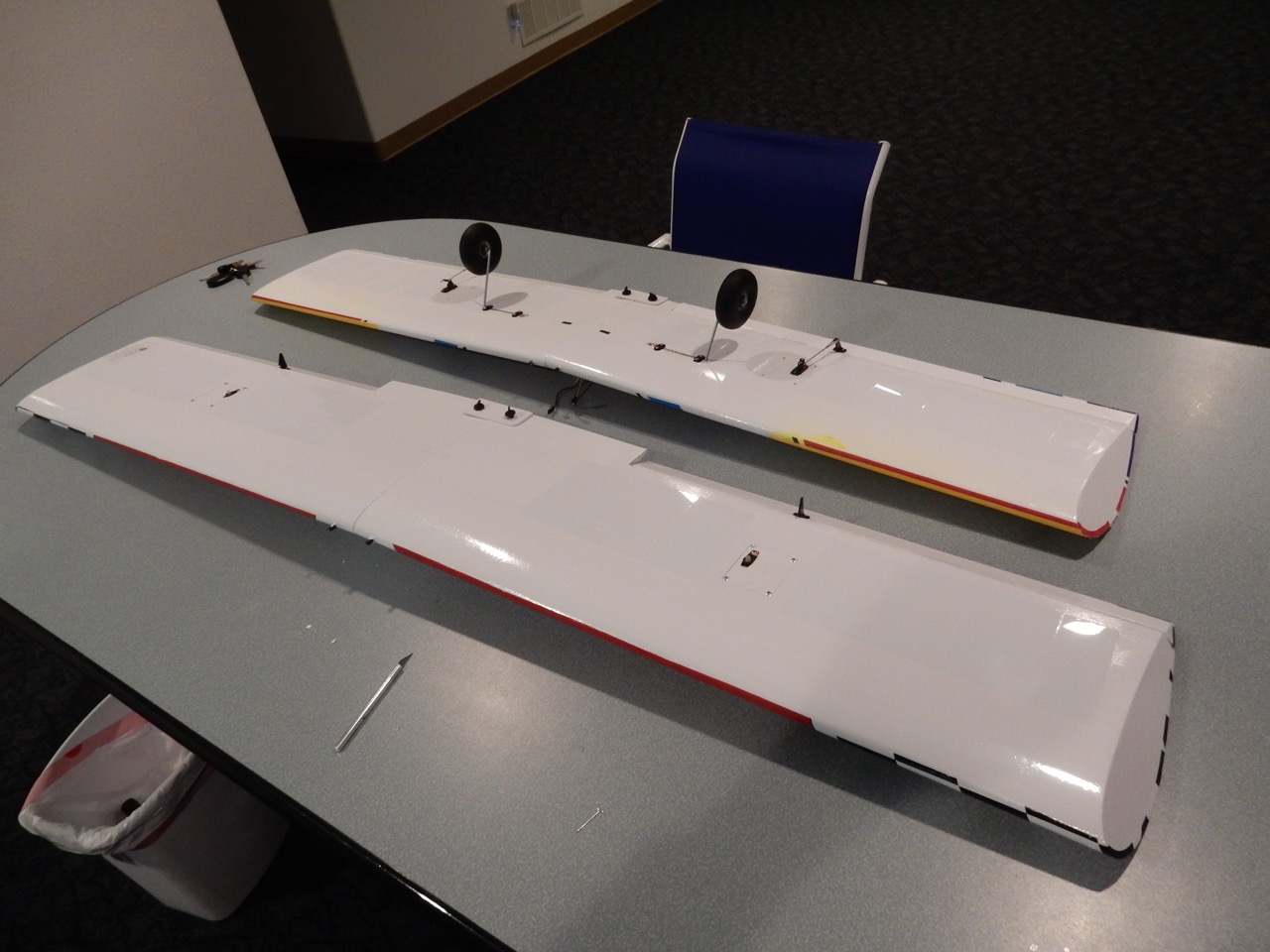

Finally got started putting the bigger Tiger together. As you can see in the photo, the wing is considerably bigger. Covering on this one has some loose edges and even some exposed wood. Other than that it looks great. The bigger version also comes with unhinged surfaces and CYA hinges supplied. I liked the smaller version as it has normal hinges that were pinned in, and I am replacing the supplied CYA hinges with Dubro standard hinges. Should have two Phoenix Tigers in the air by spring.

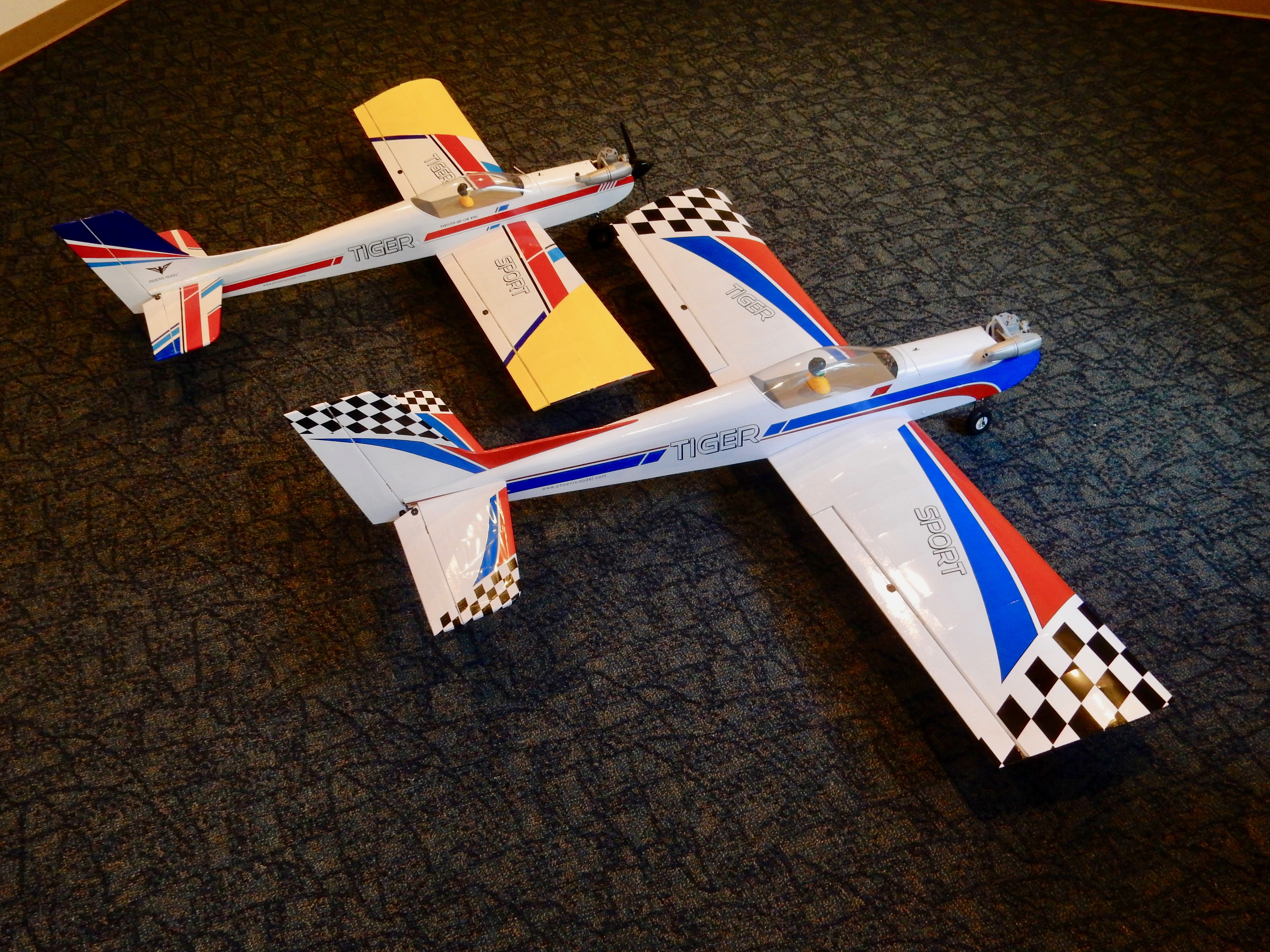

Here is a comparison of the original Tiger and its big brother. I love how these planes go together but did run into a minor issue today where the wing bolt holes don't seem to line up properly. Other than that it has been smooth sailing. I replaced all the cheap hardware with Sullivan and Dubro stuff as I don't like little screws holding clevis connections together. The small one weighs in at 6 lbs 4 oz and the bigger one is 7 lbs 5 oz, or just over a pound heavier. With those changes, wing loading will actually be lower on the bigger ship than the small one! It should be a good flyer.

Taking some measurements today and looking at the wing mounting, I see that the right wing panel has the hole drilled about 1/16 inch off where it should be, and it is drilled off at an angle much different than the other wing panel. Appears it was drilled out with a hand held drill. The left wing panel is right on so I can use that as reference as I figure out how to correct this issue.
