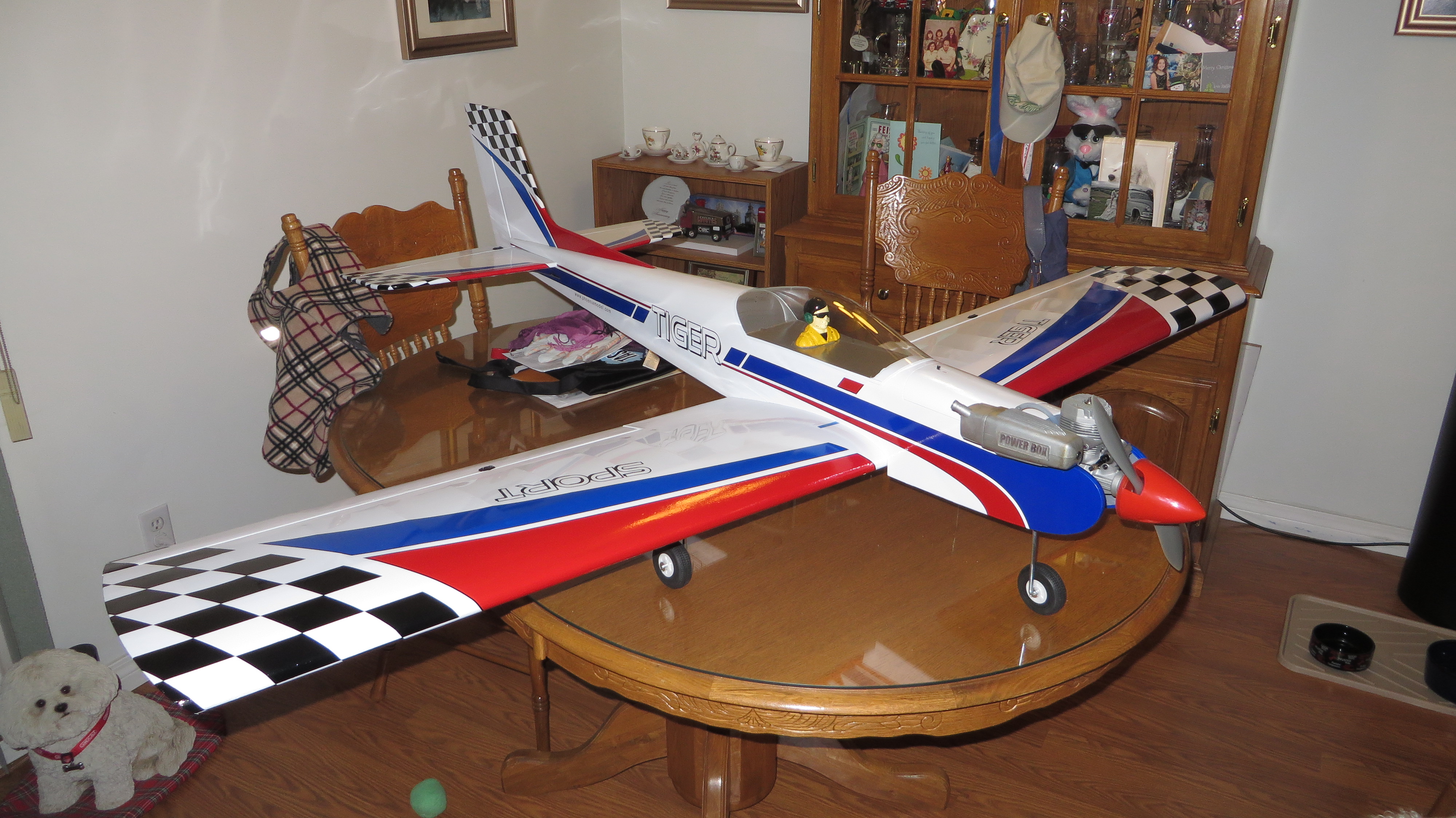

Here is mine completed, came in at 8 lb 7 oz with the 95AX. It is very well built but the covering is like Mac Tac. Not your typical heat shrink covering. The glue is not heat activated but sticky all the time. Never seen anything like it. Hopefully it holds up OK. You have to be extremely careful with heat. Even with the heat set on low with my trim iron it melts.

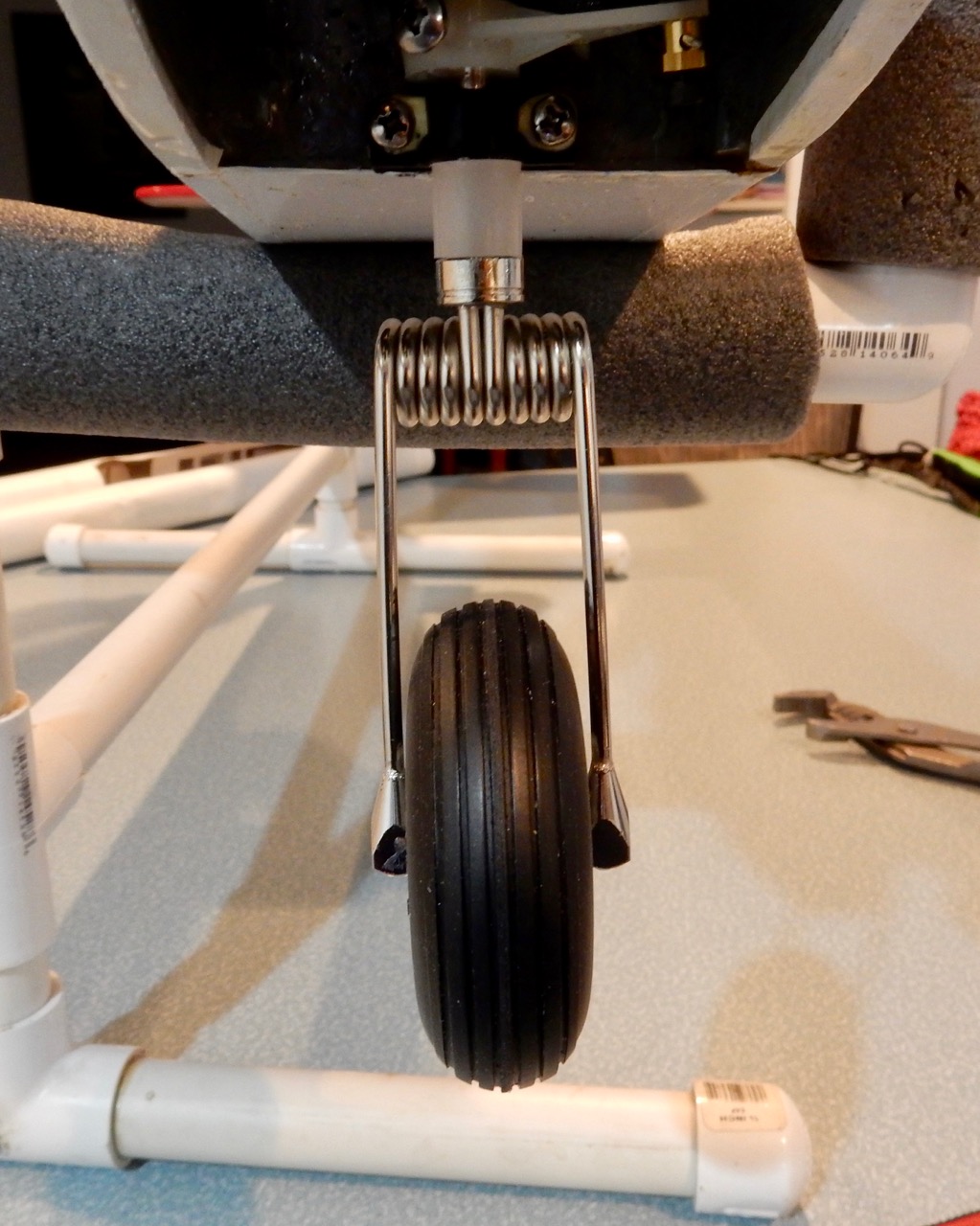

Bent the nose gear over in soft grass on take off yesterday on the Tiger 3 and replaced it with a Bob Fults dual strut nose gear. The gear that comes with the ARF is made out of very soft metal as I could bend it back into shape by hand.
Good to know about the nose gear! That Bob Fults replacement would seem to do the trick as it looks pretty robust. Thanks for the info.
