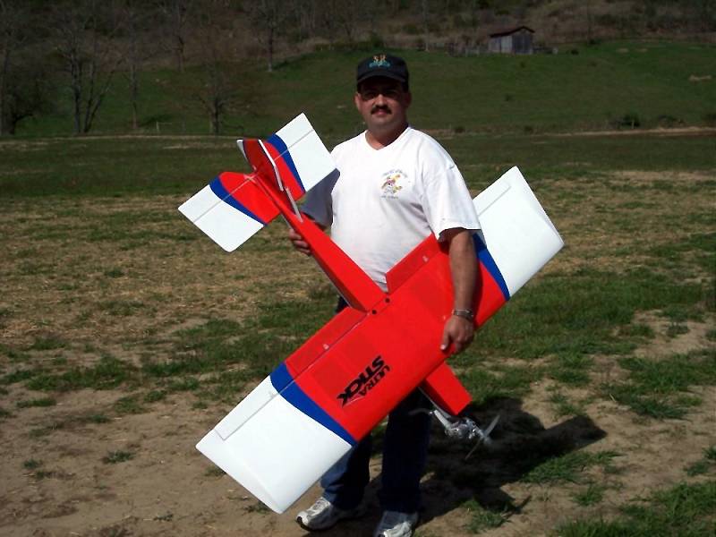

I did a quick search and found this in another thread.
Hope this helps.
You'll Love the Ultra Stick. I just maidened my Ultra Stick 40
this season and I LOVE IT!
ORIGINAL: CGRetired
As mentioned before in another thread, it does nothing to cure flutter. Flutter occurs with loose hinges or hinges that are not installed properly, not by the gap.
The gap sealing prevents the differential in pressure allowing air to pass through the gap from the lower side to the higher pressure upper side of the ailerons thus making the ailerons more effective.
See: http://www.rcuniverse.com/forum/m_6162543/tm.htm
and read on down a bit. This is all covered in pretty good detail.

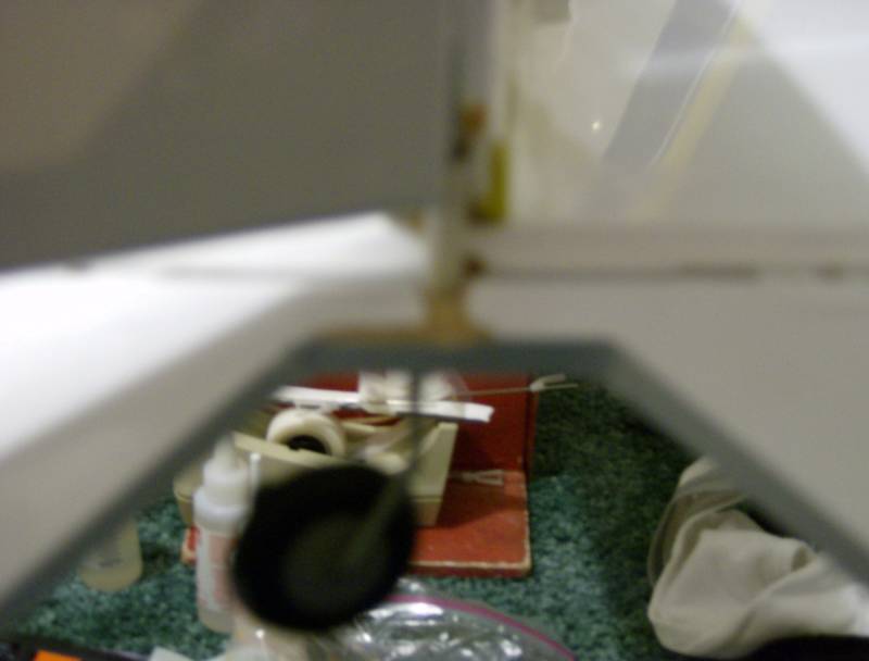

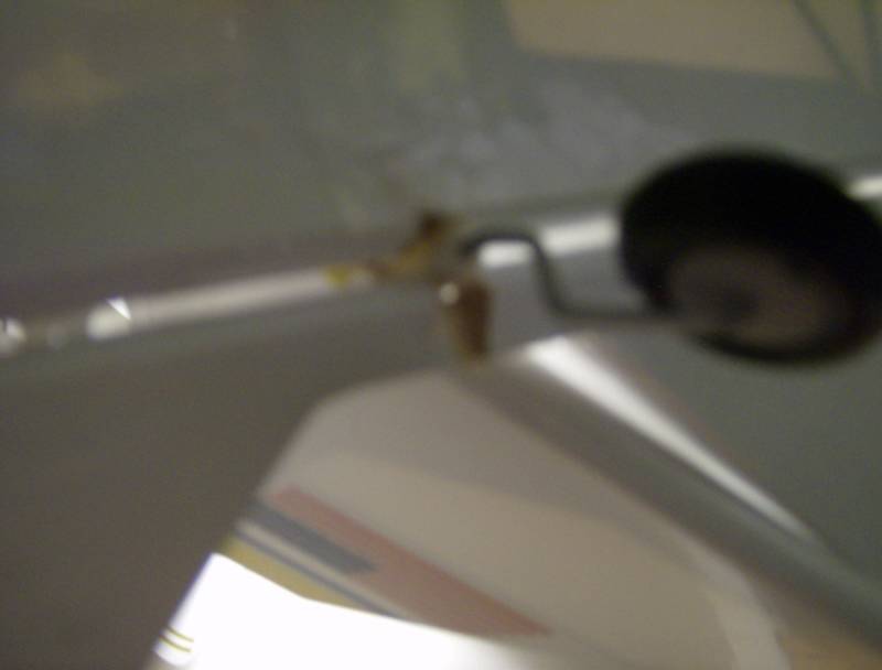

Did any of you have a problem with the center of the elevater hitting the tailwheel bushing even after cutting a slot in the center of the elevater? If so, how did you fix it? Mine is hitting on it and I cut a big slot in the elevater and I still can't get it to deflect to the recomended high rates(38degrees). also wondering if it would work to just cut it in half and glue it back together with a piece of wire.

Here is some pics. Sorry for the bad quality.
