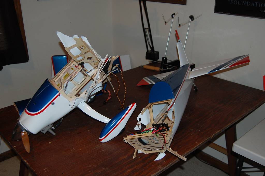

This is what happens when you do an incredibly cool 45 degree, crabbing cross wind landing and then say, "that was awesome, think I'll go up and try again".

afjetmech - really sorry to see that. That hurts. Seems like the "just one more flight..."tends to be the stinger. On the upside, it looks like it's only the fuse that's damaged. You can cut out and reuse the tailfeathers, cowl, gear. Are your wings ok? Or fixable? When I've had a similar crash, to re-use the tail, on the new fuse I use a hack saw to cut out a small section just after of the elevator opening (like an episiotomy for a plane!). That way you can slide the horizontal stabilizer \ elevator combination in from the back (instead of sideways through the opening). Then, when you epoxy in the stabilizer also epoxy back the piece you cut out. Saves you from having to remove and re-attach the elevators to the stabilizer. You'll still have to dig the rudder out from the fuse, of course.

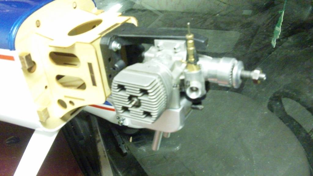

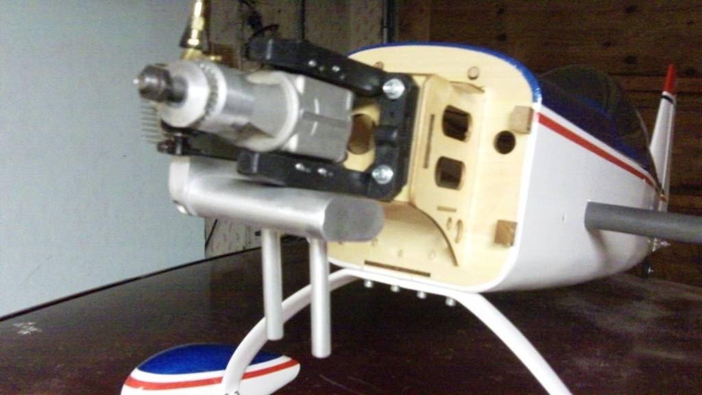

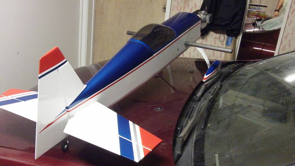

More building today, I tell you, this is an awesome airplane, I feel I'm cheatting on this build its so easy, really they've done it on this one. I have buildi many ARF before and by far this has been the easiest build ever, everything fits and Grate Planes has thought of everything you may need and also have done a lot of those little things you need to do.

CARS II - your Revolver looks good. Is that an OS 120?
Old 08-25-2011 | 11:59 PM
  #3648
CARS II's Avatar
My Feedback: (7)
Posts: 6,658
Received 137 Likes on 120 Posts
From: Sacramento CA
Default RE: Larger Revolver
microdon2
Thank you, that is a ST 90, the Rev will be her 3 airplane by now, the first airplane it pulled was a ( again a ) F-4.
