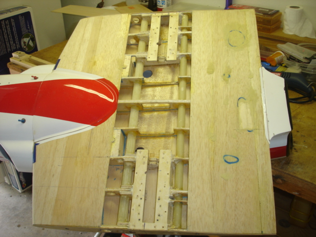

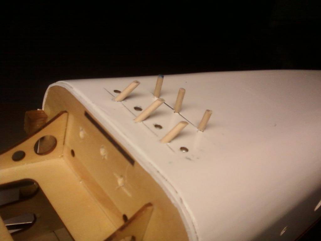

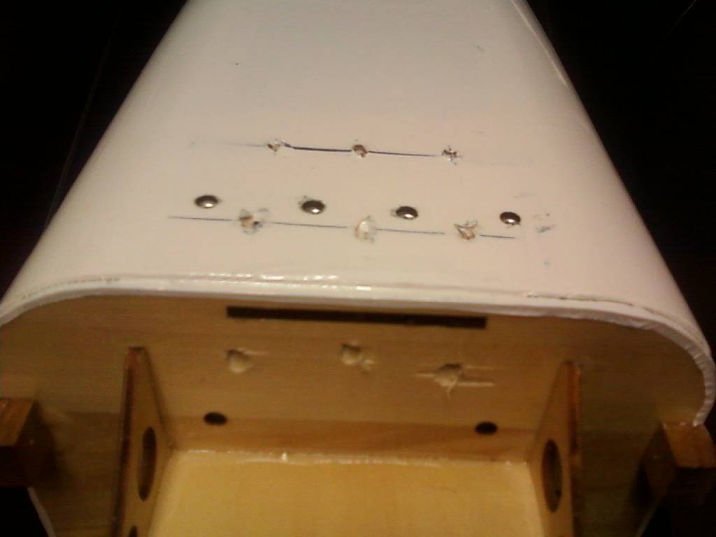

The building of my revolver has started, here are some pics of my solution to the landing gear weakness, simple, clean, light, easy, the best part. I got the idea after viewing the pictures from jet22b of his broken gear mount, there I was able to see the mount plate shape and the gluing points, I have done this before ( picture ).

You guys that are trying for a good and easy way to remove ca hinges...simply use a thin cutting wheel on a Dremel and cut right into the hinge. It will remove the material usually in one cut. If you choose to go with Robarts, then use Gorilla glue instead of epoxy for a better bond. Just make sure you wet the balsa before gluing.
