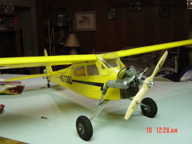

My latest is a vmar cub 54" either 400 electric geared or 1/2 A glow I sliced off the really
bad wood beam mounts glued on a new firewall 1/8 ply to original radial plastic mount
OS10 davis diesel Dural gear added big wheels super flyer plane was$59 ok with new
dural gear and wheels an other$15 I just got a new cowl for this the first one was lost in
a bad ground loop only damage broken prop and cowl the "Tundra gear" works well on rough
fields on the OS 10 diesel 9x4 prop gets it off in a very short run
