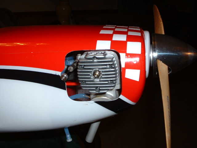

And the side.

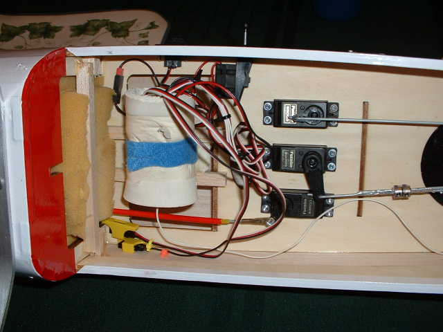

Servo compartment.

Spank you veddy nice!
Is that your fill line hanging out the bottom?
Your opening around the head is bigger than mine, but the exhaust outlet is about the same. I guess I'm going to have to re-work it though as I just got word that an ASP .91 that I'd ordered some time ago and had actually forgotten about shipped from JustEngines today. The Webra is going back to it's old home...

I was told by a good friend who fly's larger planes that for proper cooling the opening at the bottom should be double the size of the intake.On the ground and in the air I saw no signs of over heating with mine,hope this helps.

Hey David, how big are the openings on the front of your cowl? I wallered mine out pretty good, as I've cooked an engine or two in the past with cowls. Cowls look nice, but you got to make sure you get a lot of air around that engine.

Oh I hogged 'em out good. You know what it's like...once you fire up the Dremel it can be hard to control yourself.
I really don't think the problem was overheating thoug. My Webra has a Super Tiger carb on it for some reason. I've been told that these carbs work OK but will leave you with a very rich mid-range. My modelling guru, the guy who was on the sticks for the last two flights thinks that excess fuel was putting out the glow plug. We were going to try an idle-bar plug, but I just got an e-mail from Justengines -- seems like they just shipped me the ASP .91 "s" that I'd ordered back in June. To tell you the truth I had forgotten all about it. The guy I bought the Webra from told me he would take it back after my last "landing", so an ASP .91 it is. I'll let y'all know how it works out!
