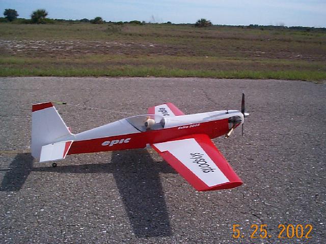

I have one of their 58" 300's Wing comes in one piece. I got mine when they were still "Epic". It is a great plane. I have a Magnum 91 four stroke on it.

I got the exact same one cooter has Got a Saito 80 on mine
