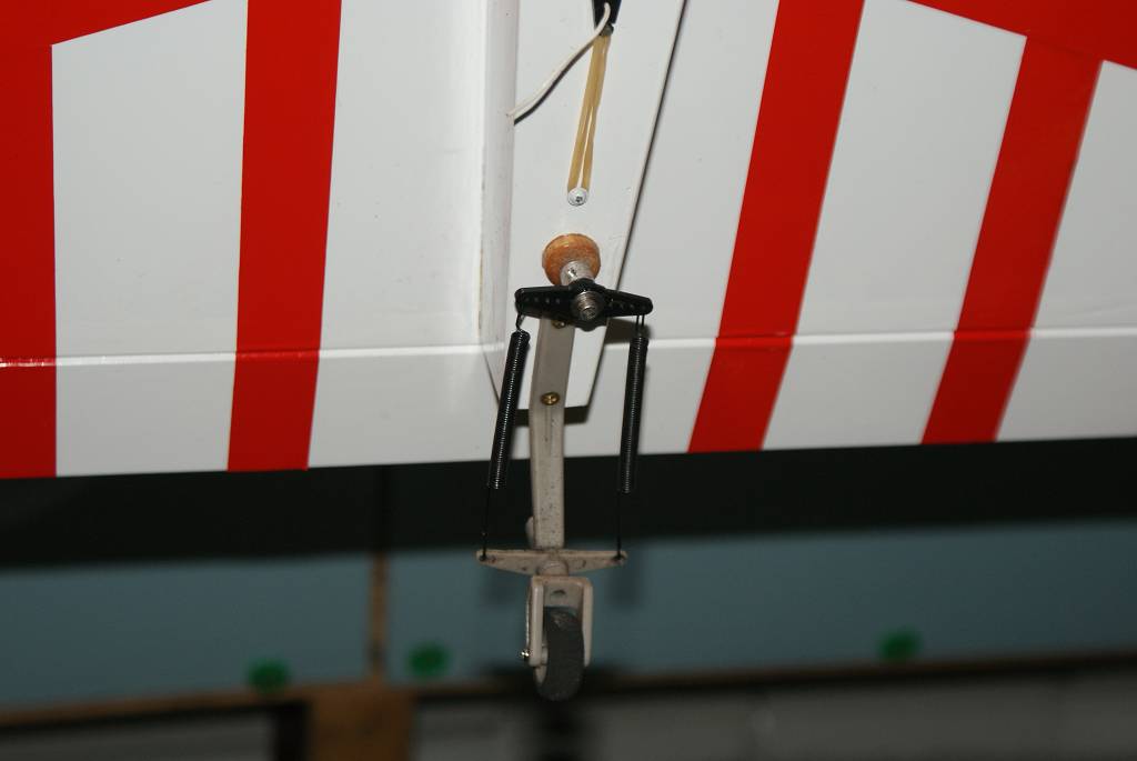

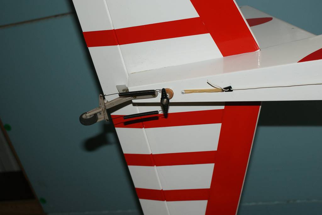

lol thanks guys all this helps, the funny thing is that i must have typed something wrong because i tried a search again and came up with quite a few things. think i am going to of course disconnect the front wheel, in the place of that run a nyrod to the back, alongside the elevator rod, then just hook that up to a tail wheelhttp://www.greathobbies.com/products/d/dub/dub955.jpg hopefully that will work i have some main gear lying around hope this should work. any other suggestions
Old 03-07-2010 | 04:00 PM
Joined: Dec 2007
Posts: 181
From: edmonton, AB, CANADA
Default RE: LT 40 conversion
just ran a nyrod from tthe rudder servo to a dubro tailwheel, simply pulled out the front wheel control rod and bolted some main gear 3 inch ahead of old gear, onto the plane with nylon bolt, i like those for gear and a small piece os light ply inside for support and.will post some pics later
