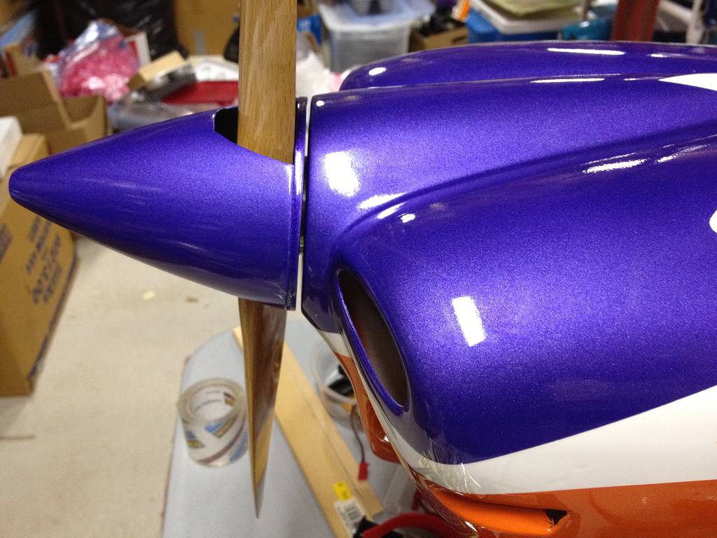

I'm stil pretty timid with his thing so I haven't gone full throttle with it. Mid-throttle is pretty much where I stay. It balloons out of banked turns and balloons with the slightest addition of throttle at landing speed. If I release elevator on a nose down approach it will nose up and balloon pretty quickly as well.

My original thought was that it was tail heavy so I moved weight forward. It is definitely nose heavy now compared to thw recommended CG. I'm really thinking it is a thrust issue....especially since I am the only one whose cowl doesn't line up with the spinner. My spinner appears to be "lower" than anyone elses. This suggests it might have too much down thrust.

Great shot of your Sbach. I've got the same color scheme and it is simply a beautiful looking plane! The alignment of your spinner and your cowl makes me curious if mine somehow got down thrust in it. Mine tends to balloon on landings. I'm told this could be from too much down thrust.
<div style="margin: 0in 0in 0pt"><span style="font-size: 9pt">Thanks Don... the color scheme certainly looks great as well as easy to see in the air.As for the alignment, I really didn&rsquo;t do anything different from the docs&hellip; I just drilled at the marked location on the firewall and mounted my DLE 30 v2.My CG is behind the tube&hellip; and it&rsquo;s a pinch tail heavy, but that&rsquo;s where I normally set my all my planes.I didn&rsquo;t notice extreme ballooning when I throttle down&hellip; but it does take it&rsquo;s time to bleed air speed on landing. That just could be that the plane is streamline&hellip; or I&rsquo;m just use to my late Yak.</span></div><div style="margin: 0in 0in 0pt"></div><div style="margin: 0in 0in 0pt"><span style="font-size: 9pt">What engine are you running on your Sbach?I&rsquo;ll take a picture of my later spinner and cowl.</span></div>

I'm running the DLE-30 in mine. I'm pulling the cowl off in a few minutes to see if I screwed something up mounting the engine.

Are you using the stock muffler? I've got a canister muffler in mine. I added a 1/16" washer to both bottom engine mounts to lessen the down thrust. The spinner now lines up correctly. If I'm lucky I'll get to fly it this weekend to see if it helps.

I added some up thrust and it no longer balloons on the landings. Actually, I think I can cut back just a little on the up thrust I added and it will be perfect. The initial few minutes of flight was interesting while I retrimmed because of the thrust angle change.

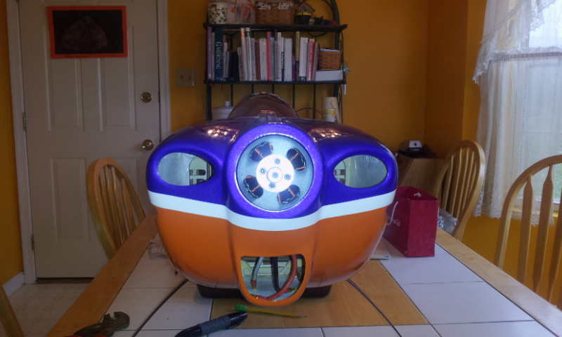

I mounted the E-Flite Power 160 tonight. The spinner and the cowl lined up perfectly. The DLE-30, which this plane was designed for, didn't line up correctly. The Sbach never flew right with the DLE-30. It always had issues with ballooning on landings. I suspect that something was out of alignment on that frame. Since everything lines up properly on this rebuild I'm optimistic that the ballooning problem will go away.

Next time you have the cowl off, could you post some pics of the motor installation/set-up? I've had this model for a couple of years, but its still in the box because I really do not want to hack it up to make my IC engine of choice fit.
I'm seriously thinking of trying e-power; this airplane would be a nice candidate, I think.

I used to have a DLE-30 mounted on this plane so I used the included standoffs. The standoffs are 2.36" long. The nylon spacers are each 1/2" and can be found at most hardware stores. I still needed to add about 1/16" to the standoffs to get clearance for the spinner backplate. I used the X-mount that came with the E-Flite Power 160 to make a template for drilling mounting holes in the firewall.
