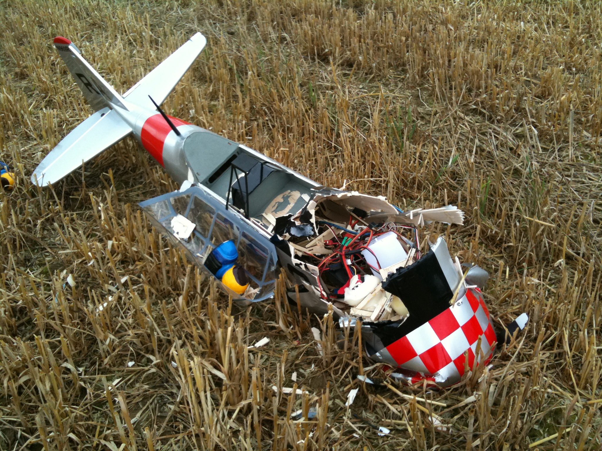

The latest update on the Texan. Over the last week I made some adjustments to the plane. I made a bracket that fitted ontop of the engine mount that allowed me to set the C of G and remove 12.7oz of lead. It bought the model into 10lb model.
I moved the C of G back by about 8mm as well. It was very nose heavy on its first flight. I had a very nice Stainless steel prop spinner turned at work. It looks good.
So today I took it out to the field for yet another test flight. Brian was there with me. I checked it all out, fueled it up, started the engine and carried it out to the strip.
First attempt at take off it nosed over. Re-start the engine and off we go again. She climbed out really really nice. Wheels up and off she went.
Smooth as silk. I was impressed with how she flies. Did some slow passes to see what she would do but she tracked perfectly.
Tried the flaps, she slowed down but still no problems. Very pleased with her indeed.
I then said to Brian "I reckon I should try a roll", Brian said "why not"
So I turned her into wind, opened the throttle a little more, a little right aileron and over she went, nice and smooth.
As she was inverted THE F**KING WINGS FELL OFF[/
I once again went home with a Black Horse AT-6 Texan peice of s**t in my car in a bin liner.
ARTF should be banned.
Ray

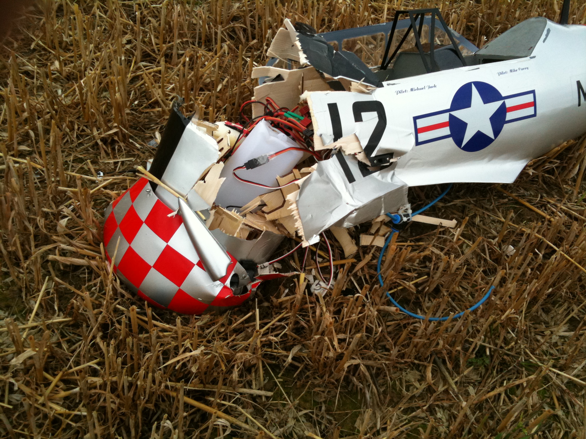

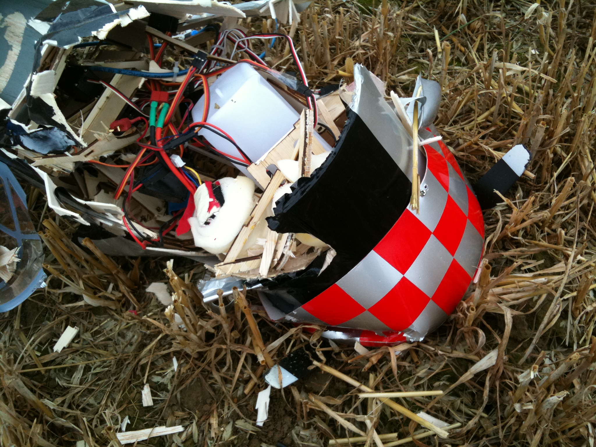

ORIGINAL: bingo field
OOOOHHHHHH Man.............. I hang my head in sympathy with you. ( I bet you have a favorite beer nearby...) I haven't had a chance to get mine airborne yet. Between work and chores....
I just couldn't believe what I was seeing. The wing floated down with very little damage. The fuslage just dropped like it had just been released from a bomb bay. It landed in the next field. What a mess.

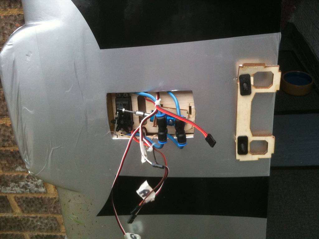

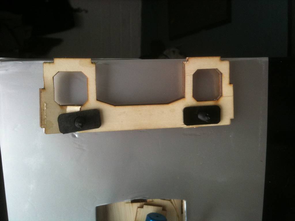

Do you have any idea why the wing came off? Did it pull off from the front, where it attaches to the fuse?
Old 08-15-2010 | 03:26 AM
  #47
Kostas1's Avatar
Joined: Dec 2005
Posts: 3,566
From: AthensAthens, GREECE
Default RE: BH AT-6 Texan Build
OMG.....i really feel sorry for you ...[][]
I am really curious to read an explanation of the wings-falling oof the airframe...
Bolts where tight enough ?
Stock bolts ?
A cracked area in the wing that resulted in full separation from the fuse ???
Old 08-15-2010 | 04:00 AM
  #48
Pennbrit's Avatar
Joined: Jul 2010
Posts: 44
From: Crawley, UNITED KINGDOM
ORIGINAL: Kostas1
Stock bolts ?
Not much to say really.
We all buy these ARTF models and hope they have been built properly.
It's not untill some thing goes wronge we question everything.
The wing bolts and the fixing plate are still at this moment attached to the wing.
The front dowel is missing. The is no evidence of any glue in the dowel hole and very little evidence of any glue on the wing bolt plate.
These factories churn out these models cheap. We all think we are getting a good deal but the people putting them together dont give a damn about how much glue they use.
Makes my blood boil.
Bring back builders kits. I would be more than happy to have one of these models as a box of laser cut wood and build it my self.
Ray.
