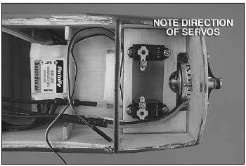

Default RE: Servo mounting isolation
On many electric planes the servos are mounted with no rubber isolation between the airframe and the servo. On electric planes it's usually not needed to have the servos isolated because there is little to no vibration from an electric motor.Infact, many ofthe major manufacturers will recommend directly mounting the servos to theairframe with no isolation. The attached picture is from the Electrifly SPAD XIII park flyer.As you can see in the picture, the servos are mounted directly to the wood of the airframe. I have this plane and have well over a hundred flights on it and have had zero servo problems.
If your plane is glow or gas powered then the rubber isolation mounts are absolutely necessary and leaving them out will result in servo failure. But if you have an electric you can usually get by without them.
Ken

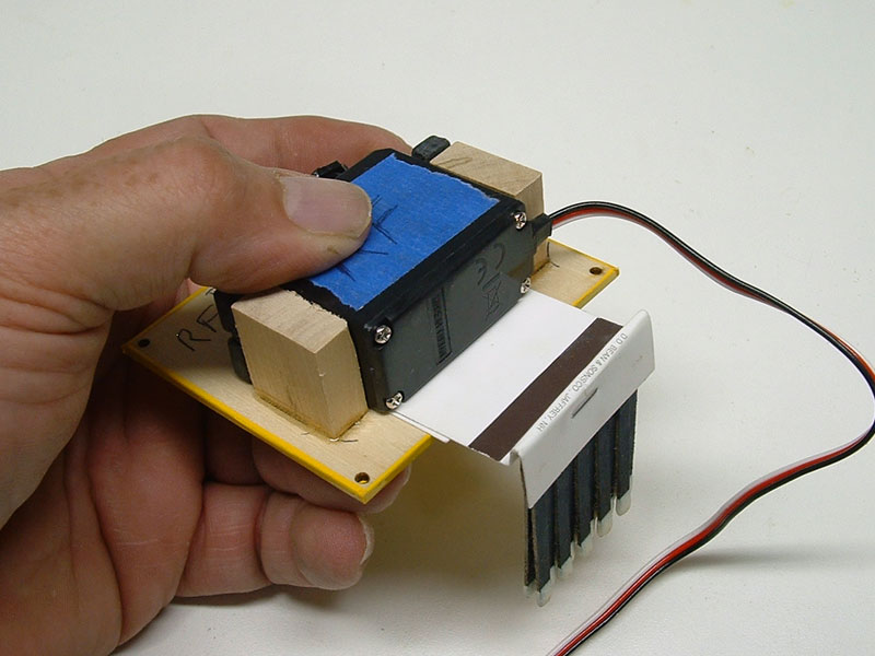

MinnFlyer's Avatar
Posts: 28,519
Received 9 Likes on 9 Posts
From: Willmar, MN
I usually place a folded matchbook cover between the servo and the hatch while mounting the servo screws to put a slight gap between the two

ORIGINAL: MinnFlyer
That's a great idea, thanks Minn.

IF it's a glow powered plane then you DEFINITELY need to have the rubber isolation mounts for your servos.
As Minn indicated, you need to make sure a servo is only touching where the rubber mounts on the mounting tabs are. I usually use a 1/16" piece of balsa for a spacer similar to what Minnflyer shows above.
Ken
