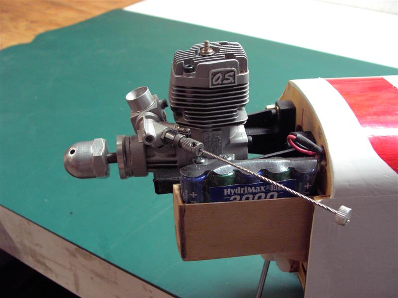

When ones chooses to add weight here is a simple safe way to get the weight (lead shot) all the way forward where it will do the most good without the disadvantages of hanging it on the crank shaft.
When one chooses to move things around here is a simple safe way to do the same with the battery which will do the most good.

ORIGINAL: JohnBuckner

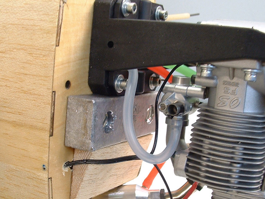

Obviously moving the weight the furthest in the direction needed will be the most effective. With that being said, it's often necessary to make and mold your own ballast.
Take some scrap balsa, and build a "cast." Be it in the shape of a square, rectangle, triangle...whatever you need. Make sure that it is water-tight, because you're going to pour molten lead into it.
Hit up your tackle box, or head to the bait shop for some split shot, or heavy sinkers, or whatevers most available and economical. Go into your pantry and eat a small can of corn, or beans...just make sure it comes out of a tin can..or whatever metal it is. The metal in this can will withstand the same heat that will cause lead to melt.
Clean the can. Squeeze/deform the can as to make a little "spout," resembling something that you see on a juice pitcher.
GO OUTSIDE.
Put your balsa mold on the ground, put the lead in the can, and take a blow torch and heat the lead until it becomes molten (This doesn't take very long)
Once it's all liquid, put the torch to the side, and using a channel locks, or something to hold the can, pour the lead into the mold.
ONCE AGAIN...Go outside for this! Obviously be careful with the torch and the molten lead.....but be more careful not to breathe any fumes, and wash your hands when your done. Always wash your hands when your finished handling lead.
GO OUTSIDE.

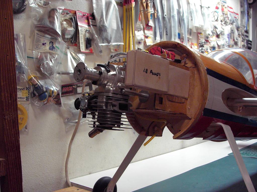

How about a scratch built Bipe. Any scale plane that had a round engine is going to require weight in the nose. In this case I had everything moved behind the fire wall I could move. I even have a sub-C 6 volt battery behind the fire wall. It took about 3 pounds of lead in the nose to get the correct CG. I used epoxy and lead shot and floated it inside the engine cowl/ring. This is NOT the way to do it with most planes, the cowl will crack and break off. I made this cowl and the way I set it up there was no problem. Some planes no mater what you do will require lead, in this case it was a lot of lead.
