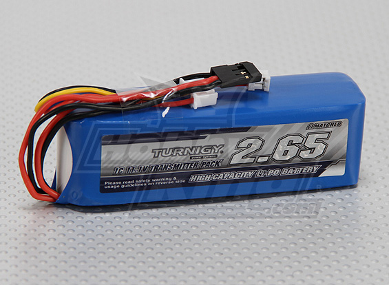

Those of you that are using lipo's in your dx7 how are you charging them?

With any Li-po battery in a transmitter you will need to remove the battery from the radio in order to charge it. With the battery out of the radio it's then charged just like any other Li-po battery.<div>

Ken. I can't seem to find a connector that will attach to the lipo battery. All I can find is the connector if I want to put one on a battery to plug into the tx.

Ken, I need the power tap (male) I have a turnigy 8150 charger that balances the pac as it is being charged. I just don't have the connector that will plug into the battery. The battery has a female plug on it. The tx has a male plug. I need the same thing as the one in the tx only where I can connect it to my charger/balancer. It would be like the connector that I have to charge my rx (futaba) ends. Only I want it to fit the JR small white plug that is attached to the end of the battery. This is probably clear as mud.

I don't know if this will work but HK as the battery that I have. You will see a futaba connector and a small white JR connector along with the balance connector. item # T2650.3S.1C

I guess I am having problems understanding. I have a charger that balances while the battery is charging. The balance plug is on the battery and that plugs into my charger. I needed the power tap coming from the charger to the battery. this is the charger that I have. You can see on the side of the charger where the balance taps insert. from 3cell to 8cell lipo. The second picture is the battery that I am trying to charge. notice the little white plug, that is what goes to the charger. The other white plug is the balance tap and then it has a futaba power tap on it.

You have an iMax B6 based charger that requires BOTH a balance connector and a main lead connector. ( BTW You can use an Equinox with that charger too ).
You should get the Hydra wire you indicated and plug the pack into the Futaba connector of the Hydra.
With the banana jacks plugged into the charger, plug the balance lead of the pack into the JST/XT balance board that came with your charger and charge in "balance" mode.
Many chargers permit you to charge via the balance board/lead alone, for lower battery voltages.
For higher voltages both sets of connectors are required, and the iMax B6 is a bit unusual in that it requires it always.
