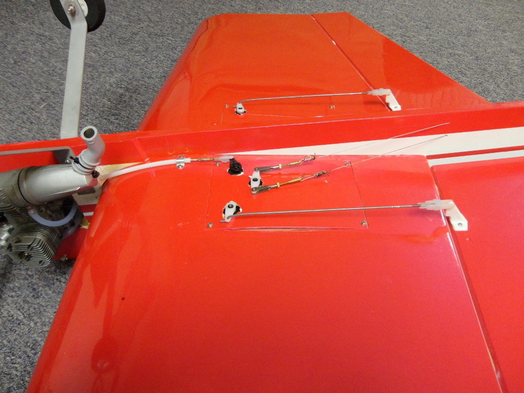

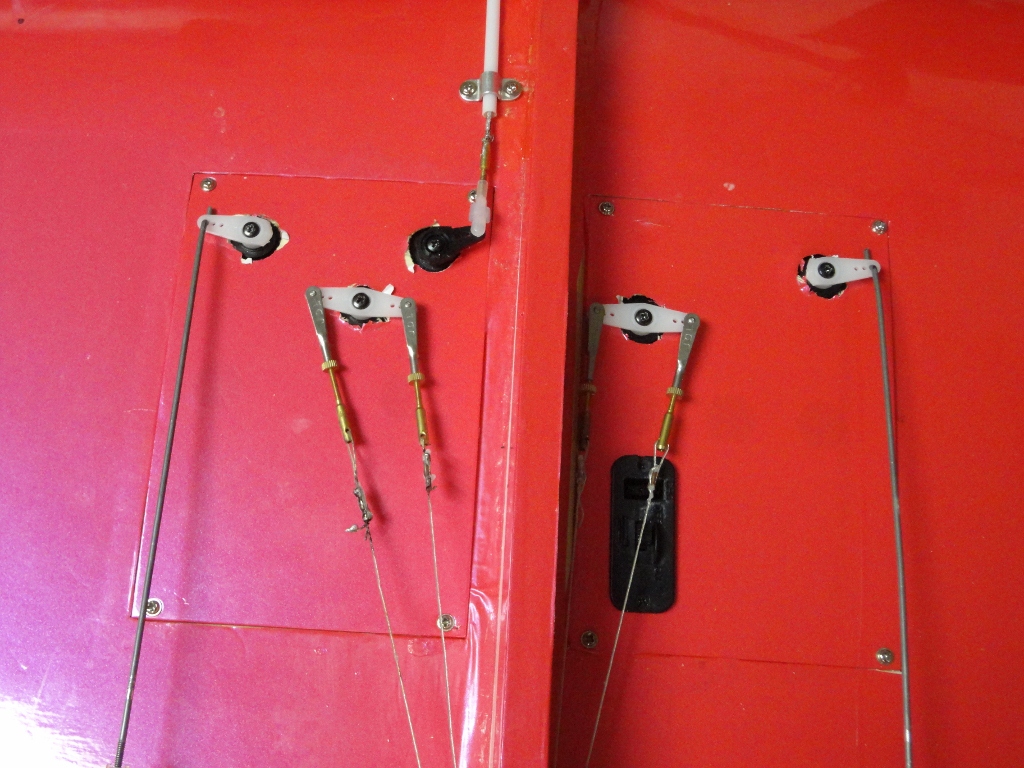

Done a number of pull-pulls, its a bit intimidating the first time, and it may take a couple tries to get it right. I prefer to start on the rudder end, getting the cables on the horn or coupler and crimped there first. One, make sure you have a plenty long piece of wire, too short and you'll be cussing.. Run the wire thru the crimp tube, then thru the horn or coupler.. bring it back around and back into the tube from the 'top', so you have both wires coming out the bottom. Then take the short end and loop it back thru the tube again. Holding the tube in one hand and long part of wire in other, pull the wire taunt and slide the tube down toward the horn until its about an inch or so from where the wire is looped thru the horn. (Or you may be using a turnbuckle type item attached to the horn, either way do same thing). When its where you want it, the wire in the crimp tube is nice and tight, crimp it nice and hard. Trim any excess. Do the next side. Run the cables to the servo.
At this point you want something on the servo arm such as Dubro threaded couplers so you can tighten the wire. Then I normally turn my radio on so the servo stays in neutral. Tape the rudder so it stays straight or have a friend hold it, and do the same procedure as with the rudder connections. Try to get it nice & tight before crimping, not heave-ho'ing on it, just good firm pressure. Once done.. start adjusting the couplers to tighten the wire. A little on side and then the other. When its complete, you should be able to pluck the wire and get a dull bass sound, akin to a guitar out of tune. Don't overtighten! Should be just enough to firmly hold the rudder in position without slop.
First time it took me maybe 3 tries to get it right. Nowadays its no big deal, well... can still be a bit of pain sometimes.. but its my preferred setup if I can make it fit the plane. Google pull-pull, lots o' good pics and such..

yep same as mine. I did see the pre drilled holes, but drilled my own and staggered them. Be sure to use more than just CA on the servo trays when mounting them. I'm using Hitec HS-485 HB's servo's for all but the throttle. They are ball bearing Karbonite gear with 66 oz of torque. I also added two washers under the forward two holes of the engine to give a tad of right thrust, not sure it really matters, but just thought a little right thrust would be a good thing. I placed a 1100 LiFe battery in between the the servos on the left wing. I didn't realize the the pull pull wires would be so close to the switch where I mounted it. It will be fine where it is, but had I realized it I would've mounted the switch more towards the outside of the wing instead of where I did. The instructions called for mounting the fuel tank in the wing as well, I decided to mount mine extrenal. I like the ease of being able to access everything with the profiles. Makes the engines easy to tune, and fix fuel lines, etc... I set my CG at 4.5 inches. The manual says 4.0 - 5.25! Will have to see how it flies and adjust as needed. The 55 AX should get this thing airborne in less than 10 feet!!
As Bosarth says in post 10, the control horn and servo horns DO NOT have to be the same length. The same force arrangements hold as for push rod set ups, you can change the amount of throw by moving the attach points at either end to get other than a 1 to 1 throw, just do make sure that the set up does not bind up at full throw.

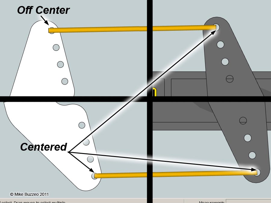

Actually, having the horns and the servo arms the same length is not necessary. It's good to keep them close - that is, not RADICALLY different, but being the same length is not really important.
Having "Positive Ackerman" - That is, having the linkage points behind the hinge line, means that the linkage on the outside of the curve will travel a shorter distance than the one on the inside.
This insures that the wire which is NOT the one that is being pulled will go slightly slack when the surface is moved.
You can see in the illustrations below that two rods of equal length do not stay centered on the holes when the surface is deflected.

The spread of the servo arm can be 1 foot, and the spread at the rudder horn can be an inch.
The only critical aspect in setting up a pull pull setup is that the attachment points at the horn be colinear with the hingeline and the attachment points at the servo be colinear with the pivot point of the servo..
If the relationships are maintained properly, only the slightest amount of tension on each cable is required.

SEE BOLD ABOVE Sorry but this is not the case. It is basic geometry. Aim to keep the servo arm lengths and control horn lengths the same + - 10%

Thanks Grosbeak
That is what I mean. They have to be about the same length. Ideally with horns on the hinge axis.
Re using bushed servos on pull pull. Yes ball raced ones are better but I have had a few really high airtime set ups using bushed servos and pull pull without noticing rapid wear.
The only limit to the ratio of servo arm length and horn length is that, at maximum servo throw, you do not jam the moving surface by having the servo arm excessively greater length than the control horn. There is no limit in how much longer the control horn can be than the servo horn other than you may reach the point where the surface does not move enough to give you adequate control.
