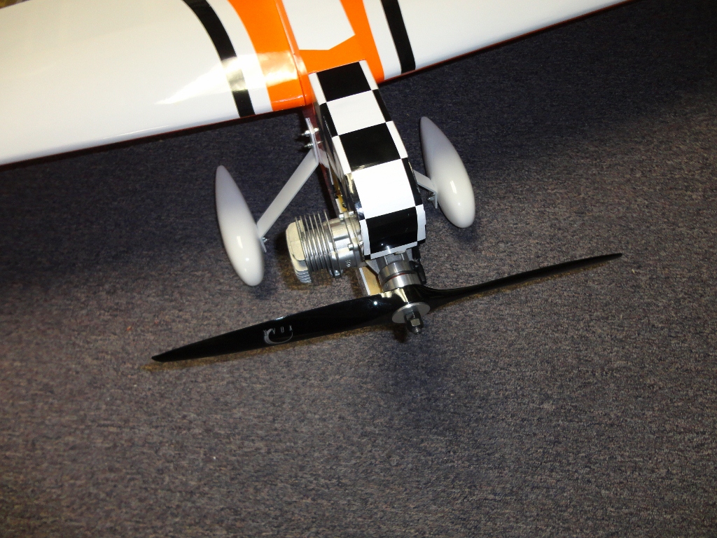

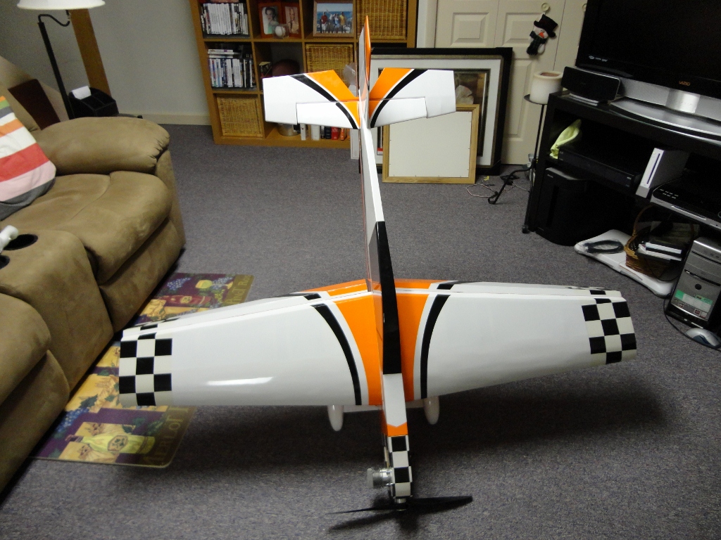

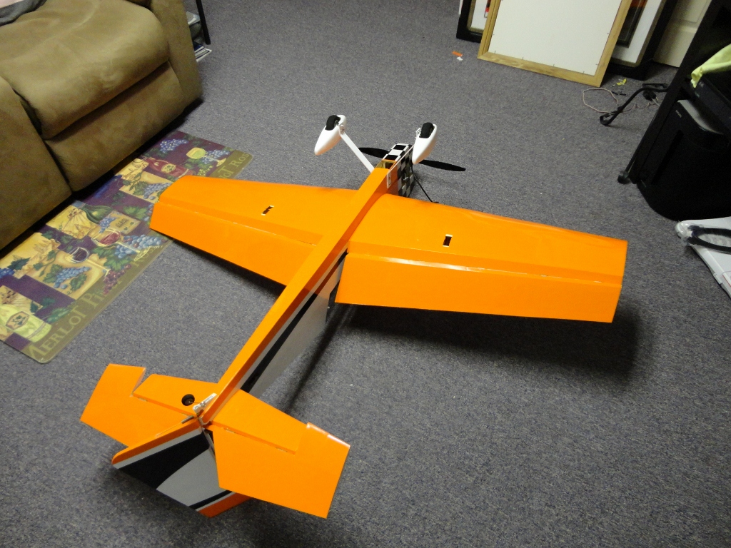

Almost together. just fuel tank and servos, went together easy, no issues. Manual was terrible. DLE 20 looks good on it and will sound even better!
its an awesome little plane..... but the covering is terrible..... everyone i know that has one will attest to that
i bought mine when it was advertised as using Ultracote..... other than the covering its indestructible..... i did a full throttle dive into a blender on several occasion and it passed the test....something i would usually never attempt in a
i also did some Dave Brown checkers on the bottom to make it looked distinguished. http://www.flickr.com/photos/31850530@N08/5610785442/

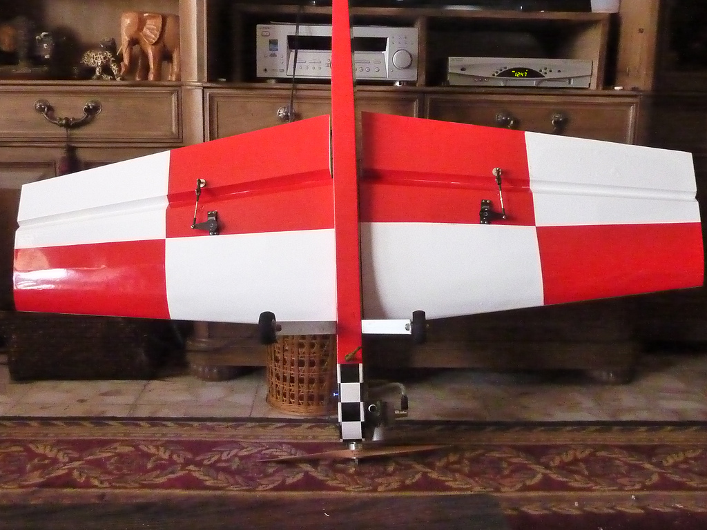

yes definitely use thin CA on all the joints, some were pretty weak... i also added a little bracing and a place to strap one of the batteries ...i also cut the floor board out to mount the ignition under the front of the tank.
The plane is pretty much indestructible now.... i did a couple of full throttle dives into full left aileron into a violent blender and it held up
one thing you might need issome bigger aileron horns to compensate for the huge double bevels the ailerons have.... maybe they revised the kit and added the correct size, mine any my brothers ARFs came with the wrong ail. HW
see pic

Thanks, the horns that you show in the pic look like the ones that came with mine. I cut a opening, just behind the fire wall on the bottom of the fuse (making a hatch cover out of ply for access) for the ignition wire. I was thinking that the supports all lok a tad weak.. so will CA the crap out of it. What CG did you end up with? 6 inches? Can't wait to fly it. What servos did you end up using? I'm using Spektrum A-6020 for rudder and elevator and HITEC HS-5485HB for the ailerons. Did you add longer control arms on the servos? Sorry for all the ????s, but want this one right for the maiden.

Closer to maiden. Everything is installed but the throttle servo. I have a standard servo. But think a micro servo for the throttle would be better. Could mount it closer to the engine. Will figure something out. PA mx extra is almost ready too. Just need to solder connections on the ESC and hook up the control surface rods. Maidened the Morris hobby profile today. Two perfect flights!!!!
ORIGINAL: billd76
if you go mini...make sure its metal gear and that it doesnt not bind
the servo has 4-40 all thread through a tube to prevent friction.... sorry it ttook so long to upload pics
