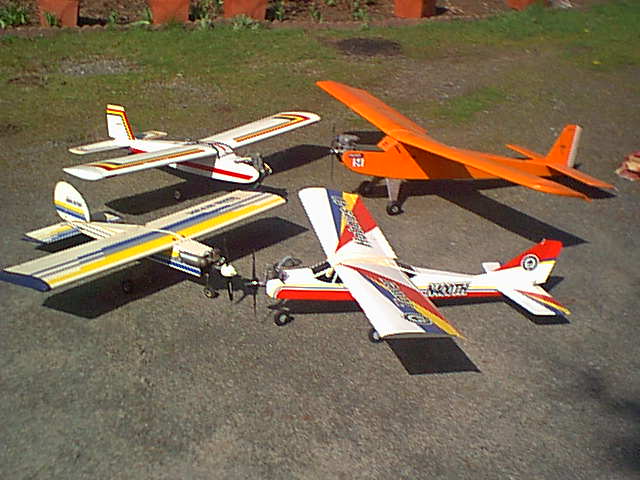

(the old saying...."different strokes for different folks" ) A few of my planes-got a bunchlol
