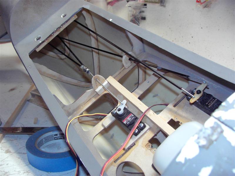

What I use these days for all the ships that utilize the 2/56 rod ends for the pushrods (and thats most right up to the ninety sized stuff) is Carbon Fibre rod and at the control surface there will be a threaded rod end inserted to the rod with a clevis (this allows adjustment without disassembly of the wing) at the other end will be a short (several inchs0 of 2/56 rod end without threads but a formes Z bend. My rods never have any bend at all in the rod ends I keep the pushrods dead straight. The outlet holes in fuselages are position by me to allow this not neccessarily where some kit or arf possitioned the outlets.
Pushrods with bends in the wire ends no matter what will cause the wet noodle pushrod syndrome. Now I do not use carbon fibre rods from the normal suppliers for my 2/56 rod ends Instead I use the difficult to find rod that is a perfect slip fit for the 2/56 rod end wire. It comes from Darrol Cady (this is searchable to find them) a cottage industry supplier to the pylon racing industry.
These wires are increditably easy to do even over the larger carbon rods or conventional pushrods. At the wire end at the servo (these wire ends are keept short) the Z bend is bent in before assembly wire has several inchs of radial notchs cut in the wire and this provides pockets perfect for the epoxy when it is slipped in the CF rod. But not glued now. Next the the wire end with the clevis threads is notched the same and this end is glued. now the entire rod is inserted into possition and the clevis is installed on the control surface at mid thread. Up front at the servo the the wire end is inserted into the CF rod and wiht radio on at neutral and the servo arm cross ways or wherever you want it the control is held neutral and a sharpie mark is made on the wire at the end of the CF rod. This wire in that section already has the radial notchs and the carbon is slipped off, epoxi is applied reinserted and the control set neutral. Bingo when set you have a perfect length and adjusted stiff pushrod.
This set up can be done much faster than most other types for fuselage rods and far stiffer as well as very easy to do. Not so easy to describe in print. I introduced my LHS to this method and connected him with Darrol Cady so he can supply the rods and now the vast majority are using this system here locally and not just pylon racers actually who are benefiting the most are the fellow with trainers.
Now as I suggested in other threads to the OP for now stick to the plans on your Kadet and use a Z bend up front and there is no need to solder. Later if you like with subsiquient airplanes do consider the Cf rods as I have described if you like.

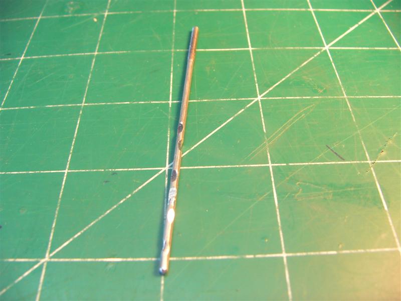

This is a picture of a threaded rod ready to glue into the CF rod. The radial notchs are cut in just seconds by holding aginst the corner of a stone in a bench grinder and rotating as you go. This short (just a few inchs) wire will either have the 2.56 threads or a premade Z bend.

I don’t use 2/56 for anything. Solid carbon fibre rod of the same diameter is stiffer, stronger and lighter so if I have need of small lightweight control rod carbon is my go to.
I use 4/40 and up depending on size and force needed. Again the bulk of the control rod for anything over 10/12 inch’s is carbon fibre tube that just fits over the end pieces of 4/40 rod. I try and keep the 4/40 rod as short as possible. The 4/40 rod I like are the packages of threaded double ended rod in various lengths. For the adjusting end I pick the length of rod that allows one threaded end to slide inside the carbon rod and the other end out for the clevis of your choice. Rather than grind or try and form notches in the end you are epoxying inside the carbon rod the other threaded end will do a much better job at creating a solid anchor.
For the other end that I am going to solder the clevis I cut one of the longer double enders or use a single threaded end rod and insert the threaded part with epoxy inside the carbon rod. I leave the unthreaded end a little long to be fitted at assembly.
If you use actual 4/40 rod for this you will find the clevis will have to be turned on to the rod and should hold its position during soldering. Position the clevis on the threaded rod so there is enough exposed thread inside and outside the clevis to allow for adjustment both directions and attach to one end of the connection preferably where you need/want to do any adjustments.
Servo arm is centered and a locking nut is in place on the pushrod behind the clevis. I lock the control surface centered by using a bit of balsa strip top and bottom and held in place with two close pins or light weight spring clamps.
You can attach or push the clevis pin into the control horn and lift the rod to align with the clevis, mark and cut to length. A clevis such as the Sullivan should have 1/8 of the steel pushrod exposed inside the clevis. Because the clevis is so snug a fit on the 4/40 rod any solder on this exposed part will not allow the rod no mater what to pull through even if your solder joint should fail.
Sand/clean the rod and use a little acid flux on both the rod and clevis then wind into place checking for length by again aligning the clevis pin with the hole in the control horn. When you have it right just let the whole thing hang free and apply a bit more acid flux and solder in place. Any slight misalignment that occurs is easily adjusted at the other end.
