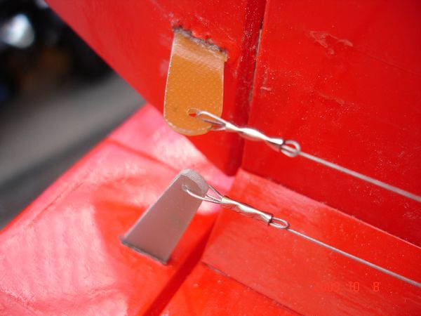

Setting up a pull pull rudder on a small electric Yak. AUW will be about 2lbs.
There is no turnbuckle supplied like on my bigger glow pull pull system. Looks like you just pull tight when crimping the ferrel?
Tried it and the crimp doesn't hold... Very light weight wire...
No luck searching for options?
Seems like you would need some adjustment even on such a lightweight setup?
Anyone know of a lightweight pull pull setup that's available ?
Steve

Have you looped the line back through the ferrel
Old 11-07-2012 | 03:33 AM
Joined: Jan 2010
Posts: 978
From: glasgow, UNITED KINGDOM
Default RE: Pull pull setup ?
Are they any help to you. Sorry about the large pictures.
Cheers
john</p>

On the 2nd picture, take the tail and loop it back through the ferrel before you crimp it. You will then have 3 strands of cable going through the ferrel. I have never had one slip using this method. just my 2c
sorry for the poor picture but I think you can see what I mean
Yeah, i agree. You could even go one further and keep passing it through, 'bulking up' so to speak before final crimping. I have to say though, i would like some adjustment on one end, even with the small weight penalty.

On such a small model, you can use monofiliment fishing line with no problems. I do that all the time and never have a temperature or stretching problem, even on some models weighing up to 4 pounds. Using monofiliment you can just tie a knot and put some CA on it which is much easier than a crimp. Yes, use the clevis and adjustments shown in the picture above, they work great. The main thing with pull-pull be sure to have a little positive Ackerman in the setup as it will make the control much nicer and be easy on the servos and hinges. Do not over tighten the lines, just taunt enough to not have any slack at neutral position.

I have also used fishing tackle swivels and clips on some set-ups. They may look a bit out of place but are cheap and work fine.

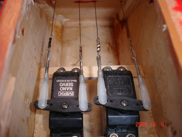

You tread it in the ferrel once...then true it in again ...and then a third time. No dangling loop outside the ferrel!

The gizmo's John is showing are called rigging couplers and DuBro makes and sells them. I make up my own systems but I go to the sporting goods store and buy braided stainless steel plastic coated fishing leader. It comes in a lot of sizes. You can loop this line and use a match to melt the plastic onto itself and not even need the Ferrel to crimp. On a simple loop and Ferrel I crimp the Ferrel then use a heat source, usually a soldering iron and just heat the Ferrel until the plastic coating melts onto itself. Just running the line through the Ferrel as Gene mentioned with an extra loop then crimping will keep the line from slipping. When I was at Bass Pro a few weeks ago buying more leader I found some really fine light weight wire that is perfect for small electrics. I didn't buy any though, I had tunnel vision while I was looking for the wire for the planes I was setting up. My bad, now I could use some.

Not enough wire supplied to loop through again.. in this case... But I guess my question is what is the adjustment hardware called as I have not found it in a search.
I like the idea of fishing line... I have some 40 pound line at home..... I need the threaded rod with the hole in the end that the line goes through.
thanks
Steve

Jaka, I just looked at your photo. I do have enough line to do that...
But still want to be able to adjust it after its locked in...
Steve

Rigging Couplers and/or  Turnbuckles

Rigging couplers have the hole through one end, you use a nut on them and then tighten them into a clevis, when tight just tighten up the nut onto the clevis so it doesn't come loose. Turn Buckles are fantastic to use on the wire rigging of Bipes. Both work great but the rigging coupler is a lighter system . The come in both 2-56 and 4-40.

I use thinnest possible 17 lbs wire on my 50cc gas airplane (side rudder)!
All adjustments are done inside the fuselage.
The adjusters are just 2mm steel rods hammered flat at one end and then drilled with 0,75-1,0mm drill bit.

great info! I wouldnt have thought of making my own by hammering a threaded rod flat and drilling a hole... I need to polish the hole a bit but it should work?
add a nut and thread into a cleavis
thanks
I ruined both ferrels on my previous attept.. fuel tubing I have is to big... any other options? so close...

Plus kevlar doesn't need any extra looping through a ferule. I simply expose the kevlar, hold it against itself and drip 1 drop of thin ca. Once it kicks, you're done
I still have a stash I made using teflon coating...terrific stuff
To JaKa, very nice and tidy installation...I suggest that you use a short piece of heat shrink on the ferule next time for a pro look
