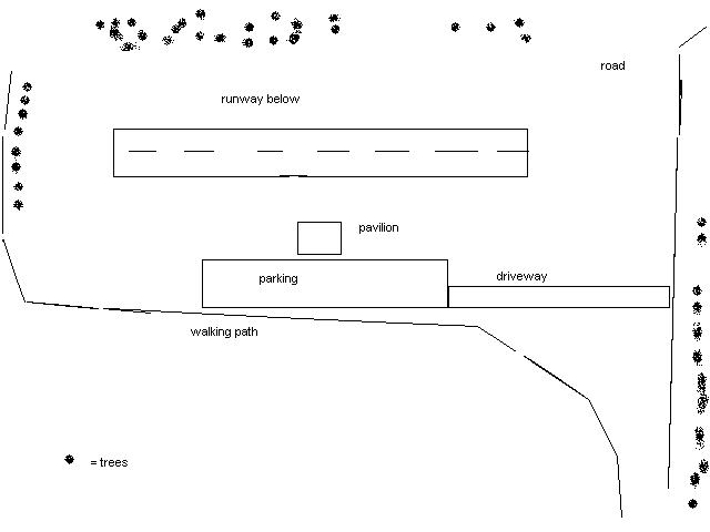

Hey I checked out a new airfield today. Pretty , plain. Few picknic tables setup...but the runway goes long ways from the pits...strange. And it is on top of a hill (mountain) and eheh...curves. I sure not all the landings are pretty because of this. But currently it is as wide as my current runway is long! Sooo I bet I could find a spot there. It is also void of ANY foot traffic. YOu have to get a key to the gate to get up there. Another nice thing. I'm hoping when I inquire however, it isn't an anal retentive airfield where they will complain if I bring my family up to watch or hang out. I live near one of those now. Everyone flies the same sport plane. Everyone does nothing but figure 8s. Every engine starts in 2 flicks. And everyone stands in the same 3 spots when flying. BORING. They are rude to spectators (but in their defense they get alot), and I've never met what I would consider ONE normal person up there. Looks like a star trek convention which mingled far to long with a 'how to be odd and insane' convention.

Heh - worst runway I ever used was in Thomaston, CT. It gets used a lot and isn't impossible, but you have to know the field. Trees on two sides (one end and across from the pits) BIG rocks on the pits-side before the plane gets there and a hump in the middle. The hump is exasctly perfect for when you're doing a full-stall 3 pointer and, just as the plane stalls (and you're brushing the grass with your wheels) the field drops away *sigh*
