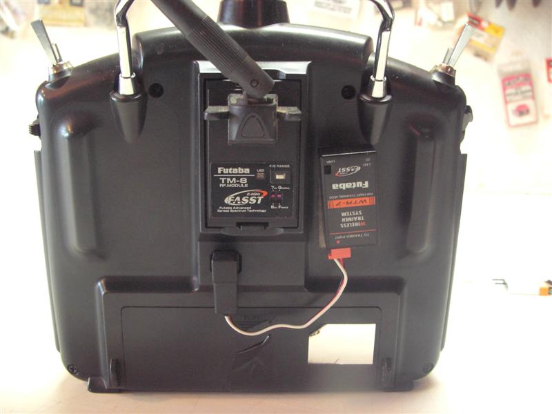

Hugger now not completely sure but with the Futaba system the trainer box must be 2.4 (fast) and since it broadcast to the 2.4 little bitty 2.4 receiver that dangles out the buddy cord plug on the back of the master and that info procedes to the master via the buddy plug, I do suspect that the master may be able to function on 72 from there to the airplane. Agine this is just speculation but I'd bet the limiting factor of which futaba you could use as the master is only the version with the square trainer plug.
If anyone knows any further info on the futaba please let us know.

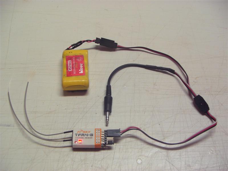

Back with news on the Futaba 6EX. The system for the Hitecs is working perfectly since I started this and have found that the need for charging that 270mah Nicd to power the system has been charging it about every four days assuming four or five training flights each day. This of course is neccessary for the Hitecs.
Now I mentioned I obtained a new 6EX for cheap with the intention of making up an inexpensive unit for it so I will be able to take on some Futaba students although I prefer the Hitec for myself.
Anyway what I used is a FrSky TFR4/TFR4-B Receiver and a FrSky WTC-1 wireless trainer cable. Total cost of these two were about 35 bucks cannot give the exact amount since someone else purchased the stuff for me, also the fellow who helped figure this stuff out.
This was much simpler than the Hitecs since There is no need to power the Rx with a battery and it is powered as well as works just like the Futaba product.
The wireless cable is plugged into the Rx and this cable plugs in the standard Futaba trainer jack. This rx is bound to the buddy box and this tx becomes the master just like the Futaba system.
I have not used this one at the field yet but hope to friday. It works just like the Futaba unit in the shop. Here are some pictures and also some pictures of the my friends Futaba system plugged to a 9C.

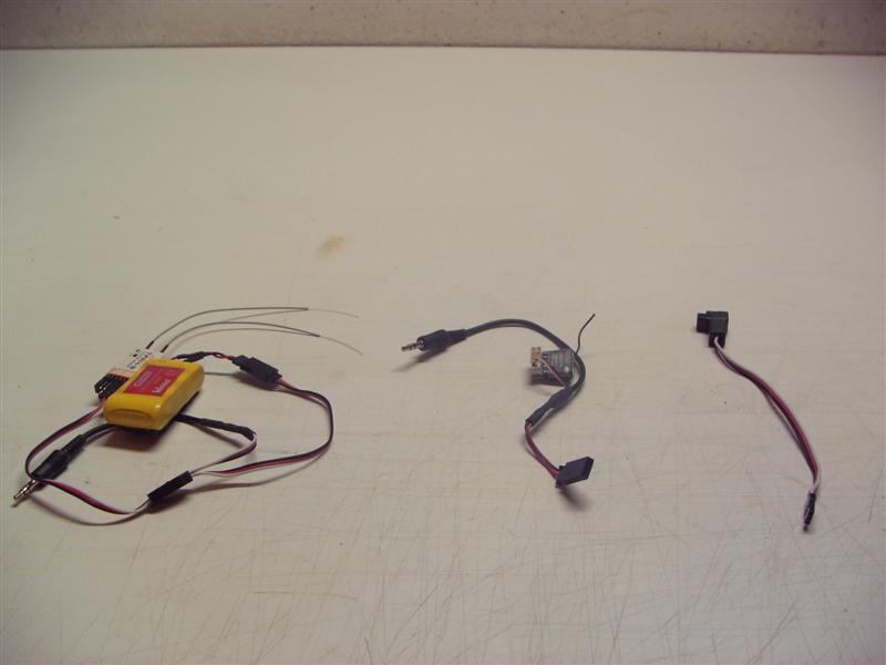

Now for the last combination experiment although with the two cords and Rx's above I have everything I need to take on both Hitec and futaba students and untilize the advantages of the wireless buddy, I did set up yet another cord (a total of three cords) that using the external battery, the FrSky Rx that allows Hitec to be used as the master and the Futaba 6EX to be used as the buddy box. This is a combination that I am not likely to use but I did test this and it also worked well.
The last picture shows the three cords and the two rx's that I ended up with:
John
The Futaba to Futaba system cost about 35 bucks and it works just as well as the Futaba system.
