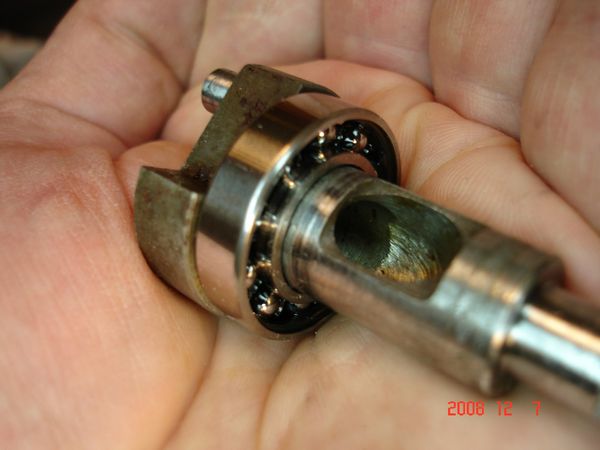

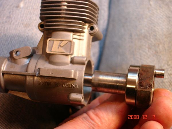

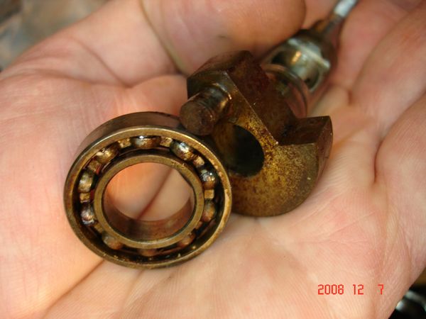

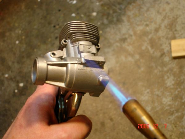

Default RE: Can i save a rusted nitro motor?
Hi!
As has been said earlier our glow engines are made of aluminium and thus doesn´t rust. The only thing inside the engine that can rust and often do so, is the bearings, crank and piston pin. Of these three the bearings is often the culprit. The carb barrel is made of steel too but it's not likely to rust, especially after just a few days outside.
What does make a engine freese up is old congeled Castor oil, and this is easily fixed by heating the engine with either a propane tortch or a heat gun.
But...in my opinion, take the engine apart and clean it! If you cannot turn the crank over the ball bearings certainly needs a looking over and probably need to be changed.

I would remove all rubber o-rings before taking a torch to it.
Old 06-25-2013 | 01:33 PM
Posts: 7,769
Received 6 Likes on 5 Posts
From: FL
In most of the cases I've seen, just using a heat gun like you use for shrinking covering will get the carb hot enough to let it start moving. I've never had any luck trying to soak one free no matter what fluid you use.
