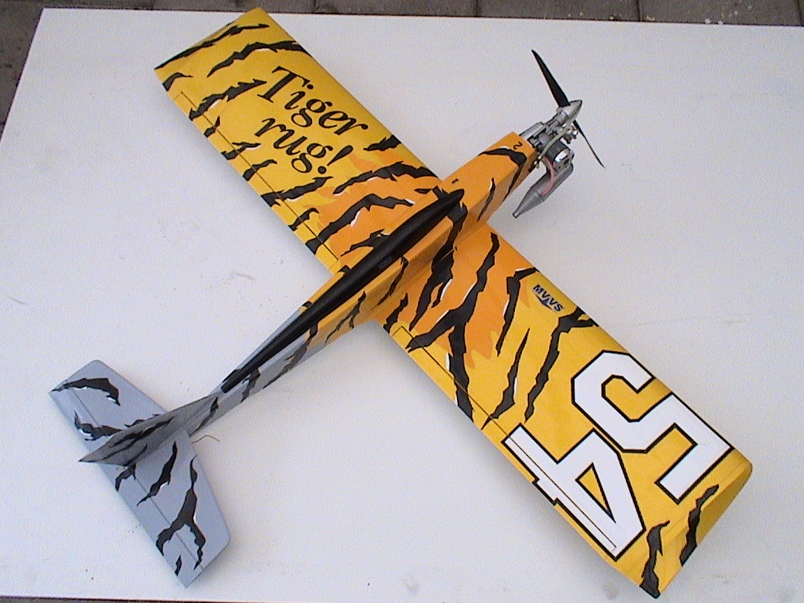

On a .40-.46 glow plane you can learn the basics of aerobatics ,and that's what you must learn if you want to fly a warbird safely. I assume when you say "Warbird" you mean a fuel powered one,either glow or gas, 160-200cm in span and not those small Parkfly electric toy planes?.
A good start when you have learned the basics of flying and want to learn more is to get a Q-500 type of airplane like the one below.
It's sturdy! Flys as on rails (if you can fly that is), does basic manouvers well like rolls, inverted flight, stall turns , knife edge, rolling circles and is easy to land, and is fast (around 180-250km/h with a sport/racing .40 with a 10x6/8,8x8,5 prop). Learing to fly fast airplanes is vital if you want to keep your warbirds for any lenght of time.
