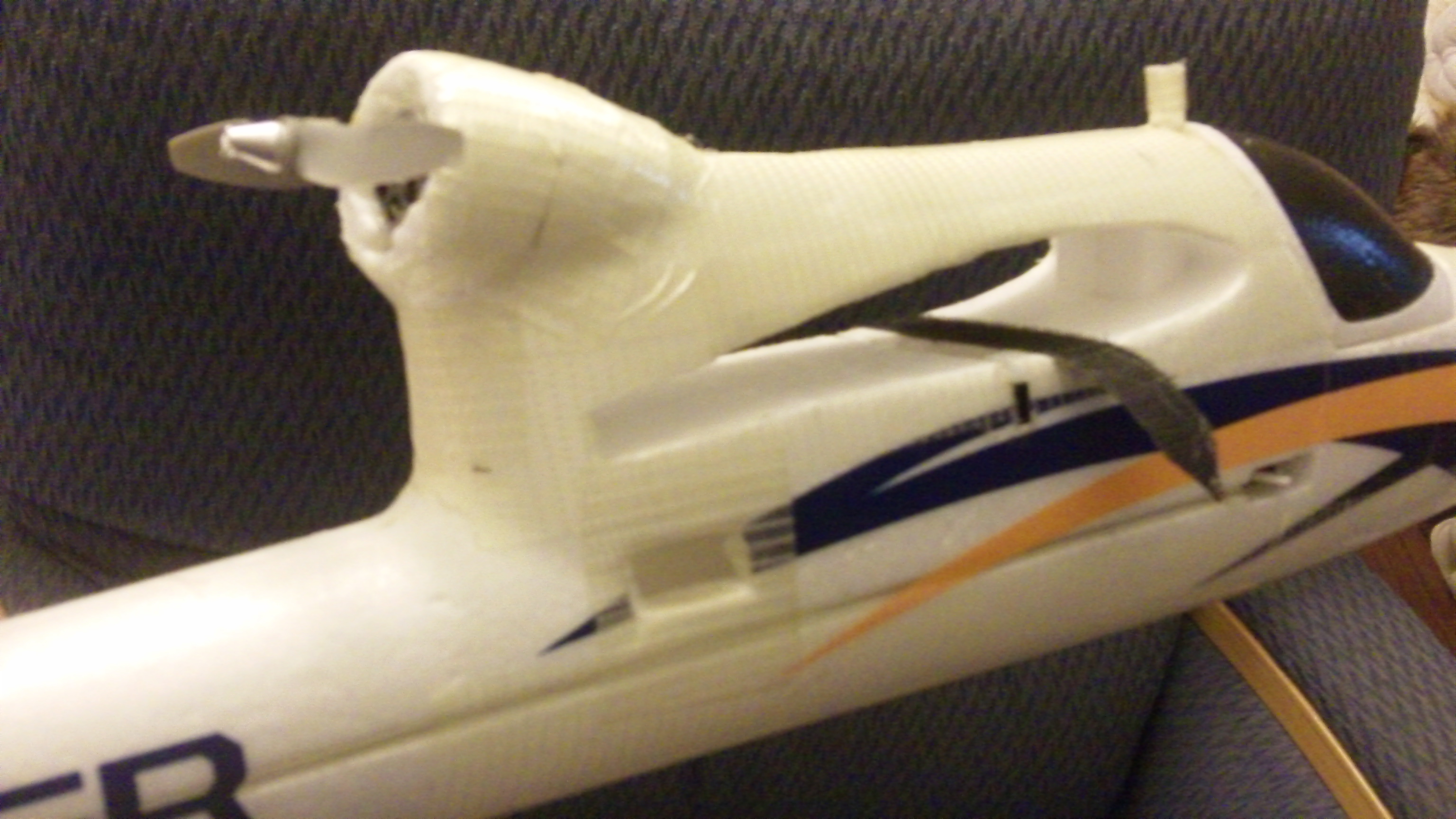

You only need to read the first three or four postings, those are maintained by the creator of the post, he takes only the important comments from the thread and brings it to the front 3 postings.
I did one or two more mods that are not poste there just because I knew I was going to push the Bixler hard also wanted to make it easy to assemble, at the same time it is small enough to keep it assembled.

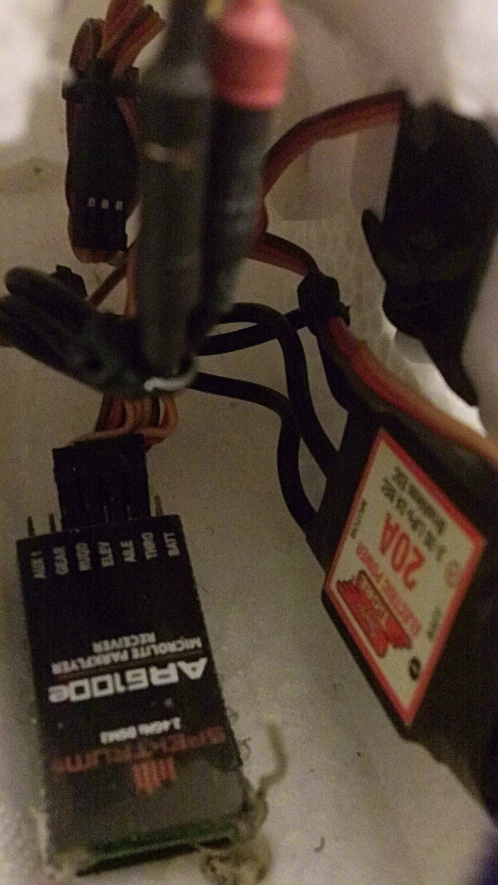

I have a Spectrum DX6i flying mine, the software should be almost the same, I use dual rates and I have a mix AIL/RUDD that I can turn on and off with a switch for coordinate turns and rolls, I highly recommend the APC prop as the original one is just a toy also a small drop of blue locktight on the two screws holding the motor to the motor mount ( I can show that with a picture ).
If you like to see my mods I can take pictures to show, also I could give you the specs on my set up if you need it, let me know.

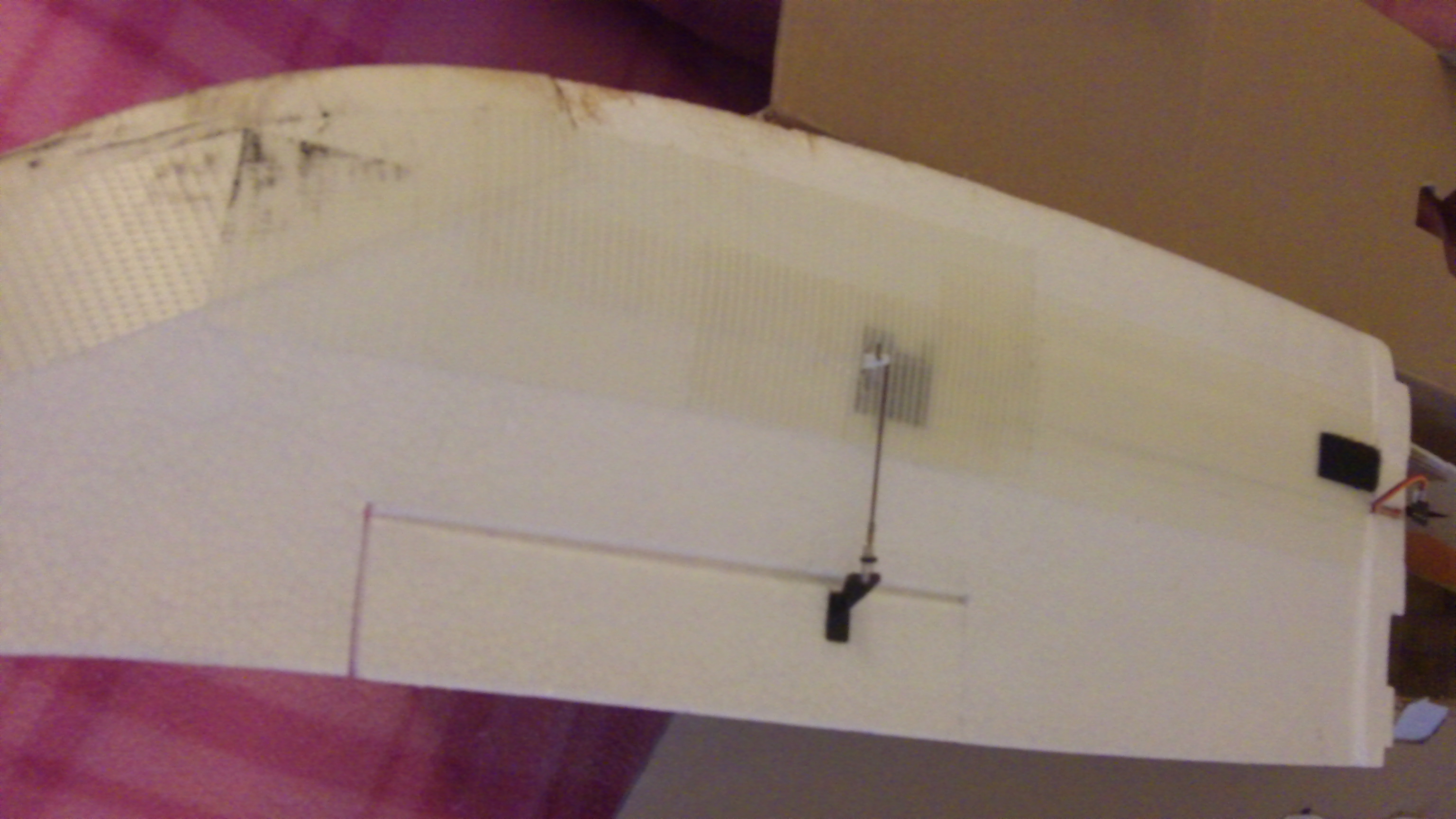

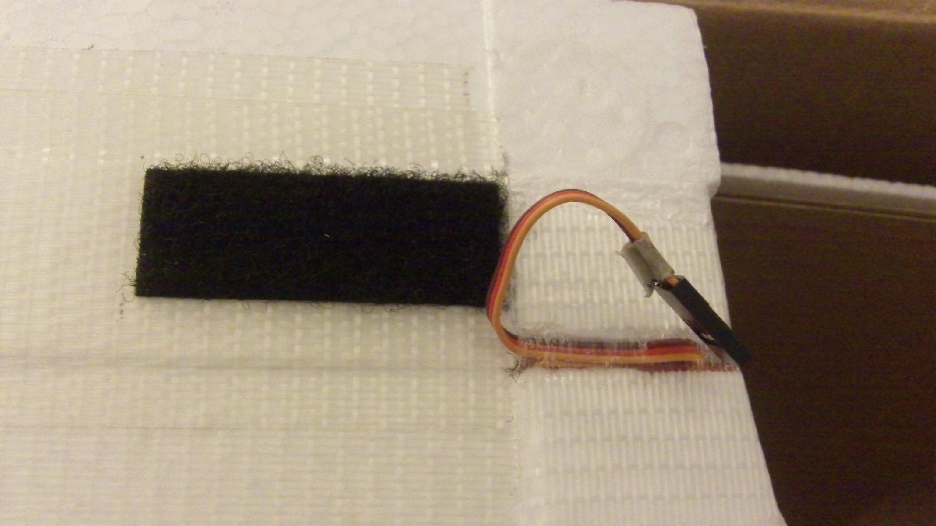

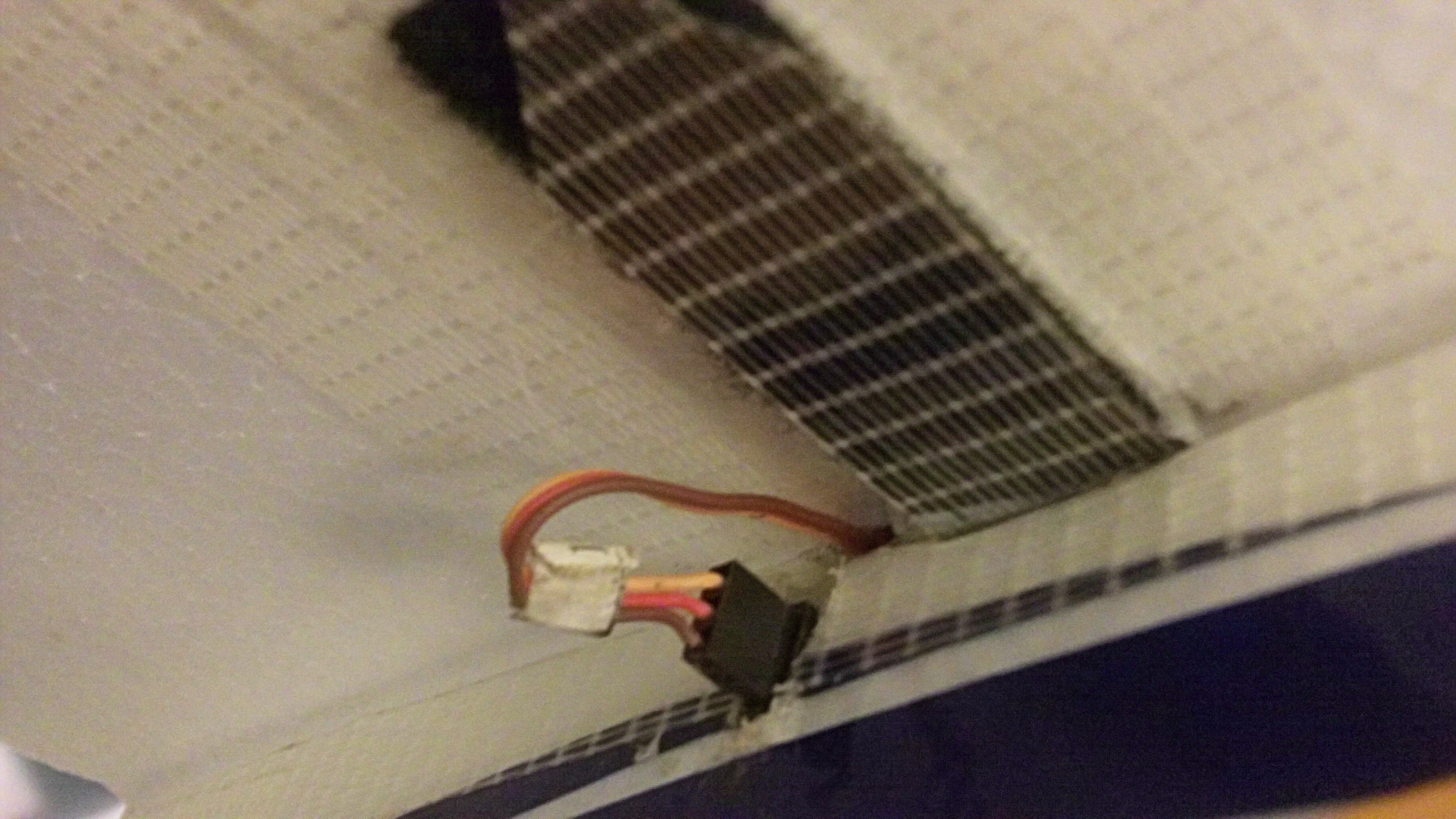

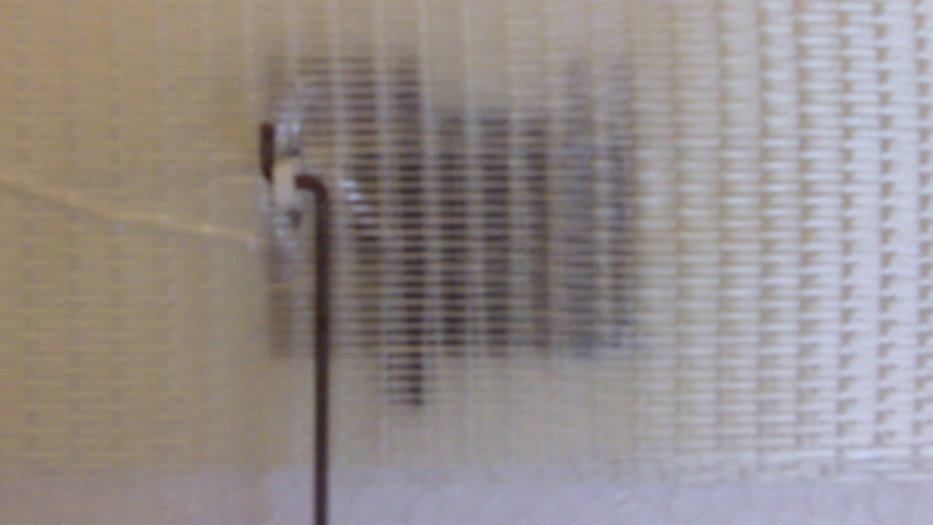

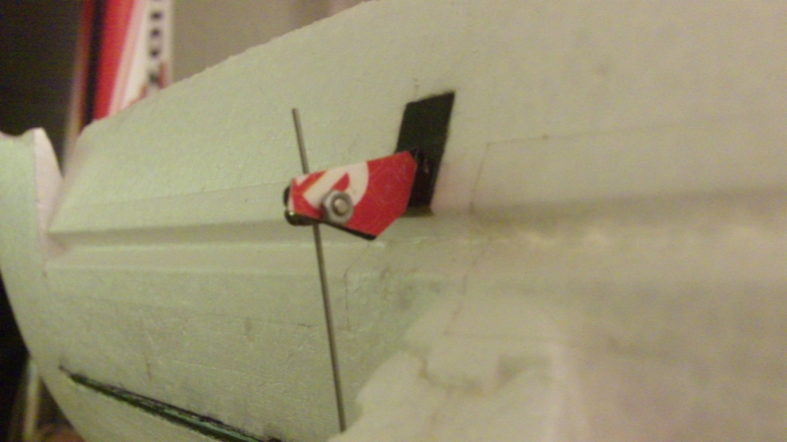

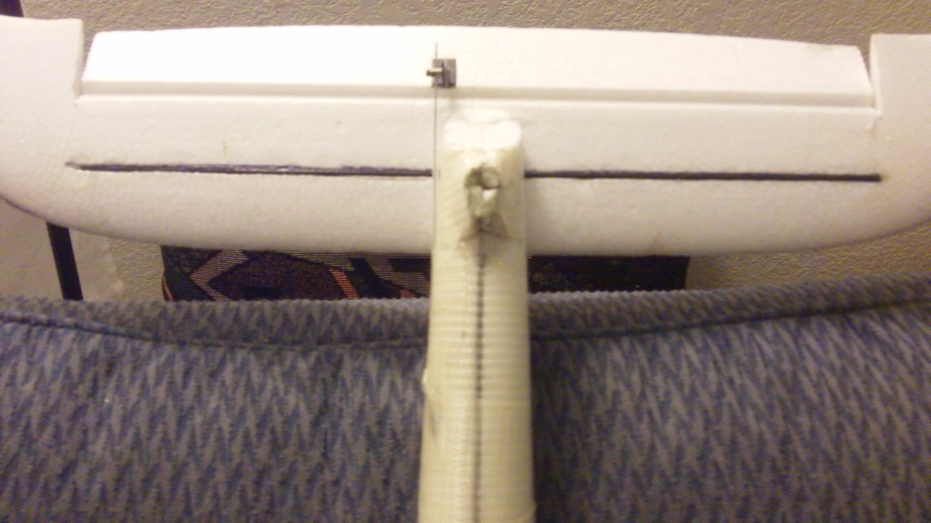

One of the modes done to the wing was to doble the Aileron horn with plastic to be able to have a much smaller hole for the clevis.
The only part change here was the Aileron push rod, I added a mini Durbro one.
The fuse is in the storage unit, I will get to it later and will take more pics ( sorry, I recently moved and my place is a mess, just ask my wife, anyways most of our stuff is her stuff ( figures )

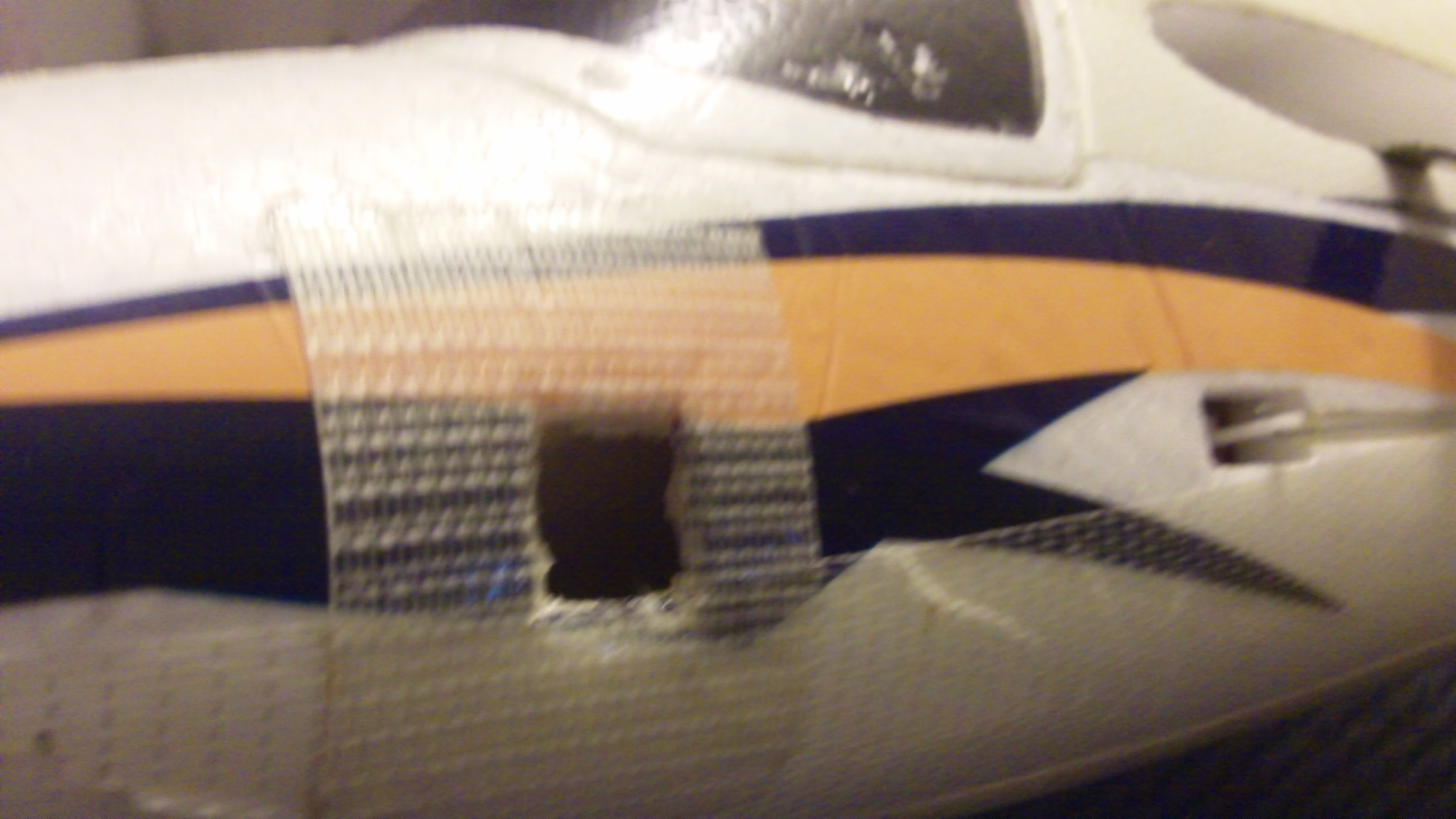

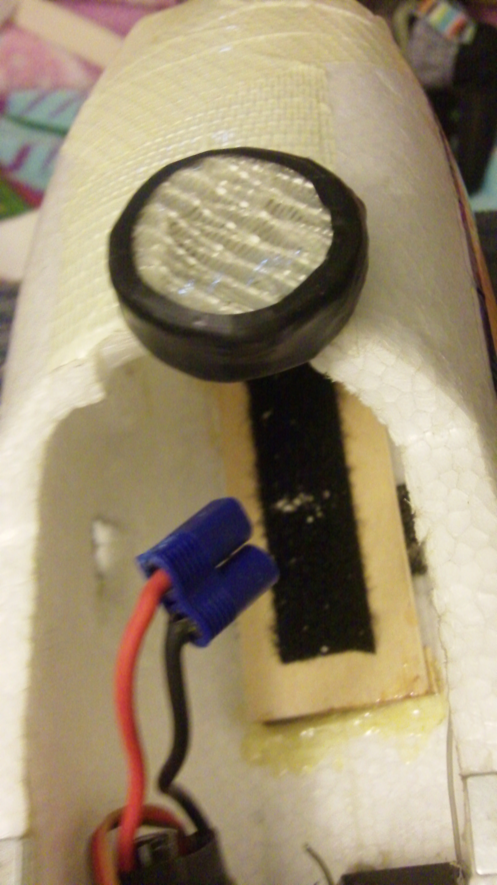

You're welcome, I also suggest to double the elevator horn

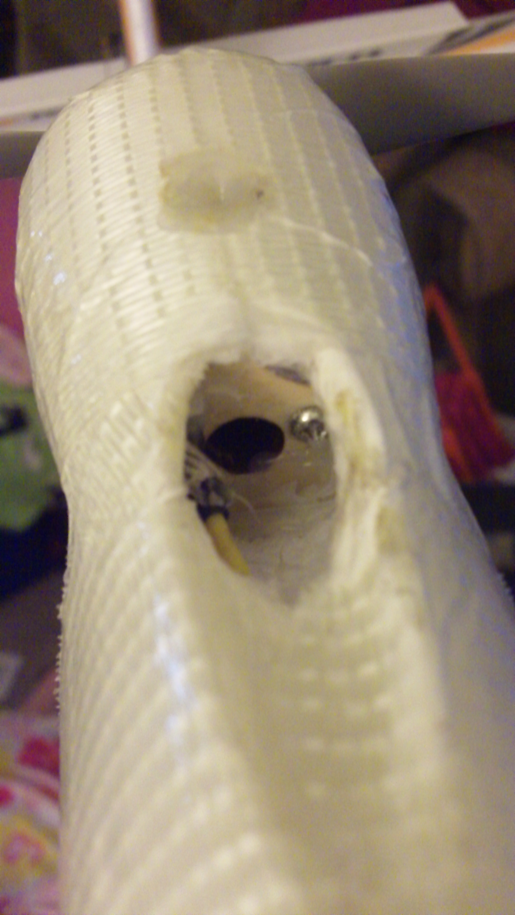

On this one you can see that I opened a hole on the front side of the fuse for ventilation this air goes right by the speed controller and it comes out on the back via another hole, both cut at an angle.
