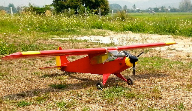

Does everyone believe that I would be able to get away with a .40-.50 size engine like the ones shown here?

No no and no not everyone!
It It is not the displacement (size) for your sixty size trainer that I have an issue with but your choice in the cheapest and likely most problematic engines avalible and you can be assured if any problems are likely it will be with these engines. Think about it zero quality control and no parts avilibilty Oh sure they may say they have parts but just try and see what happens.

In ABC sport engines ,you buy OS (and Saito 4 strokes) when you don't want to have to worry about them working right. I'd put Fox into that category too, although they aren't as popular as they once were. You buy Thunder Tiger because they are cheaper and almost as trouble free (that multi piece needle valve design can leak sometimes but is easy to fix). You buy ASP, Magnum, and a few other designs because they are cheaper still and usually work. Fandom of the various brands comes from what your values are. If you like cheap things and don't mind having to put a lot of time into one occasionally to get it to work, then you'll talk up the cheaper engines. If you're a fan of horsepower and reliability and don't care much about the price, then you'll talk up OS and a couple of others.
#56
I'd still go with the OS Max 46 AX. It's $149.99 on the Tower Hobbies website and you can get a $20 off coupon. That would make it $129.99 which isn't too bad for this quality of engine.
Whatever brand you get in the end, don't go with a 60 size engine on this airplane. It will make it quite a bit heavier and it will be grossly over-powered. I have the same size trainer as this one with the 46AX and when training someone, I have to have it throttled back to about 40% throttle so it will fly slow enough for a beginner. At full throttle it will keep up with most all of the other faster airplanes. I don't even like to fly it at full power as you have to turn so often to stay in the pattern.
In the right hands the cheap engines probably run great, but for a beginner, they are not worth the trouble. I had the MDS on my first trainer and even had help from an instructor at the field when I was learning again and they couldn't get it to run right either. They recommended an OS and once I got one I never looked back. You just don't have to mess with them.

I've put several of these planes together for people and own two myself that I use to teach people.
They WILL fly with a .61 size two stroker, but you'll be wishing you had put something larger in... such as a .75.
The Magnum's will fly this plane just fine but go for a larger engine.
One thing you absolutely MUST do is to re-inforce the landing gear. The provided wire is abysmally weak and bends if you breath on it.
I doubled it up by soldering a second wire to the first and putting a bend at the root, 90 degrees to the provided wire mount. This gives it front to back torsional strength.
If you wish I can post pictures later.
I also replaced the front gear with a Fults strut.
These are changes you'll quickly wish you had made, far more so than selecting an OS engine or a four stroke.
The plane flies great though.
However the covering glue... well... it needs "help" or it will come off very quickly.
Before you put the canopy on, use a covering iron to firm up all of the covering and edges.
Apply thin CA at all of the covering edges, particularly those where the covering ends up on explosed wood.
Then put the plane together and apply a few light coats of Top Flite clear coat spray to seal the trim edges.
If you don't do that, glow fuel spilling out of the exhaust will cause the covering to come off within two or three flights!

Does this look like a good engine to buy?
http://www.ebay.com/itm/Evolution-46...item19e53ae124
And please don't bid on it do I have a chance!!
Also, if this will power my trainer 60, how will a .46 engine fit in the front of it is built for a .61?
Will the .46 be too light? (weight distribution)

Have to be careful about buying used ABC engines as well as iron piston with steel sleeves. Bought an OS .40FP from E-Bay, was good and a good price. Bought a K&B .20 Sportster from E-Bay, piston / cylinder sleeve was shot. Bought 2 Enya .15-III TV's from E-Bay, one piston / cylinder sleeve were shot, other marginal. I've had about a 2 out of 3 luck on used engines. Sometimes sellers will use weasel words to describe a bad engine, like, "turns smoothly" (i.e., no compression), "has compression" (but hides fact compression is very poor), etc. One extended lean run with overheating can ruin any engine.
Not saying not to go for it, but sometimes a bargain ends up costing more when you end up purchasing another engine for parts or purchase repair parts. Moral of the story: Buy new whenever possible, and used only from reputable sellers. If you befriend an RC club, might find someone selling an engine you can examine prior to purchasing.
Check your ARF's engine mount. Some come with adjustable. Others have various means of accommodating width including custom drilling & mounting of mount, check clearance. Then check required width of engine you intend to purchase. Depends on the engine, but differences between some .46's and .60's are close.
Regarding weight, I put a .46 ball bearing Schneurle engine in a used Great Planes .60 ARF, removed 6 ounces of lead weight in the tail. Replaced DuBro low bounce front tire with a lightweight, moved engine 1-1/4" toward rear of mount she now balances properly. It fit in the adjustable .60 mount. You may or may not have to add weight. I've heard that with similar planes like yours some have had to add a little nose weight, but You'll need to verify.

Guitar, that engine is the one that nearly sank Evolution before the company really even got started well. I had one, and it wouldn't run reliably no matter what I did to it. I know how to set up and tune engines, but that one was so unpredictable. There's a good reason it's only up to $30.
Seriously, get a Thunder Tiger or (better) an OS. The few extra dollars you'll spend will be more than made up for in the saved aggravation of an unreliable engine. The big benefit to the beginner to go ahead and get something good is twofold- first, if you have a problem, you'll have a reputable company to send it to for repair. Evolution has a good reputation for service too from what I hear, but that's only going to apply to their current models. That discontinued one in the Ebay ad won't get fixed for free. Second, you'll likely have an engine that runs right out of the box, which lets you learn the nuances of how an engine is supposed to run. There's nothing worse than trying to learn how to tune an engine and having it quit on your randomly. You'll never know if it's something you did or just a junky engine.
As for being overpowered, that's a good thing for a trainer. Newbie pilots often get cockeyed on the runway and will want to jerk it off the pavement as quickly as possible. Being a touch overpowered lets you do that. It also lets you cut through the wind better and power out of stalls when they happen. I truly appreciate the beauty and challenge of cruising around in a Cub at 2/5 throttle, just barely powering the plane enough to keep it in the sky, but that's not for a new pilot's first month of flying.

It doesn't matter what engine or what size you install in ANY airplane. The airplane must be balanced longitudinally and laterally to get it to fly nicely. If the airplane doesn't balance you add weight to the nose if it is tail heavy or to the tail if it is nose heavy. You can also move equipment inside the plane (battery position) to compensate if balance is just a little off. The manual for the airplane should tell you where the balance point is. If you don't have the manual, I can look up the info for you as well as provide the control surface deflections.
#72
True. Balance is a very important aspect. Slightly nose heavy is okay, tail heavy is not. Regarding power, opinions abound. Planes such as Phil Kraft's infamous and timeless sport plane Das Ugly Stik used the mid 1960's engines of the day, which are not as powerful as our modern day Schneurles, particularly the ball bearing ones. Flight as a real plane versus a model, well, back then one didn't have the ultimate vertical performances of the day as we do today. But not every one is into vertical acceleration. And still, these planes do fly a tad bit faster in relative turns than a real airplane even with a slightly "smaller" motor, whether speaking of Reynolds numbers or wave theory, vertical performance included.
