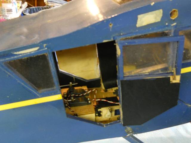

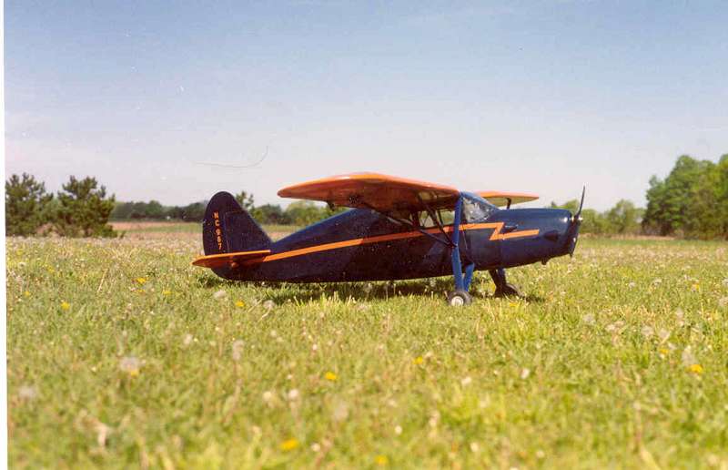

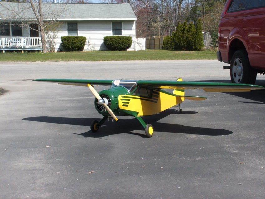

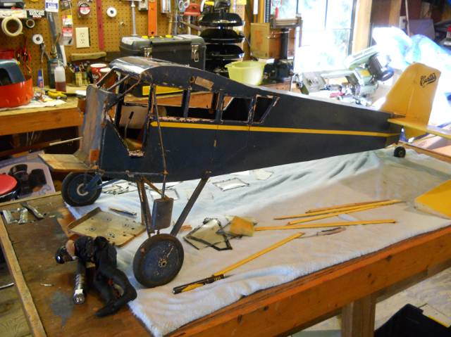

Hi Guy's, I've got a new project in my shop and I've hit a wall. I recently got an older built Curtiss Robin OX-5 that was built many years ago using a kit from the now defunct company which was called Ikon N'wst.
The plane is very sound and intact with no fuel soaked wood or rot. I've got just about all the covering off and striped down to the frame. Here's my question! How would a person go about getting the tail apart so as to recover it? It's glued with what appears to be your standard white wood glue.
I've read where people soaked the glue over several day's using white vinegar and even 90% rubbing alcohol and the list goes on. Some say they use a heat gun?
What'ya think? I'll post pic's of the beast later. Here's a pic of a real Curtiss Robin.

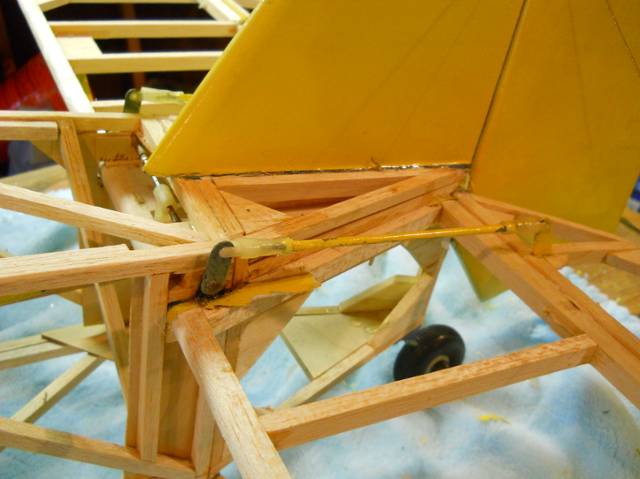

Old 02-10-2014 | 04:39 PM

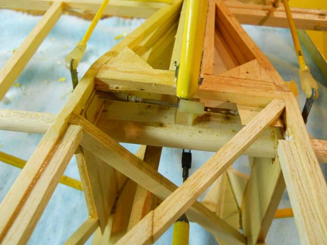

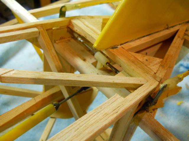

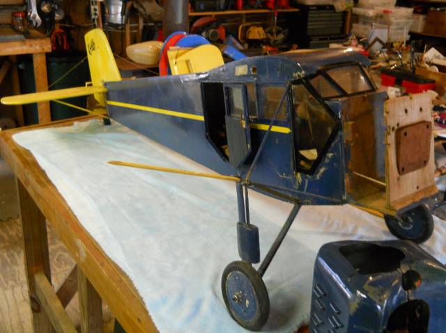

I just recovered an Ultra Stick Lite and while the horizontal stab had come off, I covered the rest while on the plane. If there no structural problems, I would try to leave it intact. That said, I am very interested in what others say, should I have to do it again.
Old 02-10-2014 | 06:19 PM
Moderator
Joined: Dec 2006
Posts: 7,266
Received 35 Likes on 30 Posts
From: Fort Worth, TX
You usually can't get them off, and there's rarely a reason you need to. Just cover 1/4 inch or so past the corner where the stab and fuselage meets when you do the stab, then stop right at the corner when you do the fuselage. Nobody will ever know there's a seam there.

I'm in agreement with the others. Strip the covering, but leave the control surfaces installed.

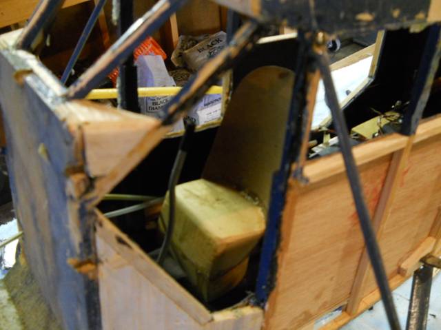

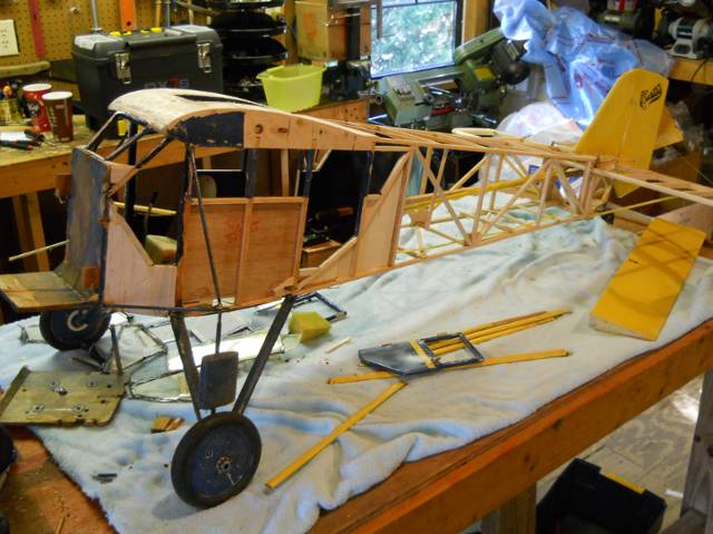

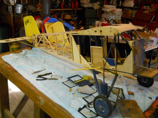

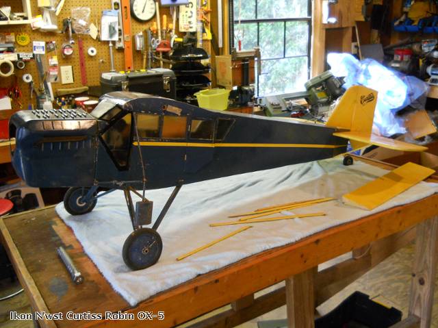

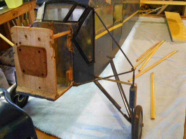

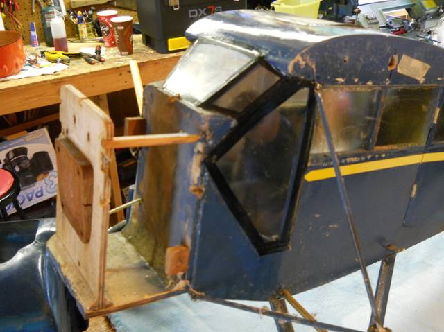

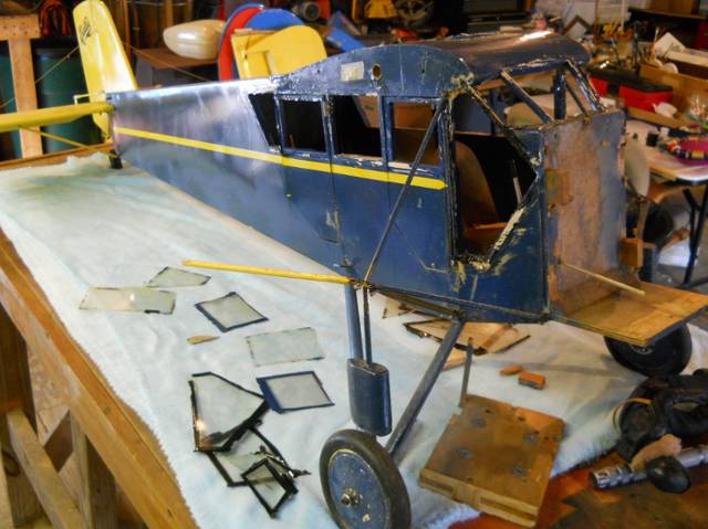

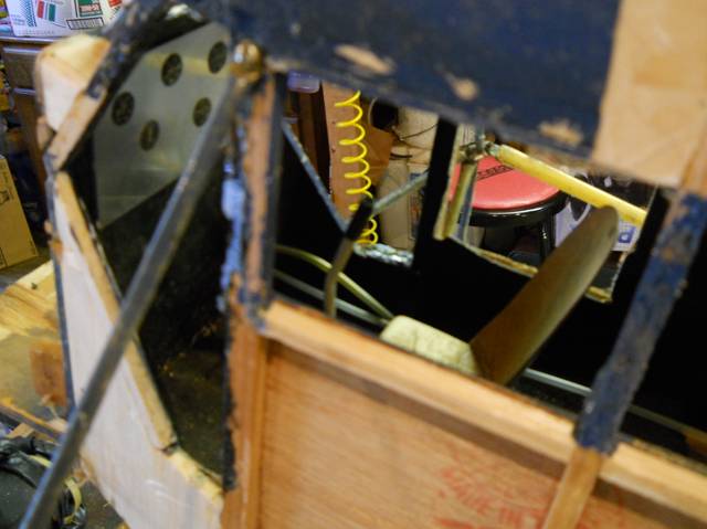

Here's a few pics of the old bird.
I'm relieved to hear that I can leave the tail assembled during the covering process. I'm going to put some hatches in the rear fuse before I cover it so as to have access to the rear linkage's.

What are you using for covering ?

I haven't decided yet. It had painted cloth when I stripped it.

May I suggest Natural Solartex and paint ? It'd be a perfect combination for this unusual model.
If you took pictures of the Curtis logo, etc, new graphics cam easily be reproduced.
I build mostly scale models. The last 7 or 8 have all been covered in Solartex and then painted. The covering is so easy to apply, that it spoils you. LOL

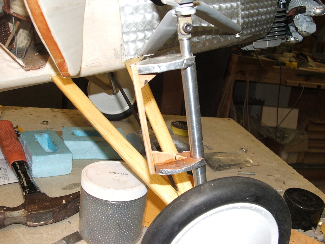

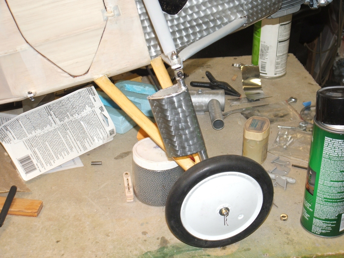

What are the blocks for just above the tire's? The landing gear has built in spring loaded shocks just above those block's and those shock's seem to work quite well.
Old 02-13-2014 | 12:48 PM
JohnBuckner's Avatar
Posts: 10,441
Received 11 Likes on 11 Posts
From: Kingman, AZ
Those are the simulated full scale streamlined housings for the bungee rings which provide the springing action on those telescoping struts. My guess is on the full scale there are perhaps six rings on each strut with three in front and three in the back working in tension.
Alternately instead of multiple short rings of bungee its it may be one in front and one in back with a single continuous wrap,

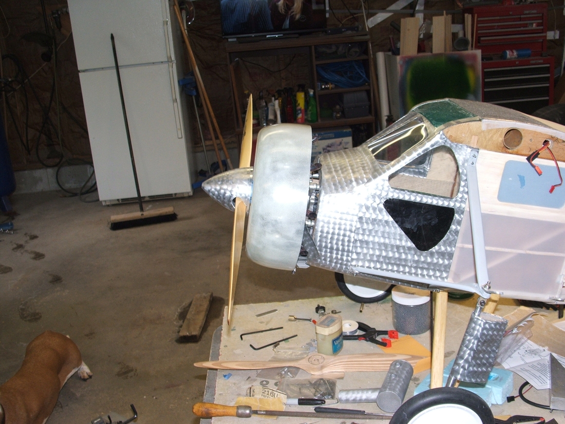

Solartex is easy tyo apply, just follow the instructions on the roll. Balsa USA is where I buy mine. http://shop.balsausa.com/product_p/547.htm
If your Robin has a 100" wingspan, or less, I think a 10 meter roll should suffice.
I fel that Natural Solartex is the way to go. It accepts paint better than the colored product.
Just about any paint works over Solartex, but I haven't tried auto paint. I suggest that you make up a small test panel, and ask your friend to spray it with the paint that you plan to use. It's bettter to screw up a test panel, if something goes wrong.
There are reasons to not use primer whjich we don't need to go into. Just spray the paint directly to the Solartex.
I have a pic of what goes under your "blocks". My current build has them, too.

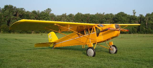

Here are pics of some of the IKON designs that I have owned and built over the years. My latest one (the green/yellow Cessna Airmaster) was built 2 years ago. The kit was still in great shape ! Although some are 20 years old, I still have all of these, except the orange/blue Fairchild which met an early demise.

Does anybody know the proper name for this elevator linkage? I've looked online for this elevator linkage and can't come up with anything like it. The original linkage is worn and slips and I'm intent on replacing all the hardware on this plane.
ID:	1971627   Click image for larger version
ID:	1971628   Click image for larger version
Old 02-24-2014 | 07:54 AM
Moderator
Joined: Dec 2006
Posts: 7,266
That is a bell crank. I doubt you'll be able to find one like that though as they went out of style a long time ago. They introduce extra slop into the system and are an added failure point. If you will run two golden rods or steel rod in a tube pushrods back to the elevator that connect at the servo you'll get the same result with a much stronger and tighter connection. There are a number of different ways to join the pushrods at the servo end depending on which ones you choose. A 2-56 coupler can be made by drilling the right size holes in a piece of HDPE or even tapping a piece of aluminum. Or if you know how to solder (that doesn't mean just watching a youtube video about it) you can use plumbing solder or Stay Brite silver bearing solder to join them. Wrapping them with thin copper wire before soldering will give you an indestructible joint. And, of course, there is always option 3, which is to run two elevator servos.
