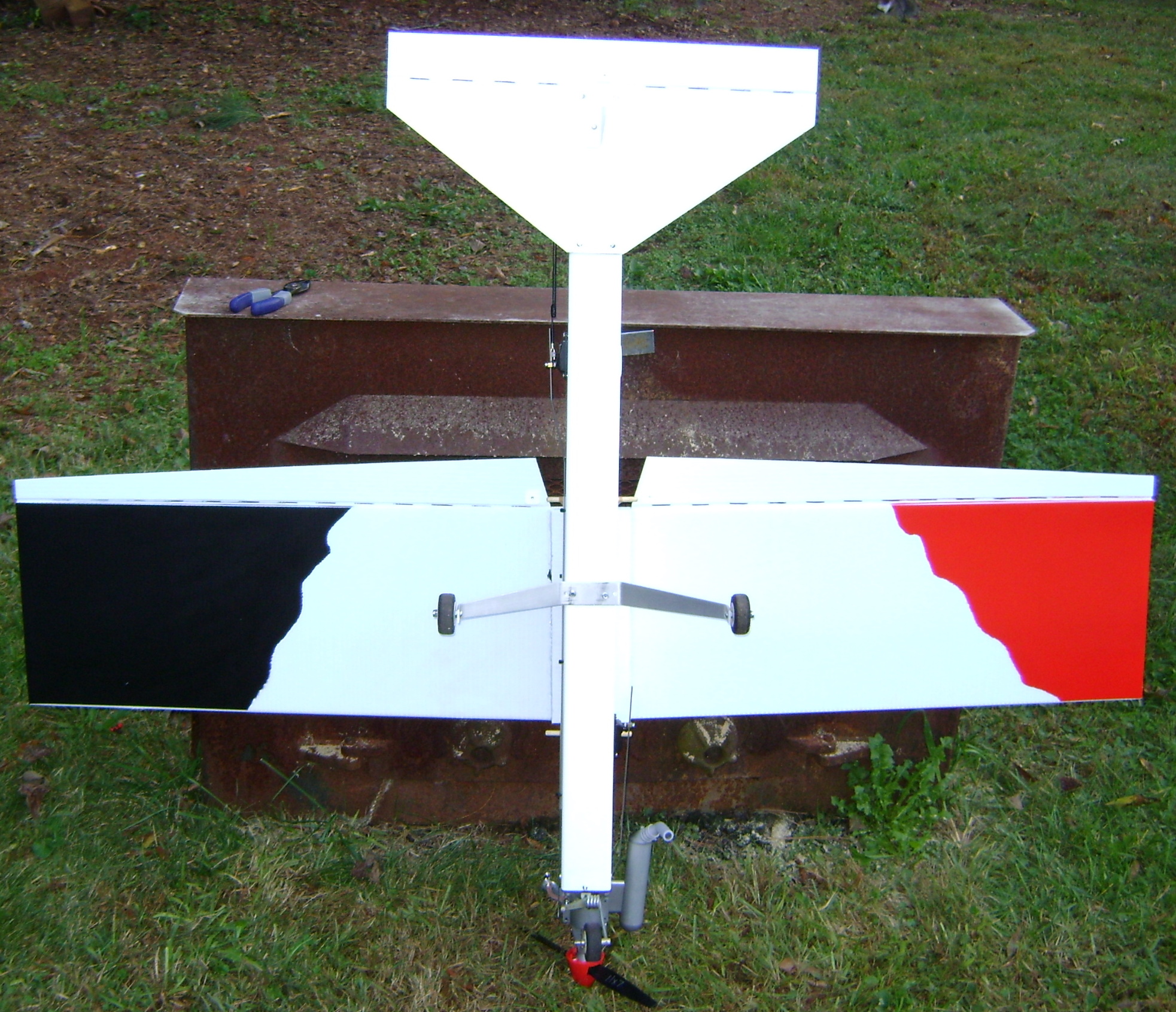

Jester if my Debonair takes to the air I will be a happy camper. I just need a slow plane to practice with. On landing I will try for the runway. But, I do have lots of grassy areas where it can settle down.
The Ugly Stik is gathering shop dust in my cluttered shop. It awaits a topcoat, final assembly and graphics.

Sweet! I love seeing guys who still actually build. Did you use Koverall for that? What did you paint it with?

Yes, the whole airplane is covered in Koverall. Since I was concerned about balance I added an access hatch on the bottom and modified one former so the battery may be moved about. Servos and pushrods tubes are installed in fuselage. The plane was painted with Home Depot Aviation Paint. Actually both planes were painted with HD paint.
That looks great! What style of paint did you use? Spray enamel? You have to get it flying so you can tell us how it holds up. Always looking for new finishing ideas here.
Home Depot sells 8oz. sample bottles for about $3.00. I just selected the colors I wanted from their color sample and had them mix it. The paint is Behrs flat enamel indoor- outdoor. I sprayed the paint on the plane and it sprays pretty good. On the Debonair I sprayed the topcoat in cold weather so it did not flow as smooth as possible. But ok for the Debonair. For the Ugly Stik I will wait for warmer weather. Some of the US control surfaces are done. They came out super smooth and high gloss. I use Deft Defthane Polyurethane for a topcoat. Unfortunately I can only find it in rattle can. A spray gun finish would be best. I have used Deft products for years. Now there was a company takeover and it is harder to find.
So far, running the engine on the Debonair, the paint is holding up with glow fuel. Paint testing with glow fuel is part of the process.

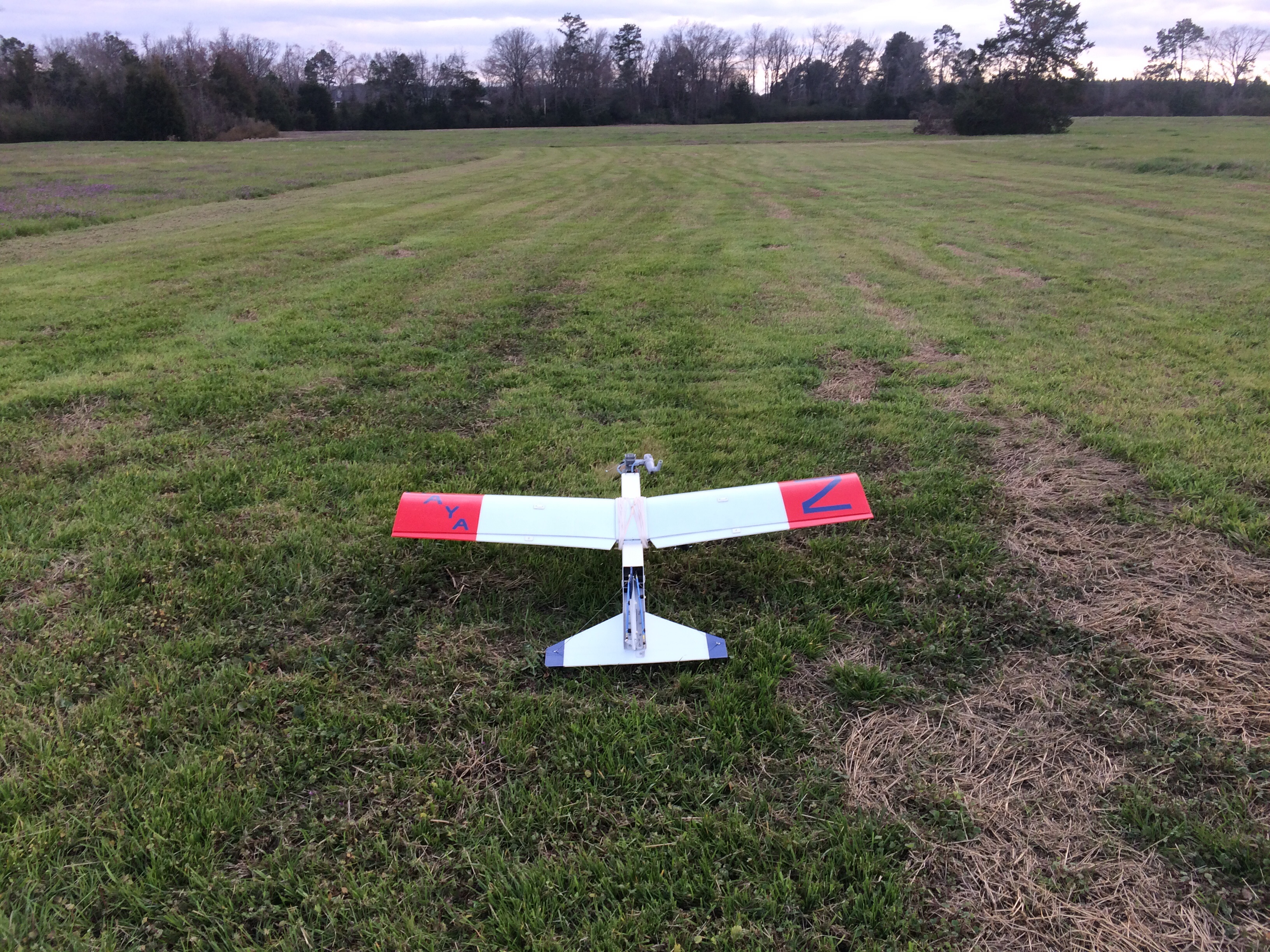

Well some good news and some bad news.
First the good news. The weather finally turned in my favor. I mowed the runway down to 3". Today was a good day to fly later in the afternoon. I did a nice takeoff, shallow climb to altitude. I found that I could still fly after all these years that have gone by. The plane was well behaved. No trim needed. I really felt good. I decided to fly rectangular patterns around the runway.
And now the Bad News. Making the fourth turn with the plane flying directly at me, something went wrong. The plane just spun in. Too fast to react. My first thought was that it went into fail safe as it reacted how I had fail safe set up. Doing the post crash investigation, I don't believe it was fail safe. Thinking more pilot error. The controls were not in the fail safe position. The radio n servos still worked. using binoculars I went a good distance away n radio still functioned good.
Just before the third turn in the pattern, I reduced the throttle a bit. I think I may have accidently reduced the throttle in the fourth turn and just stalled the airplane. Since the plane was turning toward me I did not have a good perception of speed.
Anyway, the Debonair is gone. no damage to the engine. The wing has a crack which may be repairable. I may give it to my granddaughter if she wants it. It has her name. Back to the building board. I can salvage some from the old plane and build another wing if I need to. Debonair II coming up. Without the paint. Just plain ole plain.
At at least it was not my Ugly Stik. That would have been hard to take.
The picture shows the plane facing the runway ready for takeoff. Second picture shows the crash on the runway. I flew a nice tight pattern.

I don't get it. What was your approximate altitude by that "fourth" turn? Did you forget to "push your stick towards the low wing", to straighten it out? Push it towards the high wing while it's flying towards you and it spirals in. I have a hunch that's what happened.

Well I did need to be higher. I was at around 100'. It was not a wrong control input problem. My number 2 turn was similar and that was not a problem. I have been practicing for the plane flying at you situation.
As the plane turned towards me I was ready to raise the down wing. I never got to that point. It just abruptly went into the spiral down. Made a nice thud when it hit the ground. I am pretty sure it was a low speed stall during the turn. With the wing banked, the stall speed goes up. I think I was just too slow for the turn, plus too low in altitude. I will have to remember this.

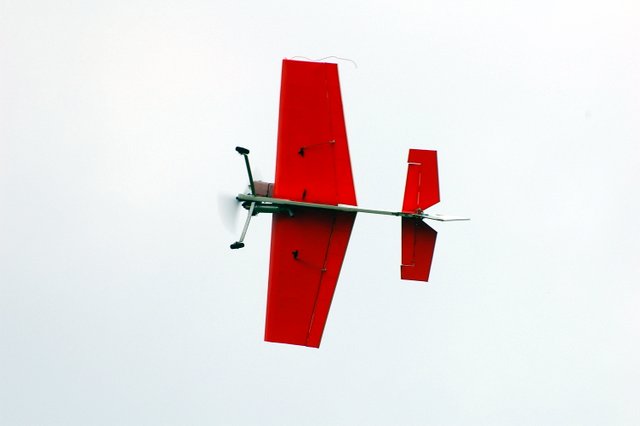

Yeah, they keep telling me SPADs "bounce" but I haven't been that lucky. I had similar results with my Deb MKI. I had an old K&B 65 on it that I never could get tuned right. She cut out on me, but I couldn't really hear it because I was a good ways away. When it went down, out of ALLLLLLL that grass out there, I clipped the edge of the asphalt walking track. DANG! The wing survived though and I put that on Deb MKII and she's still flying sweet 5 years later with an OS46FX on it.

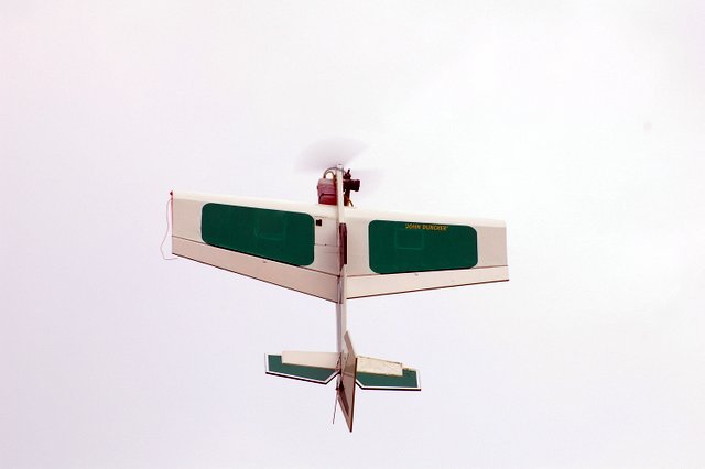

All white airplanes are hard to see and difficult to orientate. Do yourself a favour and put a big band of contrasting colour on one wing.panel.
My first 3D plane was all flouro orange. Big mistake.
Number two looked like this.

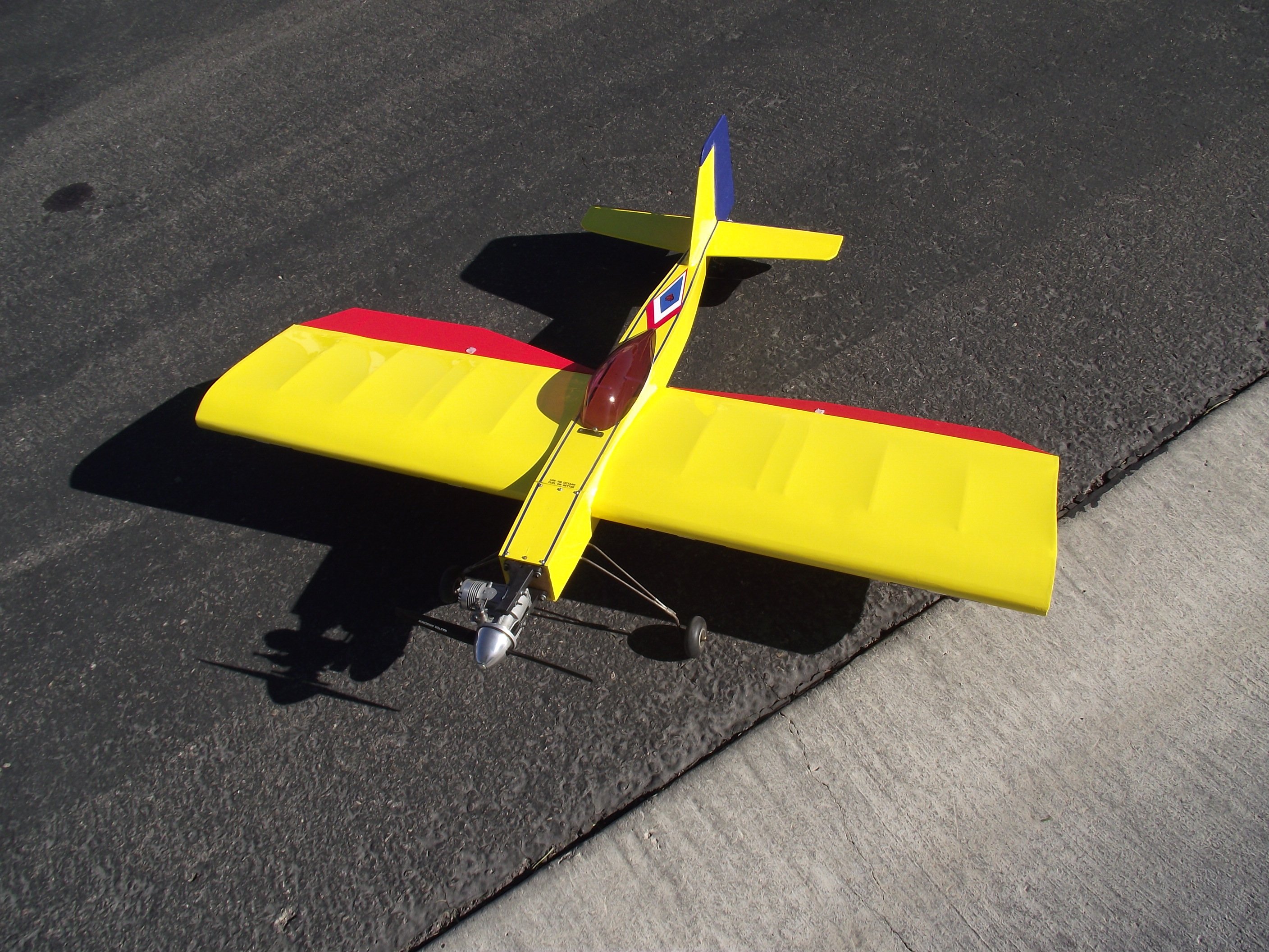

Disagree, as color blind as I am I can spot the contrast on the bottom. I tend to look up and see the bottom of the plane a lot more then the top. Doesn't mater a lot as long as you know top from bottom though. With any type of stunt plane I contrast the bottom so I know instantly what attitude the plane is in during a spin.

Hi Greybeard. That's an Uproar and I just started a kit. Curious, what tank were you able to squeeze into it? Brand?
