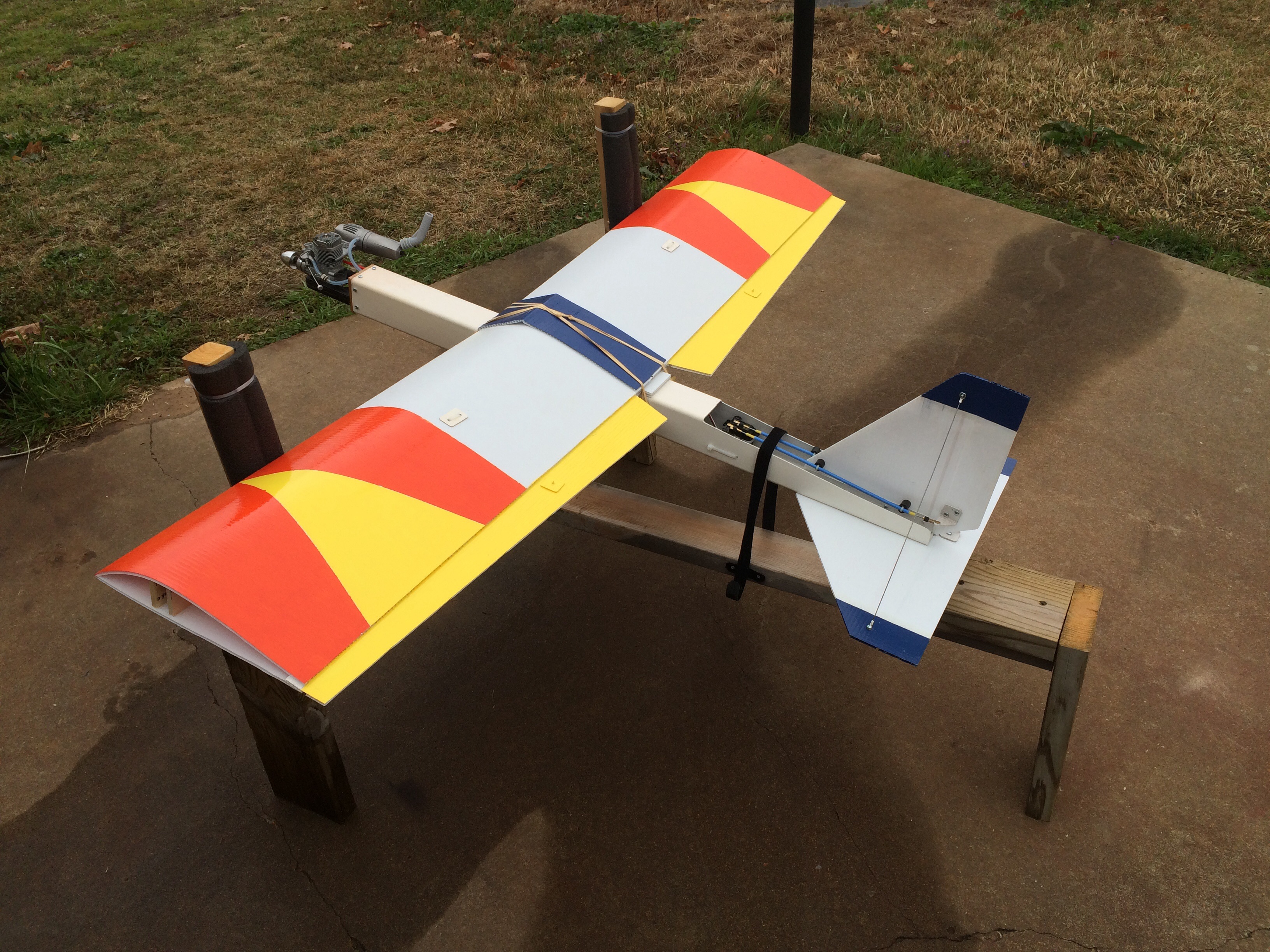

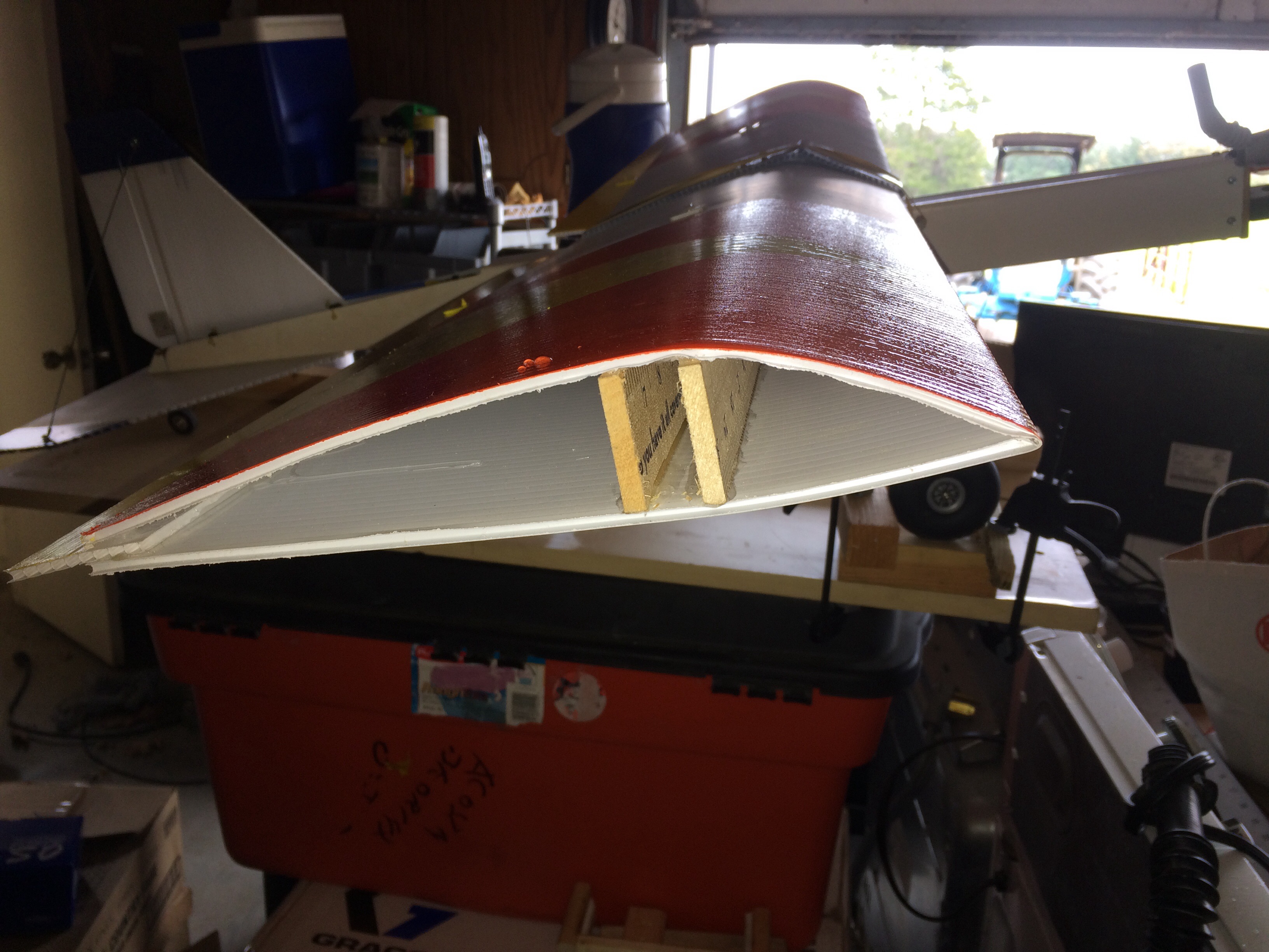

Well it took a while but I got Deb II built. I hope it flies more than 4 turns. This one allowed me to reposition a couple of things that I did not like on the first model. Now if this Texas weather would cooperate. I've had rain, yesterday sleet n ice and tonight to tomorrow maybe snow. I have to recondition the runway, let it dry off and mow it short.
Today i froze reinstalling the starter I had repaired for my tractor. I had to use a heater to thaw the ice encased tractor in order to do the work. Tomorrow is a bad weather day so I will work on my next build; a scratch build Sig Kadet LT-40. It should be fun. Patrick this is not a kit plane so not sure if there will be any interest. I will start drawing it out tomorrow. Looking at 72" WS.
A picture of the new Deb and the airfoil that will keep it aloft.

Have you checked the balance of the new ship, The nose appears to be rather long
John, the long nose on these airplanes appears to be a standard thing. I've seen it on other builds n has been discussed. As my plane sits it is just a bit nose heavy. I will definitely check it again before flight. Thanks for the heads up.

That's the typical Debonair airfoil I was talking about. The sharp leading edge is going to be your problem as it will stall very suddenly instead of gently like a Clark Y airfoil or the typical blunt leading edge airfoils used on trainers. There's a good reason why the spad guys go on and on about how much their planes can take a beating; it's because they crash so much usually due to bad aerodynamics and being overweight. It's actually quite difficult to get a proper leading edge with coroplast, but the planes can be a lot of fun anyway. Best of luck to you on the first flights.

I have to disagree. My Deb floats like a dream and doesn't have a sharp stall. The only spad I've built that had a bad snap was the Dominator and I think it's the tail design and I probably had too much travel on my elevator. I was going to build another one and redesign the tail to look more like the Deb tail, but I haven't gotten around to that. If that's been your experience with them, that's your experience and I certainly can't disagree with that, but to me, the spads I have built have flown well and had decent flight characteristics. It's not hard to get a rounded leading edge either, but I do it more for looks than anything else. Not trying to argue because I'm sure you have a lot more flying experience than me, but I just haven't had a lot of bad luck with mine.
