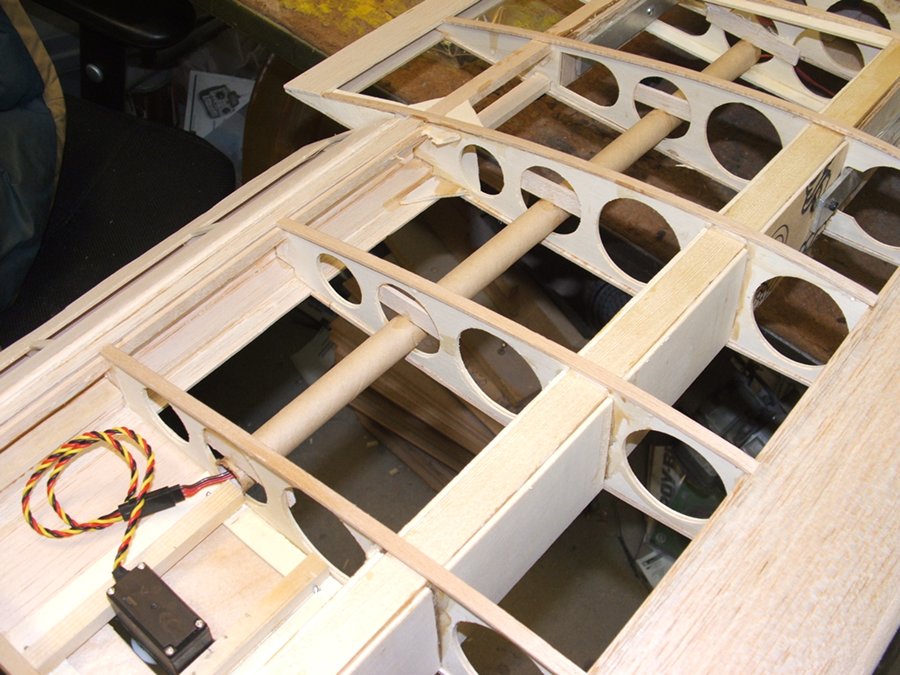

ID:	2241290I am running wires to each of my servo's in this wing. One for the flaps and one for the aileron, I also wanted to run the wires to the landing and nav. lights out to the wing tip, using the same hole I put in the ribs. There will be like 10 wire touching each other..... As you can see in the photo they will be twisted, but will this be a problem with interference, when I operate the servo's? There will be something like 45 inches of wire in both wings. Should I make 3 runs of wire, 1 for the lights, 1 for the Flaps and 1 for the ailerons,?
Thanks Dave

Spreading the wires out might not be a bad idea, especially for the ailerons. I know you're not looking at huge amounts of current but, just some info to be aware of, all wires generate a magnetic field when electricity is flowing through them.
That said, all wires also work as antennas. The magnetic field created by current flow, if strong enough, can generate a current in an adjacent wire. In a servo, this could cause twitching due to stray signals being generated. In older servos, this was not really an issue since the servos didn't take that much power to make them work. With the modern high powered digital servos we have today, this may not be the case.

Twisting doesn't help you out much (or at all really) with servo wires but if it makes you feel better, they do look neat.
What you're talking about it done every day in hundreds of models and you're trying to fix a problem that doesn't exist.

Just a thought, You may want to keep the items separated in case you have to work on one . . Also you may want to consider a larger hole so it won't be so hard to get at a certain item . ENJOY !!! Red

I run my servo and light wiring, through a single tube. There are no issues with working on a specific set of wires.
