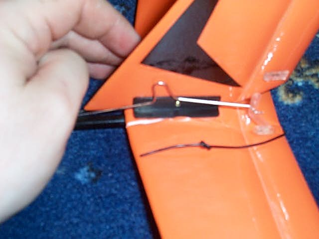

Hello there.
As a total beginner to the hobby, I am just putting my 1st ARTF together. The Push Rod on the Elevators is slightly too long, but overly long to be just trimmed out.
The question is, what is the best way to put a new bend in the push rod? Is there a set way to do this with a tool or something, or just to go ahead and bend it?

Need more info in order to help you. what type of push rod? What type of ends?

A tool is best used to install Z bends in the wire

Hmm, no idea, they came with the kit, attached a couple of small jpegs to show them..............

If its just a bit too long, just make the bends there right before the horn a bit sharper to take up the extra length. That is an old method of adjustment on small planes.

Another easy way to control the slack in your pushrods is to use EZ Connectors. They are the best way in my opinion for adjusting push rods. you can use the Z Bend method that you are using now on the tail, and attach these :
http://www2.towerhobbies.com/cgi-bin...1&I=LXD925&P=0
to your servo arm. The pushrod goes through the connector, and the screw on top of the EZ Connector tightens down to the length needed.
