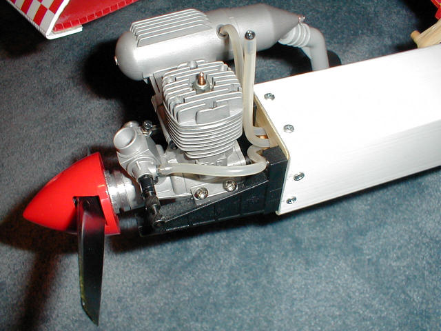

Ok I checked everything, no leaks or loose fittings etc. The engine runs fine but at full throttle I see a constant stream of bubbles in the line feeding the carb[X(]. Is that normal?
It only does this at 3/4 - full throttle.

Sealed engine , muffler, and carb fittings with red rtv. No leaks! Ran full tank through and no feul on engine at all.
The tank is a 3 line , all new lines and all tight, pressure check ok.
third line is fill line with a screw in it . Bottom line is from clunk to carb, and clunk is on bottom in corner of tank. Left line goes from muffler to a 2 inch alluminum tube through the gromet into the tank . Same for right line to fill tank. There is no feul tubing from the right and left fittings going into the tank just the 1.5 inches of aluminum tube.
No airbubbles till i hit 3/4 to full throttle. Its got me baffled, high rpm smooth even moving nose of plane up and down at 45 dgree angles.

Heres a pick of the line setup.

WHOA! I posted too quick. According to the pic at post 6, this is a carb needle, not a remote.
Still good advise for remote needles though.

ORIGINAL: ED STEFAN
Oppps, I should have blown up the picture. Looked like a remote when I looked at it. The third line you have looked like a line to a remote needle.
That changes things. The bubbles in the line have to be coming from the tank then. Sorry about that.
Make sure your tank is not jammed in the fuse too hard with foam. If it is mounted too solid, it will produce the bubbles you are seeing. I have a friend that had too much foam around it and it was too tight. That was the same as not having any foam. Huge bubble problem. Check that out.

Had 1/2 foam rubber and it was real tight. Pulled it out and checked everything carefully. Used 1/4 foam padding this time and test ran. No bubbles till it ran outa gas. Problem solved. Thanks guys , great help as always.

I too have seen this happen when the padding is over-stuffed around the tank. The foam actually transmits the airframe vibration straight to the tank and causes bubbles.

Sure, Too much foam, causing vibration to be transmitted, = foaming=bubbles.
