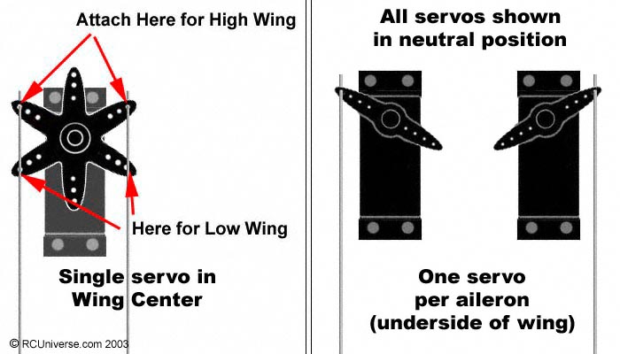

It seems that the travel for the ailerons on my plane calls for more up then down travel. Since it's only using a single servo, what's the best way to do this?

Don't put the link at 90 degrees to each other on the servo. Put it at say the 10 oclock and 2 oclock positions. You can use the star wheel and put it off center. That will give you more one way than the other. You just need to make sure to use the right side to get more up than down. You can also move the horn on the aileron itself to acheive it, but it is better to do it on the servo wheel.

Flyboy is correct. Use a 6 point star wheel and hook up as pictured.
And if you don't have a star wheel, just hook them up so they travel the same amount... It's really not that big a deal.

I am not seeing how the 6 point star will give him what he wants.

It may be a bit hard to visualize if you've never setup that way before.
If you have a single-aileron wing to play with, set it up and you'll see.

Geistware,
Look at Mike's graphic. You'll notice that with the 6 point star there will be less throw to the front (less down), which is what you need for aileron differential.
Griffin,
You may be curious as to the reason for less down, or aileron differential. In some planes (trianers quite often), equal down throw will cause "adverse yaw", which means that the plane will "yaw", or the nose will turn in the opposite direction of the "roll" input given with ailerons. The reason it happens is; the downward deflected aileron, while increasing lift, will also increase drag. The increased drag slows that wing which results in the plane's nose swinging towards the slower wing.
For example, you give left aileron command which will cause the plane to roll left (the direction of the intended turn), but the right aileron drops, which CAN cause the right wing to slow a bit, thus causing the nose to swing to the right.
By making down aileron a bit less you can over come the tendency towards adverse yaw.
Does that help at all?

ORIGINAL: Geistware

EPA will do nothing for him if he is setting up a 2-servo wing with a y-harness.
Think about it. All you'll wind up doing with EPA is making ONE aileron go up more than down as desired. But then the other will go down more than up.
To make use of EPA to get this kind of thing, you need to use 2 channels. Then, you could use the radio's mixing to make it work.

You can use EPA to adjust total throw, but not differential. That HAS to be done mechanically with a torque rod setup.
