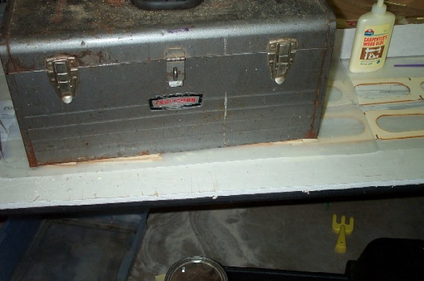

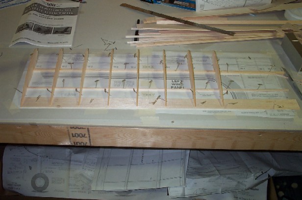

I started building my Mid-Star 40 last night. Based on information gleaned from CafeenMan's site at www.airfieldmodels.com I am using yellow glue for most of the building.
Last night, I sorted out the wood, marking each piece and checking it off the list in the manual. Then I cut out the left wing from the plans and put it on the board with wax paper over it. I laid out the 2 bottom spars and the tail edge sheeting. I removed all the die cut ribs from the sheets. That turned out a lot easier than before, because I followed CafeenMan's advice to lightly sand the back of the sheets. The ribs almost popped out, but I still cut them out with a sharp hobby knife. After all parts were dry fitted, I glued and pinned the W-2 ribs to the spars and the tail edge sheeting. This was left to dry overnight. Tonight, I glued and pinned the W-1 ribs and glued on the tail edge stick. This will dry over night also.
Here are some pictures of my progress so far:
The first picture is the required picture of the box. The second is at the end of the first night. Third and fourth are from tonight.

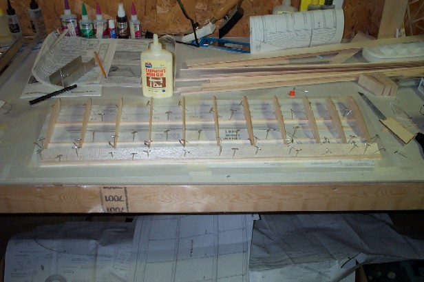

More progress tonight. Top trailing edge sheeting glued on. Leading edge glued on. Top main spar and top front spar glued on. Then I had to move onto the fuselage, as the next step for the wing is to start removing pins to attach the center sheeting. So the glue dries tonight. I started working on some of the fuselage steps. The 2 F-1 formers were glued together and set aside. The F-2 and F-2d were glued together and set aside. The landing gear block was marked and drilled for the blind nuts. The blind nuts were installed, and the block was set aside. Then I glued the fuselage sides and doublers together, taking care to make a right and left side. The fuselage sides are what you can make out underneath the toolbox.

Under this tool box are the F-1s and the F-2 glued to F-2d.
Some things I have noticed:
1. I really like using the carpenters glue. It is nice to be able to adjust the parts to just the right place (the doublers). And the wait for the glue to dry is not bothering me. It is keeping me from trying to rush the build along.
2. Different from what the build manual states, most of the parts are laser cut. The only thing that is die-cut is the wing ribs.
3. I am happy with my progress so far.

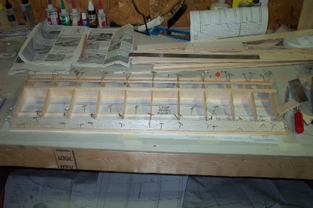

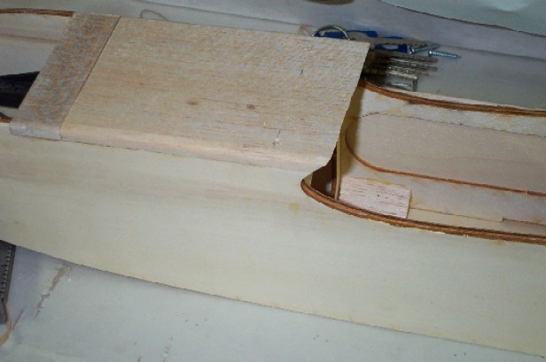

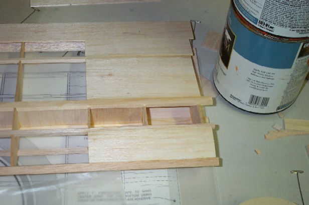

A lot of progress tonight, but not many pictures. The fuselage is about finished. The only thing left to do on the fuselage is finish sanding, so I am going to wait until the wings are done. The left wing is about done also.
The first picture shows my way of weighing down the center sheeting on the wing half. That is on the top side, and is what I did last night. Forgot to take a picture of it at the time though. The second picture is the center sheeting on the bottom of the wing. I also glued the last spar in tonight. The last picture is what the fuselage looks like right now. The fuselage is a quick build, as all the parts are laser cut lite ply. They have tabs that lock together and keep it in place. I did have to scrape out some dried glue from where I glued the doubler to the fuse side, as it oozed out and into some of the slots where the formers go. And CF-2 (the slanted former at the front of the turtleback stringers) was a pain to install. The instructions said specifically not to bevel it, so it does not have much wood to wood contact. I may reinforce that later, depending on if the covering goes over it or not. I can't remember off the top of my head right now (it is getting late

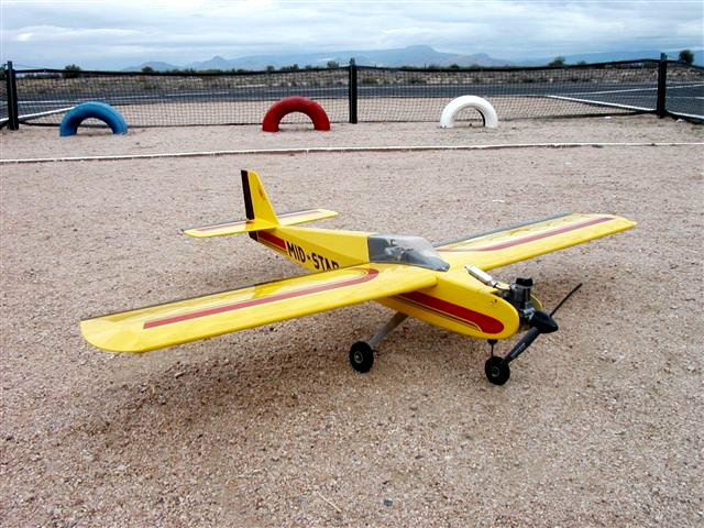

My first kit was a Mid-star and I thought the kit quality was great. I am currently building my second kit (Tiger 60) and I am disappointed in the kit quality. A lot of things do not match with the plans.
There is one thing that I have noticed after flying the Mid-Star for 9 months. Top and bottom halves of the canopy are made from plastic material. Over time the vibration of the pilot figure has started to crack the bottom of the canopy. You might want to pick a figure that presents a large surface area where it glues to the canopy, or go entirely without.
I have attached a picture of my Mid-Star. Good luck with yours.
Tom

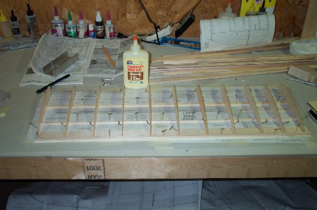

Okay, today's progress:
1. Sanded left wing ends and leading edge. Can't do much else until I get a whittling blade tomorrow.
2. Started right wing. All ribs are glued down.
3. Sanded fuselage. Cut and drilled tank hatch.
4. Sanded the trailing edges of the elevator halves round.
Now I know why they say SIG stands for Sand It Good!
A couple pictures. First is the right wing on the bench. The second is the tank hatch.
Art, what would you think of using some thin CA to strengthen the turbulator spars? I am a little to far along to replace them.
