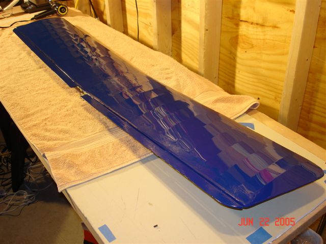

Finally, some work is being done on the trainer![sm=thumbup.gif] We've been busy lately on getting this thing into the air. If we didn't start hustling, we'd be looking at having to equip it with skis!
Eva is pretty good with an iron, so I made good use of her!

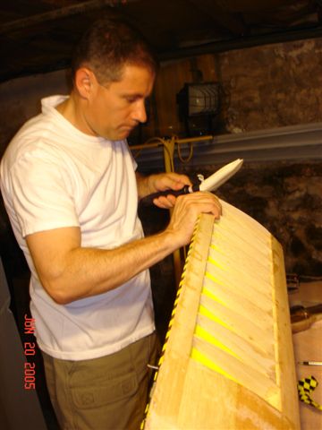

I did some covering, too (mostly posing).

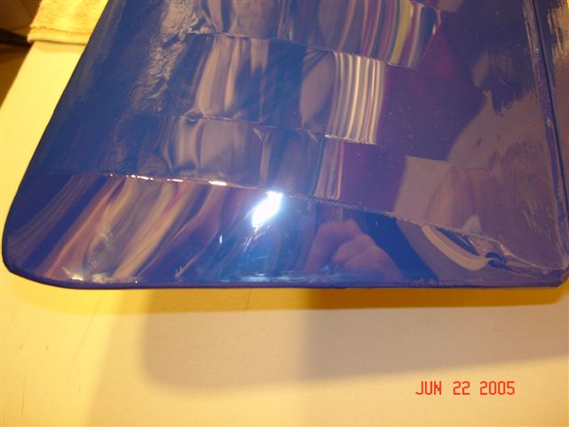

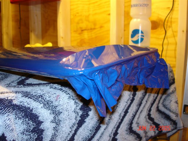

We've got the wing covered and I wanted to show you all our work and ask a few questions.

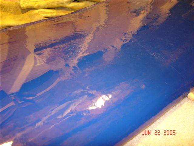

We used an iron for all of the flat surfaces and used the iron and heat gun on the wing. You can see our work in the pics below.
We pulled and stretched and pulled and swore and we never could get all of the wrinkles out of the wingtip. Is is possible to get it smoother than this?
And how do you get a perfectly straight cut along the edge when you are finished? Ours looks kind of ragged. I like to refer to it as "good from far, far from good".
I did some covering, too (mostly posing).We've got the wing covered and I wanted to show you all our work and ask a few questions.

Dave, that wing tip looks pretty good to me. The edges need to be ironed down with HIGH heat.
As for making straight edges over a leading edge or tip, your best friend is a NEW single-edge razor blade. I buy them in bulk packs of one hundred.
Harry Higley makes a gadget for this purpose that uses single edge blades, but it depends on a very sharp blade. Plastic covering dulls blades faster than you would ever believe; if the blade snags during the cutting stroke with the Higley tool, a ragged edge will result.
I have given up trying to make a perfectly straight edge when trimming a color border. I now cheat; I cut a strip of the darker color the necessary width to cover any waves, etc., and iron that down over the seam. Presto; a nice, straight color separation line.
Here's another thing to consider; keep your seams properly oriented. IOW, cover from the bottom up, and from rear to front. That way, the edges of the seams will be pointing "down" and "back" and therefore will not trap fuel residue and/or other crap, nor be susceptible to lifting from the slip stream. The one exception I make here is on wing leading edges. Sometimes you have to have a seam that is "up" instead of "down". No problem; seal it with clear fingernail polish.
In fact, I like to seal all my covering seams with some sort of fuel proofer. I have been using Hobby Poxy clear, brushed on, for this purpose, but my supply is about gone, and irreplaceable thanks to the enviro-nazis. I have tried several other things, without much success. The stuff that works best and most easily (polyurethane) turns a ghastly yellow in short order, especially on white covering. Do NOT use the water-based polyu; it isn't fuel proof, as I found out the hard way.[&o]

Thanks, Bruce! Yeah, I got lucky.
Steve,
We've been keeping the seams facing backwards and downwards. Made a mistake on that on the bottom of the fuse, though. We'll be sure to throw some clear nail polish on it.
I'm posting a couple more pics so you can see our work. We have a good, tight covering job, with no wrinkles until you get right up on the seams. It looks horrendous in the photos if we zoom in on it. Standing about 2-3 feet away, you really cannot tell.
As you can see, I had to add some weight to the wing. It took about 1/2 oz to get it to balance left/right. There's actually another weight further inboard and on the trailing edge as well as the one in the pic.
Thanks for the hints for getting a straight edge. I'll have to check that out.
Does anyone know of a good source for decals for 1930's era lettering/numbering? I'm thinking of doing something like the Great Planes Shoestring for our paint scheme.

Ah, so... I see what you're talking about now. I guess you've figured out that you went a bit too far with the overlap, eh?
No worries. Crank your iron up to max, then go over those bumps and ridges with moderate pressure. If you used UltraCote, most of them will flatten out. MonoKote? Well... I stopped using MonoKote because once it has a wrinkle folded back on it self, it ain't coming out. You can still clean that area up a bit with high heat, though.
I think your best bet regarding cleaning up the edges is to use a strip of your yellow/black checkerboard on the LE, to the mid-point of the leading edge. Matching up the pattern teaches you that, while checkerboard patterns are really cool-looking, they are a significant rectal discomfort if you have do some "adjusting".
At the tip, I would probably extend the blue around and across the bottom of the tip to get a straight separation line.

Thanks for the tips. That is a pretty good idea for bringing the blue on the underside of the tip and giving a straight line break. We used ultracote on the bottom cause that's all we could find for the checker pattern. We used Monokote on top cause Ultracote is so expensive. We did find the Ultracote more forgiving. Guess that's what you pay for!
And you definitely are correct on the checker being a challenge to keep straight!
