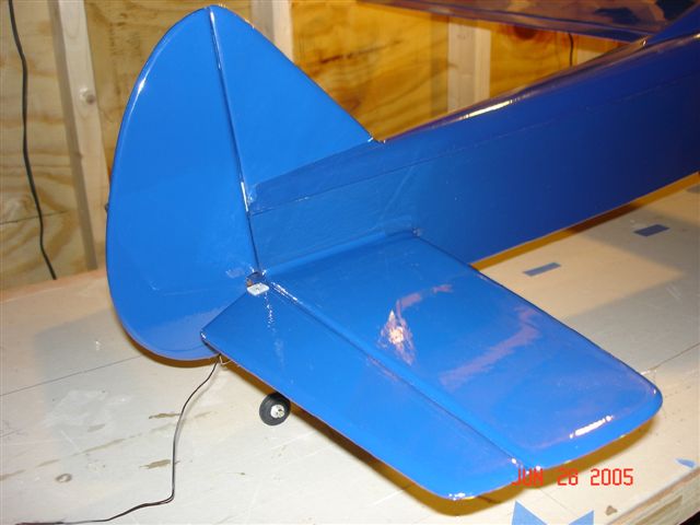

Alright Guys,
We're in the final stretch on this bird! (It's about time!!) I've got lots of pics for you, too.
We're held up waiting for some angle hold down parts from Tower. No one locally had them in stock, and because I had to place a stand alone order for them, they ended up costing me $1 each. [:@] So, when you see the misalignment on the top of the fuselage where it blends with the rear of the cowl, that is why. It is sprung slightly and will be perfectly lined up once our parts are installed.
I've tried to give you some close ups of key areas on the plane... servos, clevises, etc. I also wanted you to get a feel for the lines of the plane, and what it looks like over all. We have yet to put accent striping on it, but so far, I think it has turned out fairly well.
Problems that we encountered along the way:
The mistake on the dihedral brace that we told you about previously. Had a gap in the top of the wing to fill after they were joined.
Having to drill two engine mounts because I dorked up the first one!
Having no experience with fiberglass, my work on the wrap of the wing joint is fairly messy (in my opinion). I wasn't able to get a baby's butt finish to the surface. Ended up rougher than the wood surface around it.
Difficulties soldering the wire wrapping the gear down near each axle. I'll have one of the guys at the field check this out for us. Not sure I got it done solidly. It would be a shame to have it fail. This is a priority check item!
Here are some pics. I'll continue with more pics and the challenges we encountered in a bit.

Challenges continued..
We got our servos installed and then I foolishly laid the control rods out parallel to each other. We could have gotten a better path to the control horns by crossing them in the fuse.
I installed the control rods and had the exit points built before I put in the control horns. Had one end up not lined up and had to rip out the exit point on one side so that it could be moved forward. OOOOPS!
Got the covering installed on the fuselage and then realized that we had worked forward to aft on the fuse instead of aft to forward. Doh!
Had a wonderful time fighting bubble build up on the panel surfaces that we covered. Got a woodpecker and after using that, things went much better.[8D]
Ran out of covering material and went down to the local shop to get more. Word of advice... Buy More Than You Need! We got the same color for the second roll (Insignia Blue) but it didn't match! Must have been a different lot. That's a sore point for me![:@]
