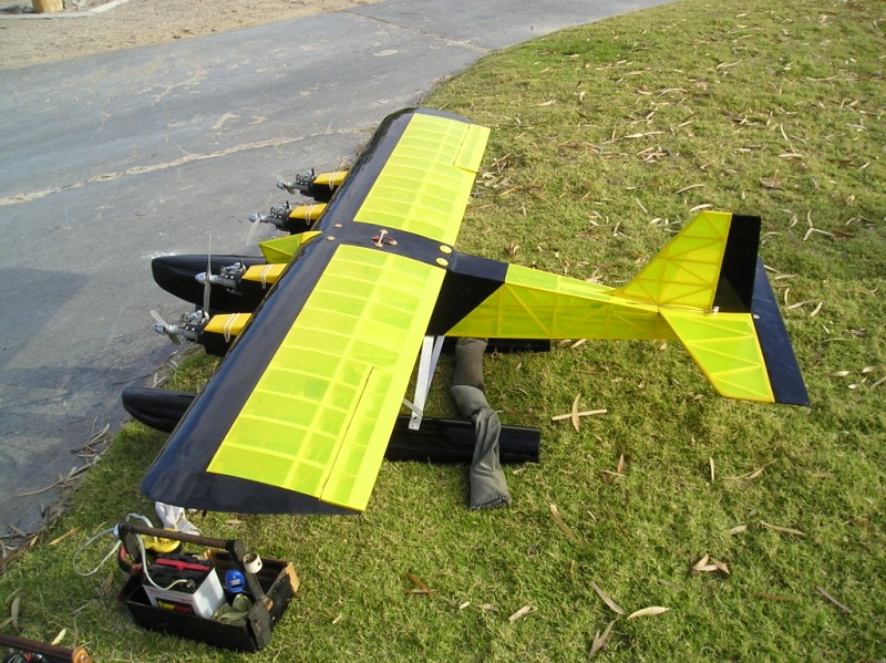

This photo show my Cadet Senior and on this one I used barndoors, reduced dihedral to about one forth of the stock kit Senior dihedral, two servos and you can see the structure through the clear covering.

Great answers guys! Thank you. I think I will go with the barn-door style and duel servos just for the novelty of it. I'd say you did some pretty extensive modifications there John, couple extra engines along with the ailerons! And floats! Actually, I am thinking of taking mine to the water too - since I have a small lake across the street here. I got the Kadet thinking it would be a bit easier - read slower - on landing so I could get set up for the water landings without too much panic. I've been flying a Tower Trainer off the snow-covered lake with floats and that has been a heck of a lot of fun - the frictionless landings on snow are a sight to behold! The plane seems to slide forever!
