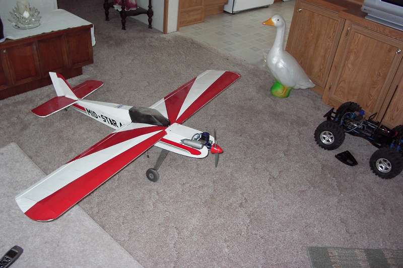

Got my plane last night.
Sig Midstar .40
OS .40 LA w/10x6 prop
Futaba S3004 servos
Also got a radio for it.
JR Quattro lite
