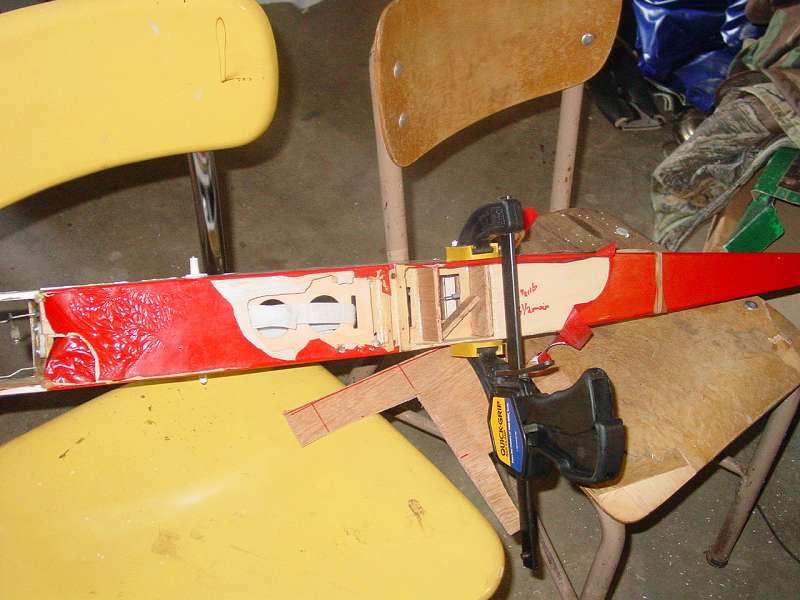

Guys, thinking about it, I was in a huge hurry and probably was my fault. Thats one thing i HAVE to learn. Not to get into a hurry. That new table will be good. I think the plane will now be a taildragger. One more question. The balsa on the bottom of the plane, when the landing gea came out it ripped off, Should i even worry about it? I was just going to put some tape on it. Anything else i should know? Will start rebiulding that sing tonight.

If it's possible tack the sheeting in place with thin CA then either coat it in thin CA OR epoxy.
Next since your converting it to a taildragger use a scrap piece of ply to make a LG mount to be epoxied inside the fuse and coated with epoxy so you can bolt your LG to it.
Can you get us some detailed pics so we know whats the real extent of the damage is?

Landing gear mounting plate should be plywood, 1/4" probably. Put some doublers on the fuselage sides (1/8" ply) to support it. Install 1/4" T-nuts into plywood and use 1/4" nylon screws to mount the gear to the plywood. On a bad landing, all you should do is snap the screws. Keep a few extra screws on hand and you should be able to repair in a few minutes. The plywood should run full width of fuselage and @ 2" front to back, a little more if you have a wide bracket. Balsa just doesn't have the strength for lndg gear mtg, especially on a trainer where you are expecting hard landing and more especially on grass fields

I will get some detailed pictures of it. I have already done a little cutting, so it wont' be accurate and i might keep it a trike. I just don't know yet... I did make a ply mount for the landing gear.
Had a question about the wing though. The curveed part of the sheeting on the leading edge broke. And the balsa breaks when i try to resheet this. How shoul i make it work? Some ribs and a piece of ply across? This will be where the rubber mands go so it will need to be strong.

Replace/repair any damaged ribs. Wing sheeting can be made to bend easier if it is wet. Water with a little Ammonia in it, dab it on and try to curve it around, don't try to do it all at once. Bend it a little around and hold in place with rubber bands. Apply a little more water mixture and tighten (or add more) rubber bands. Steam also helps to make it curve better(no ammonia, don't want to breathe) I know you are bending along the correct grain? Be sure to use the orig thickness of balsa. Once sheet has taken it's curve let it dry in place. AFTER dry, glue into place. This all may take a while, again-don't rush

bruce, what i did was go ahead and put the piece in place ont he inner rib, and the i am letting ti dry overnight and will keep adding a little bit. Let me get all the pics on the comp. I love my worktable. I have a nice sander enxt to it that has gotten use for the first time in years... JOY

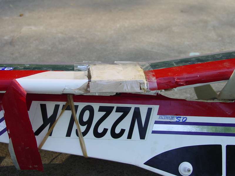

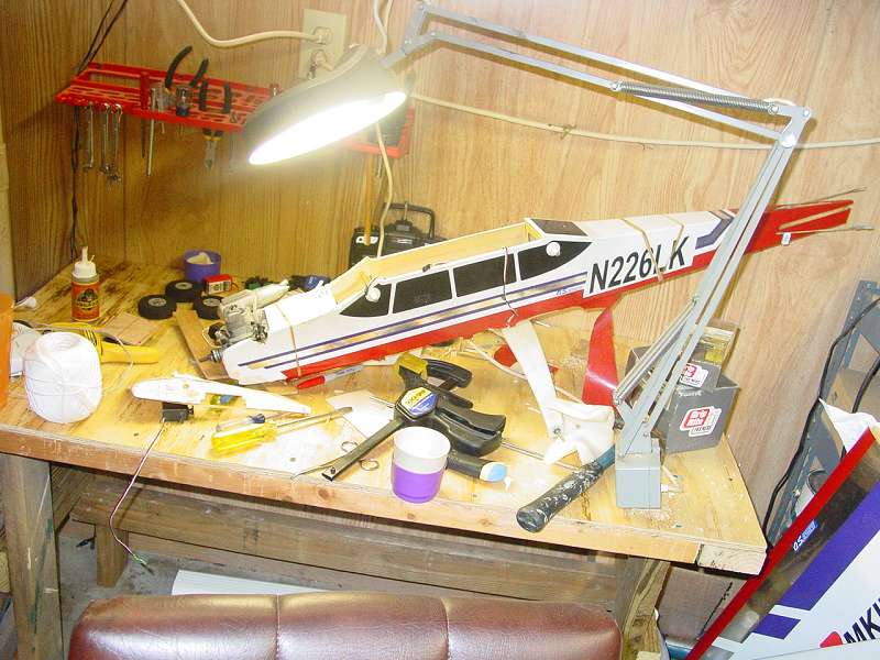

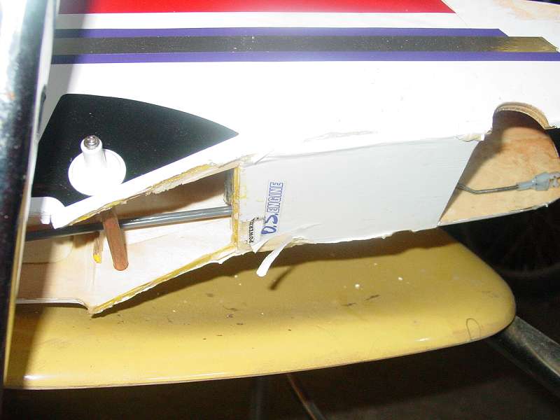

ok here are the pics of the plane. Sorry, on some i had already started repairs, but you can get the jist of it.

are you using plywood? it kind of looks like indoor paneling your using to redo the bottom of the fuse, If so... and this is just me talking.. you might want to try and get some actual plywood from the hobby shop.. I'm not sure if that stuff looks sturdy enough... but hey.. whatever works... and nice workstation... not sure about the leading edge of your wing though.. that'll be a tough one.. or atleast it would be for me LOL... because of all the stress on the wing at that point... anyway.. good luck on your repairs...

It's Really thin plywood. We got it from lowes instead of the hobbyshop though. You would be amazed at how much cheaper that stuff is at lowes...

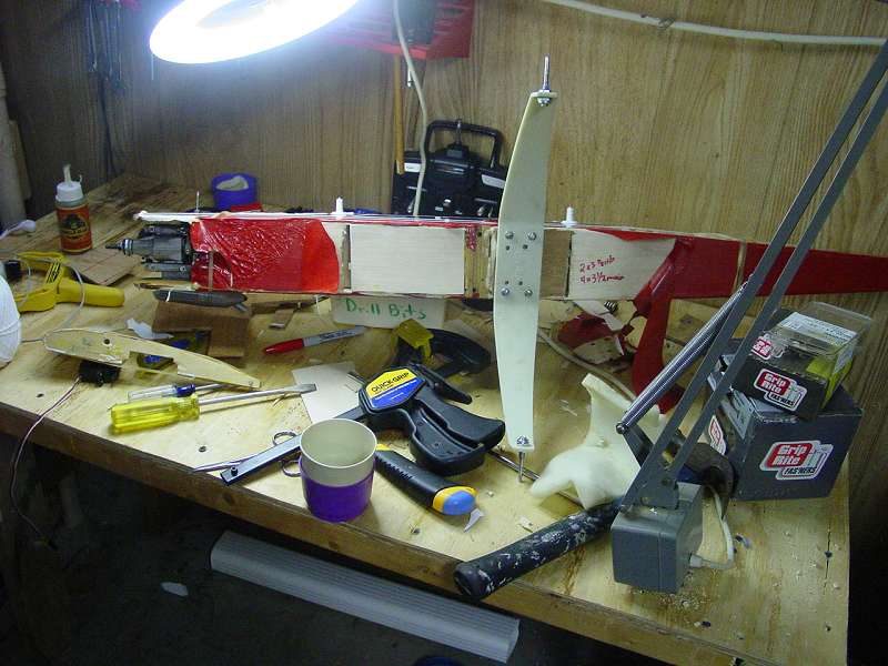

The rebiuld is coming along.
Heres what i got done today:
Ply where ladning gear goes glued and landing gear attatched.
Ply where landing gear was glued
Servos remounted in tray
Engine and gas tank back in
Wing about 1/3 done
Some more little things also, I just can't remember. I will not be able to fly this weekend because my instructor can't, but instead i am going to the lake to being the wakeboarding. Hopefully this will not drag me away from RC. lol

Good start on the repairs. It is always best to break the major repairs up into a series of minor repairs. That way, none of them seem as intimidating. As a whole it may look hopeless. Broken down into smaller pieces and you are more than half way thru it already. Lots faster than building a new plane and much cheaper. Many takeoffs and landings will be good to practice. I think your flying will be fine, most accidents occur during T.O. or Landing, especially in full size.

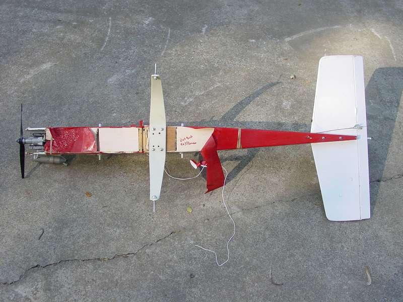

i'm not sure if i'm seeing the pictures right but did you not epoxy the wings together? i see in one of the pictures that the center rib on one wing half is completely clean. although i doubt this caused the accident, it may have somehow contributed to it.
another thing, i'm not sure how the engine was mounted but if the engine mount came loose, make sure you glue that thing on properly and maybe add some more tristock or something to ensure that it doesn't pull free.
otherwise, looks like repairs are coming along fine.
also, if you have dual rates on your plane, i'd suggest that you use one for take offs and landings and the other for "for fun flying". that way you ensure yourself that you're not overcompensating for anything at the most critical times (take off and landing).

Skynard, It is VERY stong. I can't break it with my hand and i have put it threw the tests... Today i will be setting up the reciever and running engine and such.
fore stroke, not epoxy, i used greatplanes would glue, and it didnt work. I will have epoxy this time i will use.
Bruce, I did that yesterday and was VERY surprised on how much i got done. It takes a while but is worth it. I doubt i will work anymore this week, because i have until next weekend

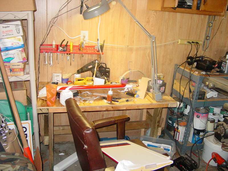

UPDATE!!!
I pretty much have it finished except some small things. I need to make it looks better and whatnot, but the actualy biulding is pretty much done.
