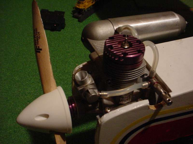

Well im back again, this time ive fixed my fuel tank problem and bought 2 quarts of towerpower 10% for my .46 TowerHobbes engine... well lol, it still wont run.. if i prime the carb it will run for 30-40 seconds at full throttle, nothing but full... after that it will simply slow down then stop, ive adjusted the needle valve 4 1/2 out, 3 1/2 out, and all around inbetween, if anyone has a manual for this engine that would be nice too! So any info. you can give me? I've included a pic of the carb setup below, there is only one screw on the other side and its right above the linkage for the throttle servo, its all the way in...

Have you checked that fuel will flow through the needle valve assembly?? sometimes crap gets blocked in there. Unscrew the needle valve all the way out and remove it . Hook up your fuel pump to the fuel intake for the needle valve pump a little bit of fuel through it. You should see it coming out where the needle valve was. Make sure there is nothing on the needle valve itself too. Put it back together and try it again.
Also, instead of "priming" the carb by putting fuel into the air intake try this. WITH THE GLOW STARTER REMOVED, open the throttle to full, place you finger over the air intake on the carb, turn the prop counter-clockwise, each time you turn over through the compression you should see fuel moving up the fuel tubing, keep turning until you see fuel actually going into the carb, turn it over 3-4 more time, remove your finger from the carb, turn it over 3-4 more times, move the throttle to idle, place the glow starting on the glow plug, and start the motor. Priming the motor this way will ensure that is actually drawing fuel through the fuel system, and there will be no lag after the motor starts.

anyone know where i can i find the low end adjusment for this particular engine?

it is either an airbleed screw on the opposite side from the fuel intake on the carb or a screw inside the throttle body assembly. if it is in the throttle body it is in the center. turning right makes it leaner and left richer. if air bleed it is opposite

i saw neither of them
edit: i see one now, must be it!! now alli need is the reccommended settings lol,
btw: that screw was 3/4 of a turn all the way in

Your low end adjustment is in the center of the throttle control arm. If you look in there you will see a SMALL slot. That is the end of the low end needle.
FWIW - Seal the backplate and the carb o-ring with some silicone. Tower 46 engines are well known for air leaks at those 2 locations.

Also, Is it smoky when it turns off or not? 3.5 out sounds a little too rich even for a new engine. Some of mine won't run that rich

**UPDATE**
I moved the low idle adjusment in, not out and it RAN!!
It seems a little smokey, but i thought that was normal, how much smoke is if even normal?
still seems a little rich, not really sure, im use to working on 2-cycles but, yea this is a lot different
i adjusted alittle and the transition from low to high is smooth, even though i dont think its peak RPM
thx for everyone helping me get it running, i mowed some grass for 2 minutes
i will have to take the tank back out of the fuse, for i forgot which one of the lines is the correct one.. OOPS
