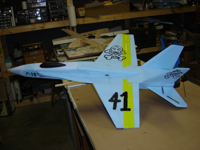

I just built an F-18 from the 3DFoamy.com plans and got it in the air (barely) The plane flies, but it is all I can do to keep it in the
air. It seems very underpowered and it is very hard to make it climb. I have to fly it with full up elevator and wide open throttle and
still can not gain altitude.
Nose heavy ? Tail heavy ? or just to heavy everywhere ?

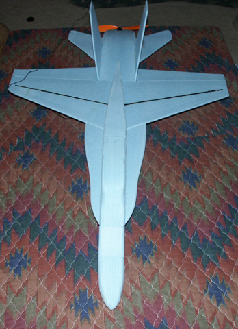

Ok, flew it again today after moving the battery forward just a little bit. It flew better, but still hard to handle.
I am also having to hold a lot of right aileron to fly level.
Here are a few pictures.

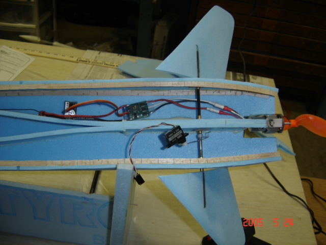

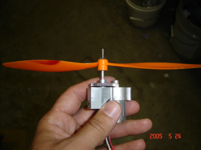

I think your antena wire running from the wingtip to the vertical may have something to do with that one.
I see you are using the Himax gear train (good choice). Have you considered using the C gearing like I mentioned? I think this will give you the amount of power you are looking for. I locate my battery all the way against the nose with an extension wire going back to the sc and rx. The plane should balance out on the spar at the fuse sides. Can you take a photo from the side?
If I am looking at the first pic correctly I think you need to turn your prop around too. It should face forward just like if it were mounted on the nose and you will reverse the motor direction.

Should the prop be mounted on the motor as if the motor were installed forward, or mounted on the motor with the prop FACING
the front of the plane ? It is currently facing backwards, i.e. the curved face of the prop is facing away from the tail of the plane and the motor is running backwards.
Also my CG is forward from the spar, I will move it back some more today and try again, if it isn't too windy.

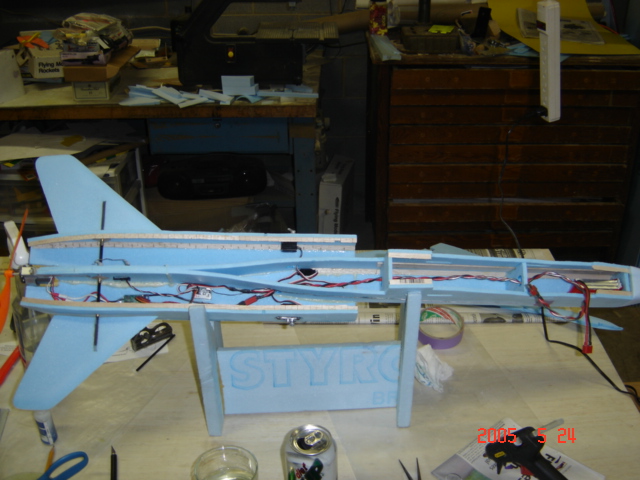

The front of the prop should face the front of the plane and then you will run the motor backwards. C gearing is 5.33:1 or the 64T gear set. I run my antenna out the front of the inlets and hot melt glue it to the side of the fuse. The CG is 2.38 back from the inlets or 3.87 from the front of the wing where it hits the fuse. Indeed a little forward of the spar.

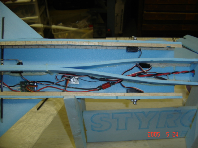

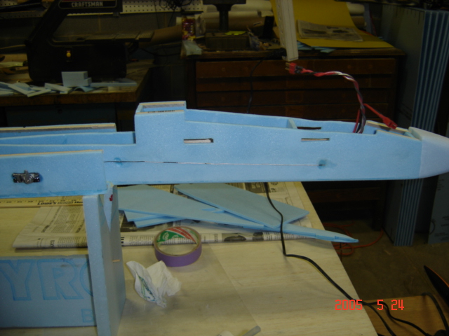

It was hard to tell did you have the prop going the right direction? If so you should have TONS of thrust.
I was able to get all the radio and flight gear installed last night here is how it looks.

No, I think my prop has been on backwards, the side of the prop (GWS slowflyer) with the prop size printed on it was
facing away from the motor, unlike the pictures you posted.

I think you just solved all your problems. Your plane will want to jump out of your hand now.[sm=bananahead.gif] I have my stabilator throw set to 50% and 15% expo to make it easy to fly. I went ahead and left my ailerons at 100% cause I like scaring myself.[8D] Have you watched any video of how it flies? When you land make sure the throttle is off, the prop will continue to spin in the air but will stop when you land without breaking. Also you want to let go of the elevator stick so you go back to neutral just before you touch the ground otherwise you will break the tips of the stabilator when they dig into the ground.
Your gonna love this thing!

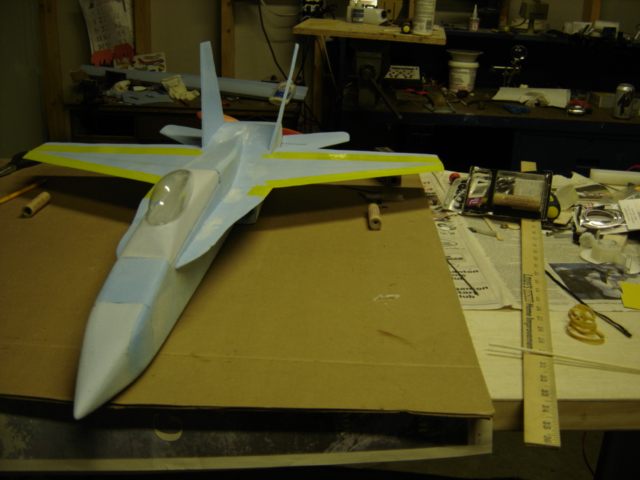

Now get some paint on that thing.
Warning don't have an open paint container near alcoholic beverages and an unpainted model! Your plane won't respect you in the morning. I am a self proclaimed professional alcoholic beverage handler and this happened to me.[sm=stupid.gif][sm=spinnyeyes.gif]
mental note: gotta keep the foam away from that stuff too[sm=stupid.gif]
