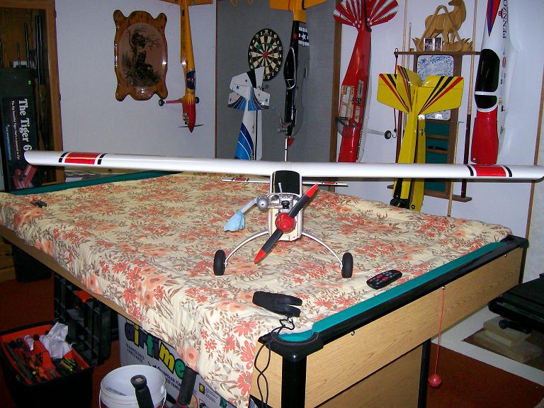

I am working on converting my 2nd Nexstar I recently aquired for some work I did into a tail dragger, and will probally take the dehedral out of the wing. I need to pick up some wood. I will post some pics when I get the project under way. My fist Nexstar (first plane) is still running strong, she is a bit banged up but still a decent flyer. I did the flap and dual servo conversion to that one, I will probally keep her stock. If I like the way my 2nd one flys after all mods, I might consider doing it to that one too.
I had some tracking issues too, It just needed some wheel adjustments and some thrust adjustment.
Old 11-16-2011 | 04:47 PM
  #118
Sourkraut's Avatar
Joined: Oct 2006
Posts: 356
From: Redneckville, CANADA
Default RE: NEXSTAR ARF .....PROBLEMS...PROBLEMS
ORIGINAL: Nitro Ray
Your going to love taking off, flying, and landing the NexStar with the taildragger and dihedral remover mod.....I sure did!

A few years, there was a plane that was much like a NexSTAR with no dihedral but it was a trike. It was a Midwest Aerobat. Minnflyer did a review on it which led me to buy one. It was such a fun plane to fly. It was a semi-symetrical wing, though, not a flat bottom wing, if I recall correctly. I'll have to look at Minnflyers review to recall what it was. Here is the link.
http://www.rcuniverse.com/product_gu...fm?kit_id=2569
Unfortunately, one day, it was windy out and I flew it, oh, four or five flights. After the last flight, I landed just fine, taxied over to the pits and shut it down. I put it on the ground next to the work bench and walked over to my car to get something. A gust of wind came, picked up the plane, flipped it over, and crunched the area of the fuselage where the front of the wing sets in... broke it all to hell. There was also damage to the vertical stab and to the area around the tail feathers.
I still have the plane but other projects led me away from it, but it still sits there waiting me to fix it and get it back up. I was thinking of making it a tail dragger, though.
If the Nexstar conversion flys like that, well you will have a lot of fun with it.
