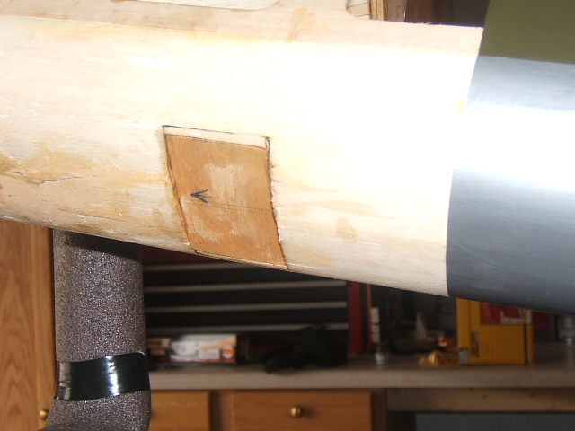

Hey wheels!! Ive got a nextar and have had major problems w/ the tri landing gear. Ive thought about making it into a taildragger but dont know were to start. Taking the dihedral out of the wing was a great Idea. coud you tell me a bit about where you put the forward gear. was it just behind the gas tank.. thats where it looked like it could go to me but what did u do?

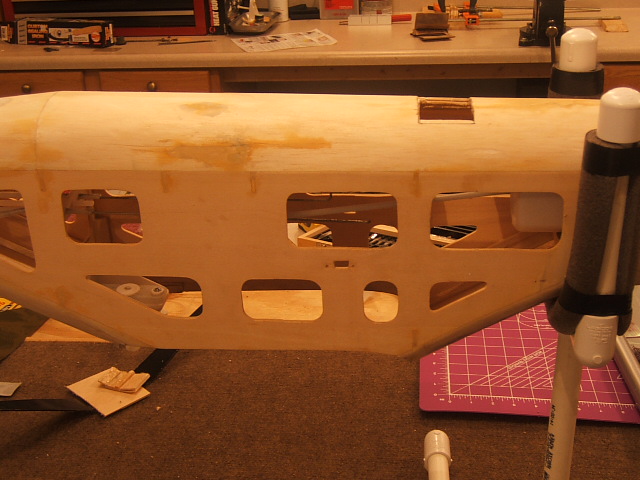

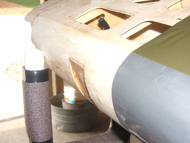

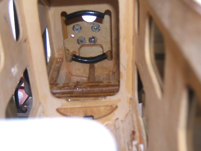

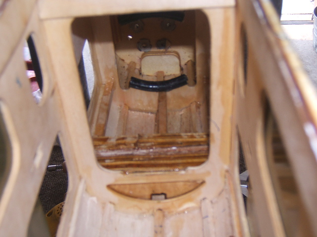

SpitfireAce......I have some pics of how I did the landing gear. I think you will see by the pics how I did it. If not, let me know.

Yeah I think I can tell how you put the front gear just behind where the gas tank is inside.
Maybe, (if its not too much to ask) you could measure back from the front of the fuse on the bottom of the plane, to the area where you put the gear?
Also, I geuss you just screwed the gear into a piece of like 1/8 ply?
did you take all the covering off of the plane before re-covering in the sweet new bird dog trim scheme?

SpitfireAce.......1/8 inch plywood would not be enough unless you glue several peices togeter. I would guess the thickness from front to
back is a piece I built, about and inch thick, and tapered up along the fuse. I'm sorry its not right in front of me, but doing it this way it is
a little bit thicker than the thickness of the landing gear. This way I have plenty of hardwood to screw the landing gear into. I prob should
have drilled up through it and used plastic screws just in case, so the plastic screws would just break in the event of a harsh landing.....but
trust me.....installing them where I did, this thing lands like a piece of cake . If you look at the photo again, you will see which bulkhead I
glued up against and then also I run some pieces up towards the front along the side of the fuse to the next bulkhead forward, just to give
it a little more strength. Trust me....if this thing ever breaks.....its going to take the fuse with it, thats why it might be smarter to use
plastic screws so they might break (only) and not damage the rest of the set up.
Hope this helps

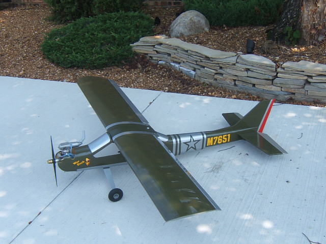

ok.....I liked keeping as much of the factory attaching mechanism as possible. Also, was very concerned about strenght. I think the way I
did it, it will be even stronger than factory setup. Also, even tho the wing struts I installed were purely for looks, they could also add some
security in the event of a serious crash I guess. But now this plane flys so well.........if it crashes......it will be my thumbs to blame now !

Lureman.......well ..... sounds like the way it all started for me. Not a fuel problem but.....A CRASH. Once you have a big problem and
have to fix something anyway, its a real easy decision to go a little wild and try something new.
I like the idea of the L-19 look. In hindsight, I wish I would have put on Invasion stripes, and am still thinking about it. Also, I need to
come up with a new idea for wing struts that are quick and easy to install at the field, and yet look good. Still working on that.
