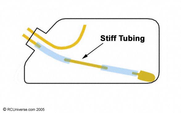

bruce,this is from one of the links here,If the tank has a bubble section, position the muffler pressure/
overflow brass tubing inside the bubble for maximum tank capacity. Most fuel tanks include enough brass tubing to fabricate any three-line system.
Try to reach into the bubble with as straight a brass tubing !QUOT!run!QUOT! as possible. This helps prevent the fuel !QUOT!pickup!QUOT! line from wrapping itself around the vent tubing and getting STUCK in a full forward position, which could cause the engine to quit during the next vertical maneuver,or cause a lean run condition.also run the pressure line or vent line too far into the fuel tank and have your airplane sitting ready for your turn in the box and see how much fuel siphons in the muffler and even engine.sorry for not going into detail that was my meanning.he said fuel was coming out of the carburator like the engine was flooded.

I see what you are saying. I always make my went/pressure lines bend up near the top of the tank and into the bubble if equipped and assumed all others did as that is typically in the directions. To avoid the pickup line doubling back on you is very easy, just add a brass section to the line longer than the with of the tank and then it can not. You could also place a soda straw over the outside of the tube if preferred. I'll see if I can get RCKEN to add a graphic here of this. I don't believe the vent line siphoning would appear as fuel in the carb. The entire engine would have to fill with fuel first IMO.
If anything, due to the inverted installation the tank may be too high in relation to the needle

RCKen's Avatar
RCU Forum Manager/Admin
Posts: 28,255
Received 31 Likes on 27 Posts
From: Lawton, OK
Default RE: Trouble getting engine tuned?
Bruce,
You're wish is my command!!!
Ken
ID:	315246   Click image for larger version

hey thanks Bruce,i have never seen or thought of using a brass tube between the clunk.thats why i love this place someone has done or has a better idea.thanks again...happy flying

Can't take the credit for that one. I learned it here also. Just repeated it for you. Hope it helps.
