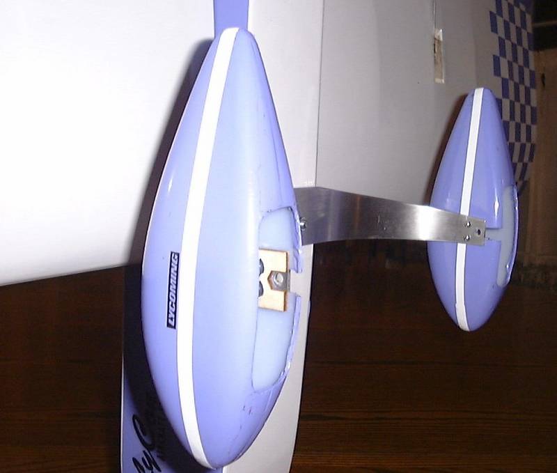

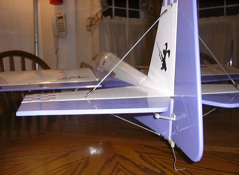

i have built two of them they go together in about a week if you work a couple hours a day,i put the Irvine 53 on mine that makes it really hot when you want to switch to high rates.i would suggest installing the rear wires on the tale with that engine.on high rates with those large ailerons it will do about 3 spins a second.ans slowed down on low rates it will float in.i wouldn't put on the wheel pants if you are gonna take off on grass they wont last long.and the wing i have seen a few people here use screws or plastic ties, screws you need to modify the wings some.i have some photos of the second one i built i will try and post them for you.hope this helps some....happy flying

here is a few pictures

do you use screws or plastic ties horace? i am gonna put the wheel pants on as i fly off a full scale runway out of lake whitney state park, the end of the runway is about 100 yards from the water(the runway itself is 2000+ feet long) also they go together that quickly i was expecting a lot longer for some reason. and finally, thats a nice tight covering job you did do you have any pointers. as i have never done more than patch.

biqox,i use the plastic ties,for some reason i just don't trust rubber bands.the other extra i have,i installed plastic bolts.at the jbolts on the wings i also added a block of hardwood behind the rib then tapped it with the jbolt and used ca to harden the threads also used longer jbolts i made.i should have made the fuel compartment hatch removable but read that weakens the front end so i didn't.this thing is fun on high rates.i used untracoat for covering it seems to do a better job for me.i make most of my decals thought it might dress it up some.a lot of people don't care for them my daughter and i do them.they are printed on clear sticky back plastic then i coat them with urethane to fuel proof them.i will make some pictures of the other one i built and pose a few.hope this helps some ....happy flying

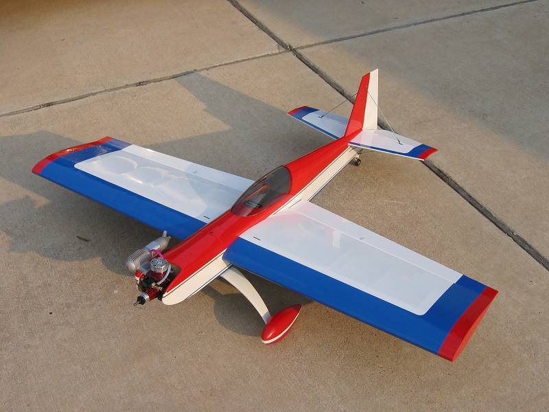

I love my SE with an Irvine .53. Has all the power I need.

horace315, I see da bunny ! Do you also own a Wild Hare? or just liked the bunny?
