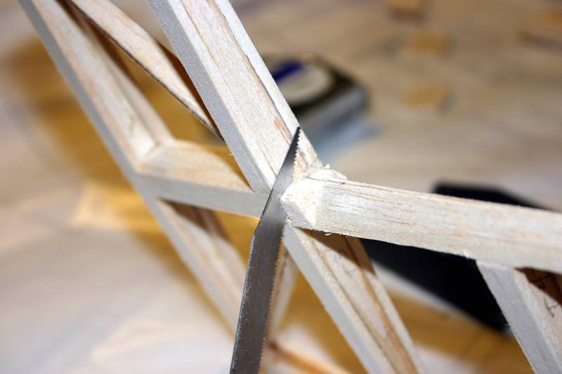

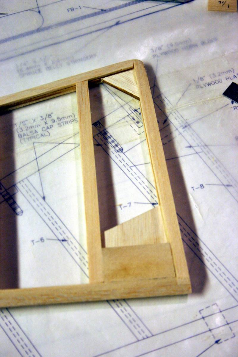

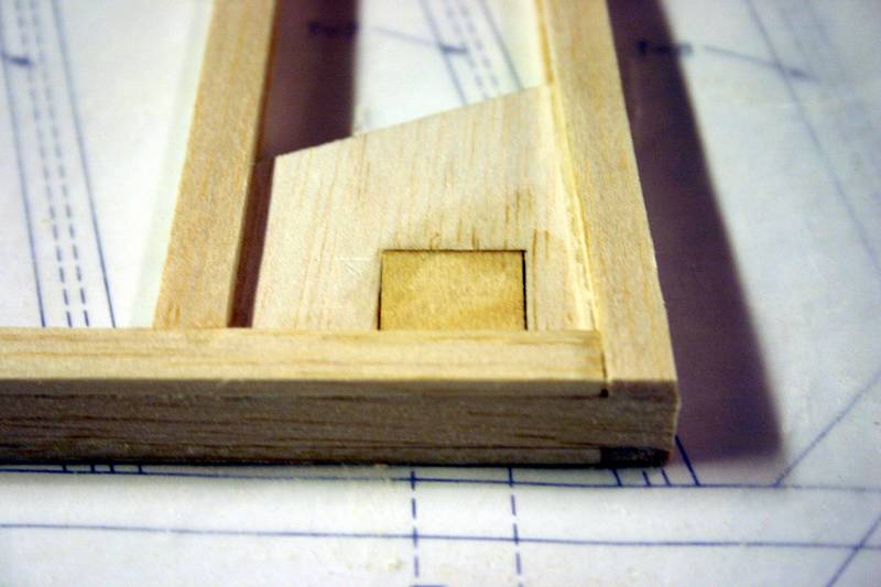

I then squared up a 3/4"x3/4"x3/8" plywood block to fit snug in the rudder front block opening. I used 30 min epoxy to glue in place. Next I cut a 1/8"x1" plywood block to fit in place over the 3/8" block on both sides of the rudder front and glued them in place as well with 30 min epoxy. I then Clamped the blocks in place to dry overnight.
ID:	338176   Click image for larger version
ID:	338177   Click image for larger version

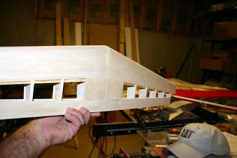

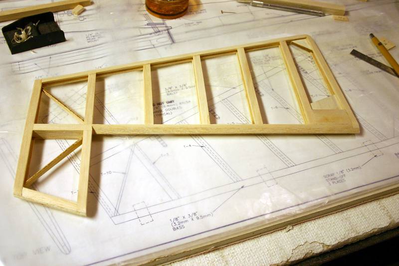

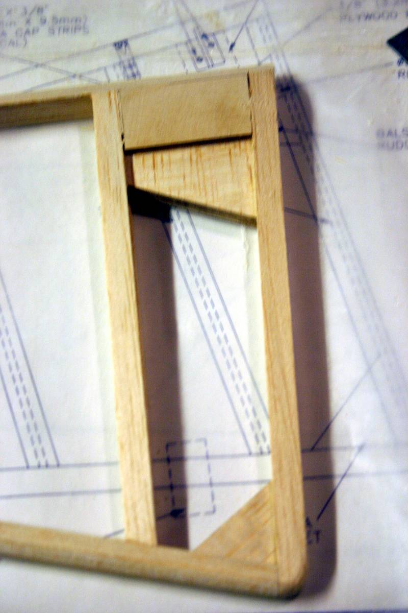

After the blocks dried overnight, I sanded them flush with the cap strips on t7 and t8. Then I drew a straight line down the center of the leading edge (close enough) to begin shaping the bevel. I also marked a reference line on the end of the leading edge to act as a guide to shape to. Next, started shaping the bevel with a block plane to remove most of the balsa and rough sanding to the angle with a bar sander. In pic #3 you can see that all the bevel could not be shaped using the sander or the block plane, so I made a back cut with a razor saw and carved the remaining bevel tips out with a hobby knife. This is the same as when I did the elevator bevel. The end result came out pretty good.
ID:	338188   Click image for larger version
ID:	338189   Click image for larger version
ID:	338190   Click image for larger version
ID:	338191   Click image for larger version

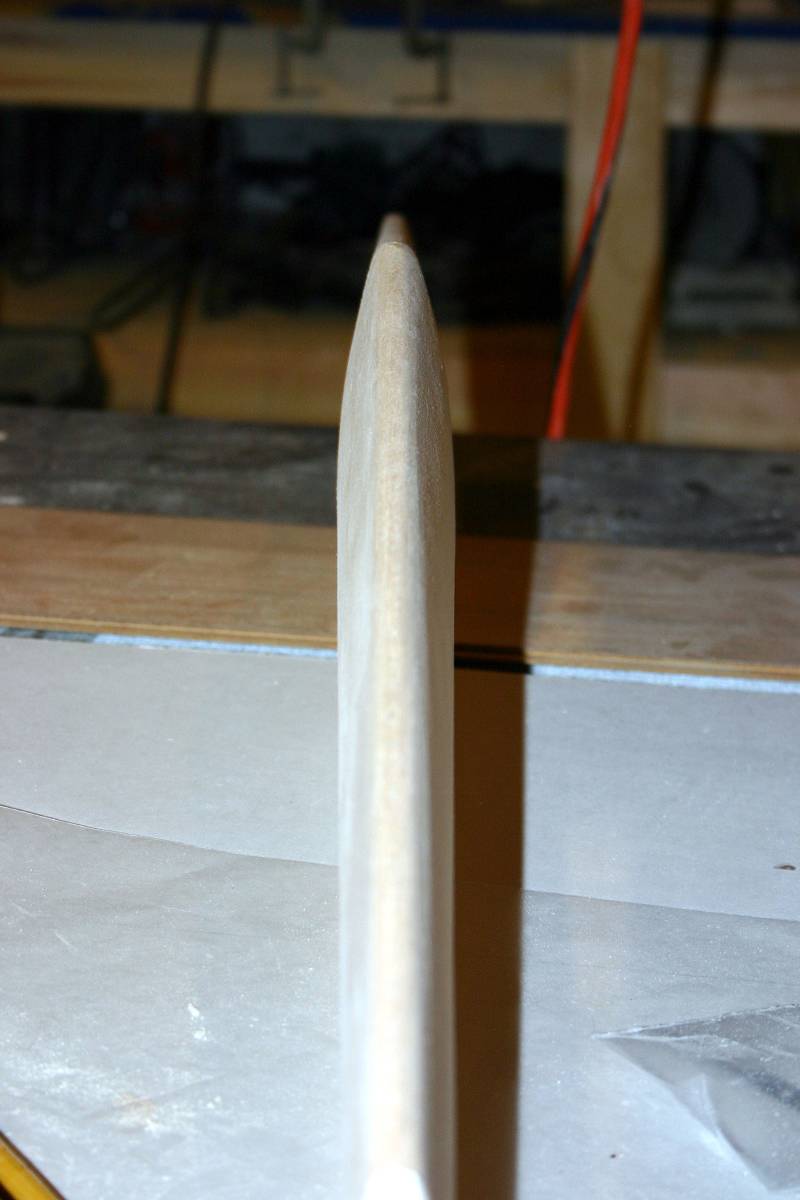

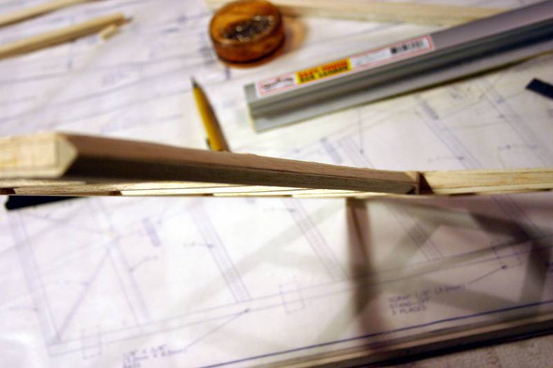

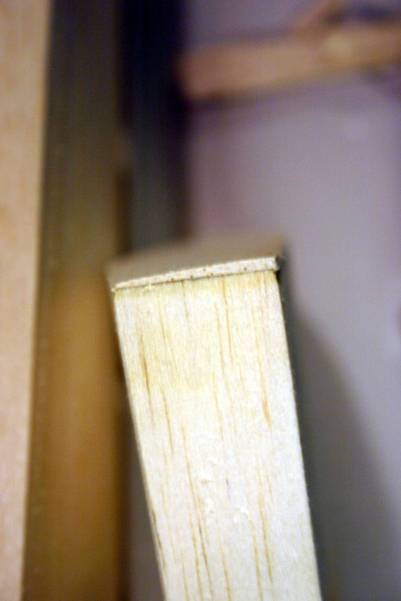

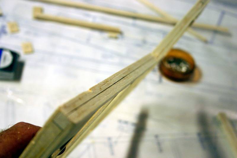

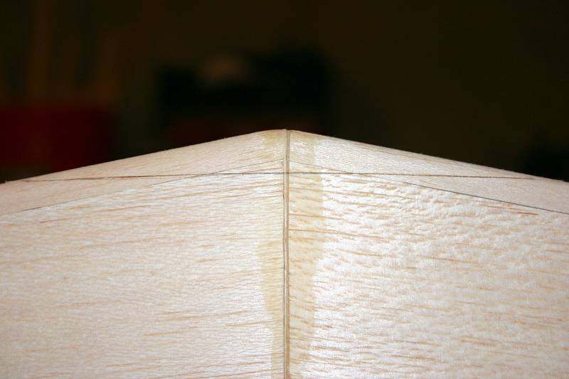

I then began rounding the trailing edge bottom corner, the trailing edge, and the leading edge on the counter balance. Also did some general sanding and flushing things up a little more. As you can see I will still need to do some more sanding before this piece is ready.
ID:	338222   Click image for larger version
ID:	338223   Click image for larger version
ID:	338224   Click image for larger version
ID:	338225   Click image for larger version

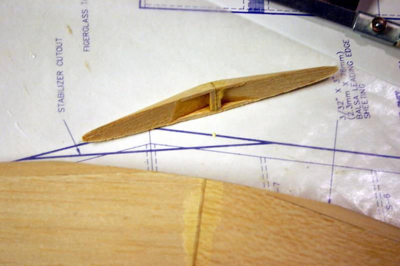

Next I placed the rudder and the Vert/stab on the plan and marked the location on each for the hinge doubler blocks and glued them in. I also rounded the leading edge of the vert/stab.
After this is said and done, the rudder I mean, it dosn't appear my concerns of the thin trailing edge and the rib attachment were with any merit. The rudder seams to be pretty strong as built. I still think, however, that Midwest could have done a better job of laying out the sizes on the ribs in the rudder.

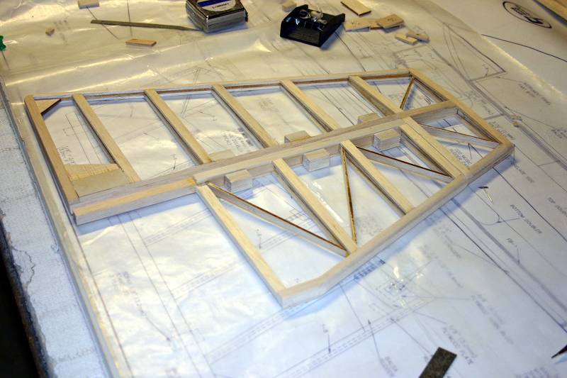

Old 10-18-2005 | 08:13 PM
  #55
Digger44's Avatar
Joined: Dec 2004
Posts: 532
From: Newnan, GA
Default RE: Midwest Extra 300xs Build

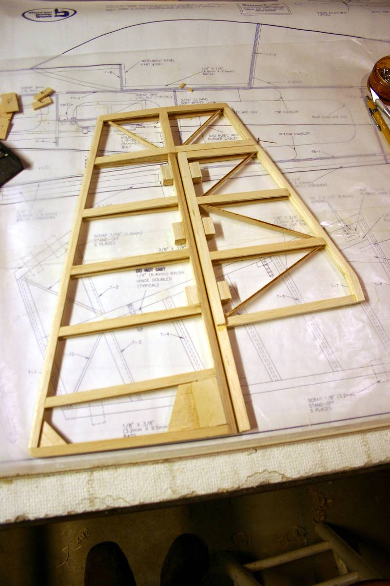

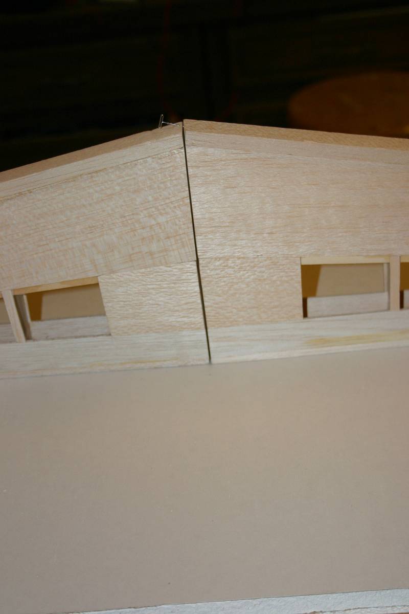

Finally got back to the shop, I had to break for a few days to fly, the weather has been fantastic.

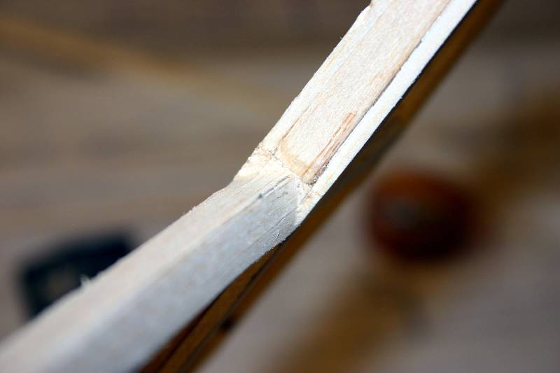

Well I screwed up but "I think" I fixed it right. The first pics are of the horizontal stabs lined up on a straight line and you can see in the first pic that everything seem ok, but wait. The back side has a 1/16" to 1/8" gap. So what I did is took a piece of 1/8" balsa and epoxied an end cap on the stab. Then sanded the end with the proper angle to fill the gap solid. I must have missed the end rib moving while setting the first top spars on the assembly. This looked like the most obvious fix to me, can't think of another way to do this. Any way, after sanding the end cap to fit, they lined up well and no gap. Then pinned one side to the board making sure to center exactly on the line. I glued the two sides together with 30 min epoxy and clamped at the tip to let dry overnight. Next step will be to shape the leading edge and fill and sand the rest of the surface.
Then I took another break to go flying. Be back soon.

Old 10-19-2005 | 03:22 PM
  #56
Joined: Feb 2005
Posts: 2,102
From: Zephyrhills, FL
That'll work !!! I'm going flying tooooo. ENJOY !!! RED

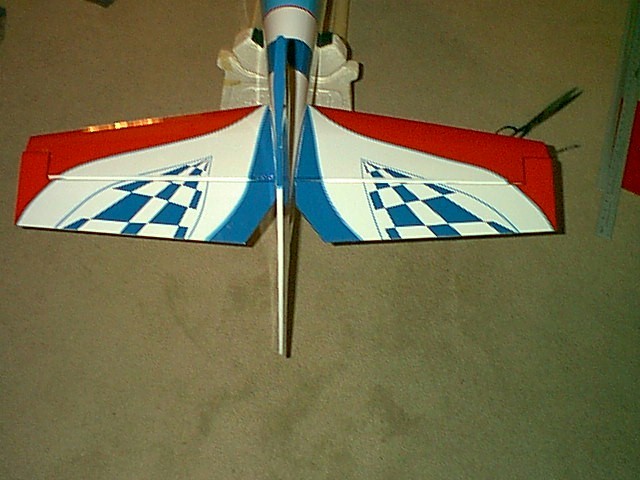

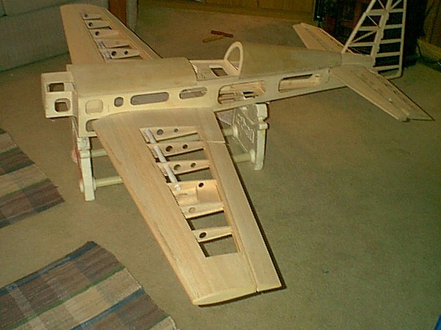

Heres a couple of it sitting together ,the wing is attached but the tail feathers are just setting in place .

I remember those days when I was building the plane. It was fun to imagine how the plane will be at the end.
Last weekend I maiden my MW extra300S again after last year crash. I crashed because I fogot to connect the ailerons after a short stop and go. My smoke system failed to work so I landed the plane quickly and removed the wing, fixed to smoke tank and attached the wing (without connecting the ailerons) and flew again without a pre-flight check.
In the air, whoow, into the trees and fell down 40 meters, ripped my tail completely and stripped my wingtip. And ofcourse all plastic parts were broken.
But now my I've got my extra up and running again and better then ever. Finally I've got the best stripescheme I have ever made.
And I installed a little down trim on my engine. It seems like really helping landing the plane. The first and last two landings this weekend were landings like the real one. I mean a touchdown with two wheels and a long after run.
And again I felt flying this plane almost better then ..... You know.
You better get it finished quickly. :-)

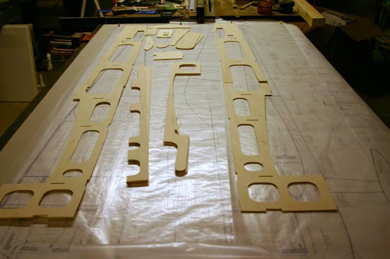

I started building the fuse today but before I get to that I have a few pictures of the leading edge shaping on the stab. After shaping, the tip is marked, cut off, and saved for fitting later on when installing the stab in the fuselage.
ID:	357887   Click image for larger version

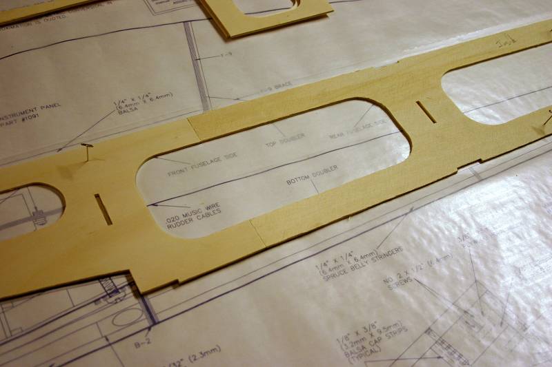

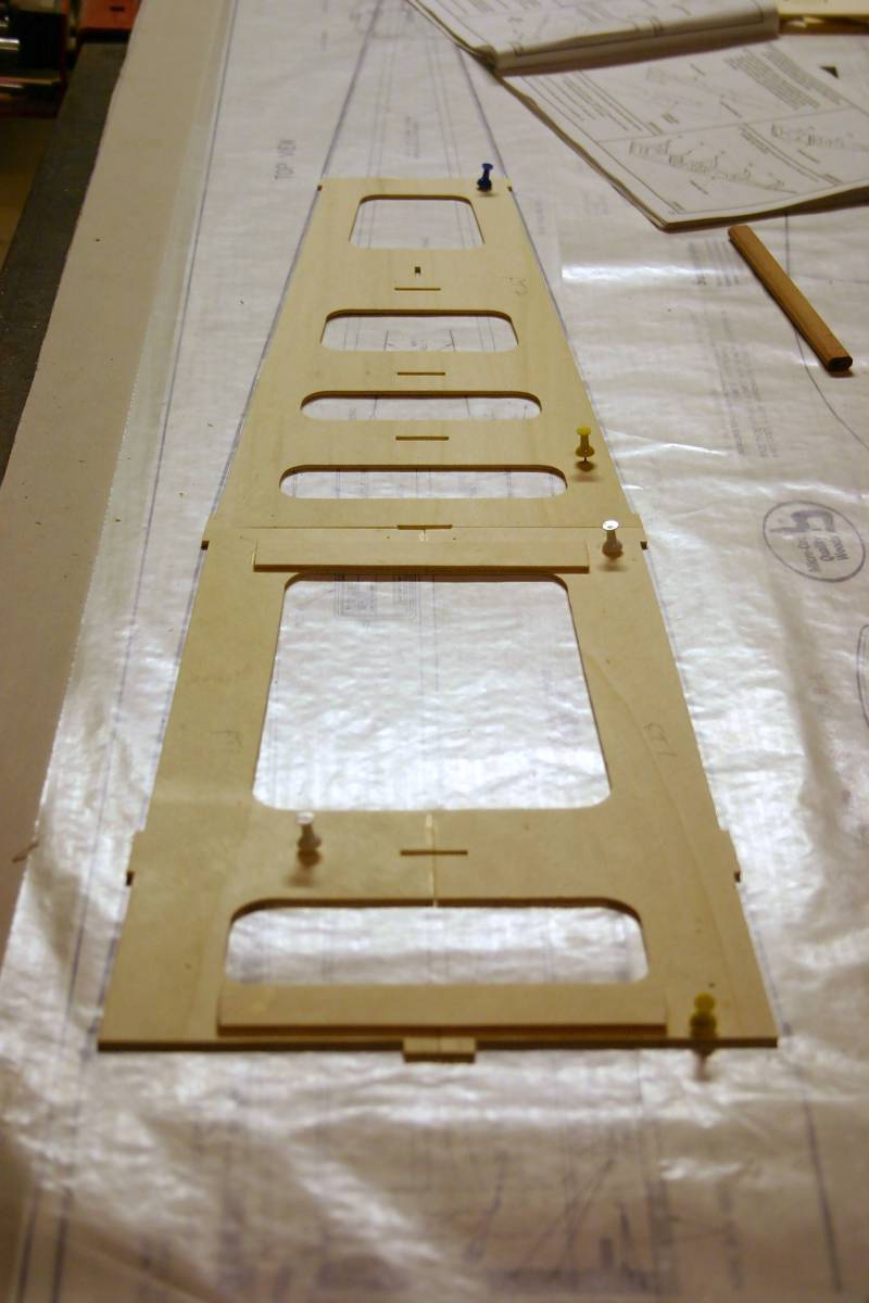

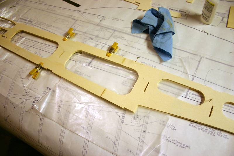

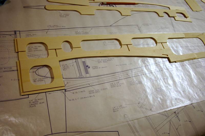

Started by laying out the fuse sides and doublers and checking for the proper curve and marking the insides of each half. The curves needs to be toward the outside of the fuselage. After matching the sides up, I measured and marked the 6mm lines for the doubler edges on the front of both front sides(inside). In picture 3, I pinned the front and rear fuselage side to the plan with the inside facing up.
ID:	357903   Click image for larger version
ID:	357904   Click image for larger version
ID:	357905   Click image for larger version

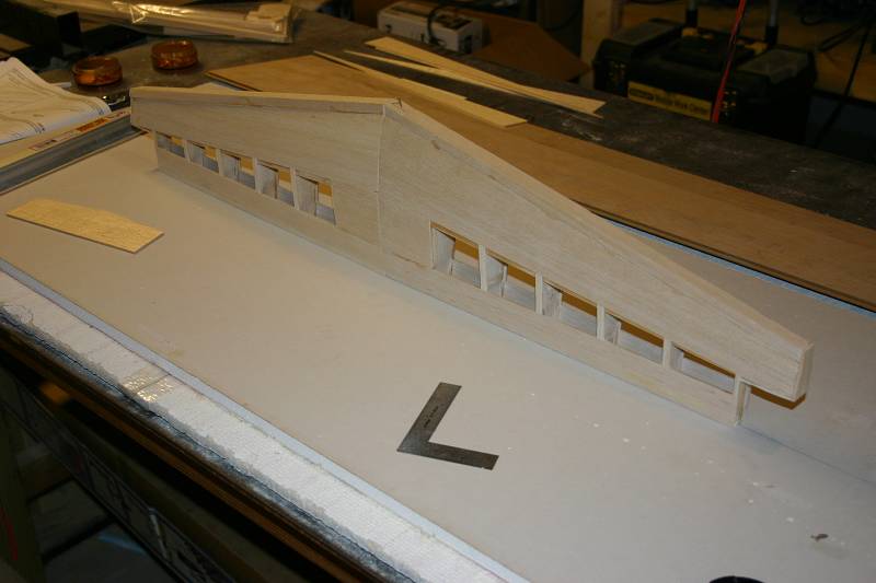

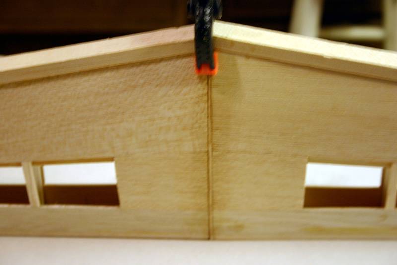

After pinning the side to the plan,I glued the seam with thin CA. Then I added the top and bottom fuse doubler and glued them as well. Nest I added the Stab doubler to the rear of the fuse side.
ID:	357907   Click image for larger version

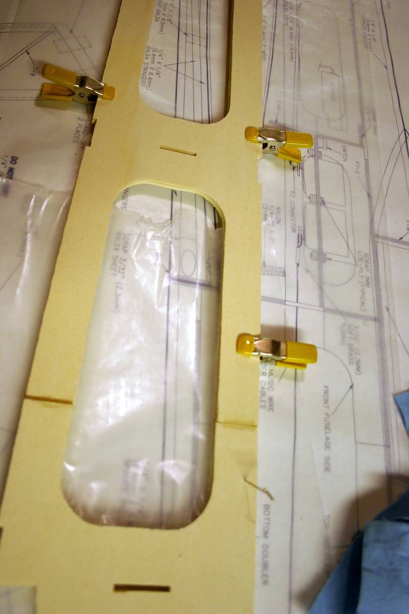

When I started to do the opposite fuselage side it dawned on me that I couldn't pin this side to the plan with the inside that I marked facing up. Only one side will be correctly oriented over the plan with the inside facing up. So what I did was clamped and pinned the completed side to the other as a guide for correct alignment. I also put wax paper between the two sides to avoid gluing them together. After alignment was correct I glued the doublers on and started laying out the fuse top above the top view of the plan.
ID:	357919   Click image for larger version

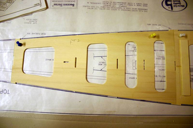

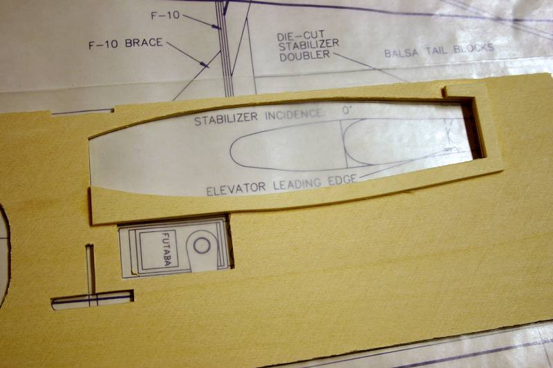

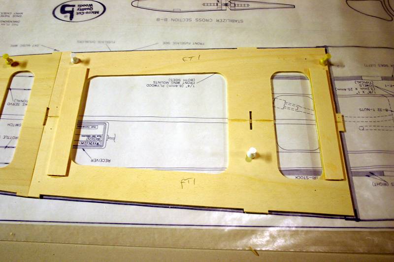

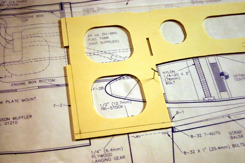

I placed both FT1 pieces over the plan and glued them together. Then cut the doublers for the front and rear and glued them in place. Next I added FT2 over the plans and sanded the ends for a good fit and glued in place. Again the same process for FT3.
ID:	357923   Click image for larger version

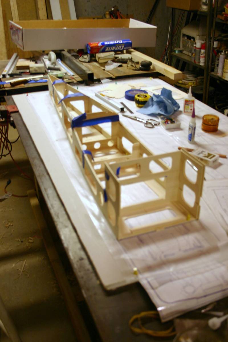

After all 3 fuse tops were pinned and glued to the plan I decided to do a dry run with the formers f3 -f7 and both fuse sides to check for any mistakes and squareness. I might also see any tab misalignments at this time before gluing everything up. I used painters tape instead of glue for the dry run.
