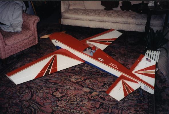

This will be more than a few steps from a 0.40 size plane. It certainly is a worthwhile project and I like to see building happening. Your engine choice will be a good one for the plane. I had one with a Quadra 52 on ignition. The changes in the "tail feathers" is a good upgrade as the flat stabs had problems if not really braced. The hardware is sorely lacking. I would use it later for planes up to 0.60 or maybe 0.90 glow. Use Hangar-9 or Nelson or equal hardware (formerly Rocket City). All 4-40 linkages, giant scale servos and the like will be necessary. Attaching a photo of mine.
EXCAP232

I agree, this is a big step up from .40. In one of my previous post I mentioned the GP Extra 300s 40. I didn't mean that was all I had. That was the first one I built from a kit. I was pretty fortunate about 6 months ago and picked up a whole fleet of aircraft from a friend getting out of the hobby. Katana 1.40, Funtana 90, 60 Extra World model(I think),to name a few. Prior to getting these I already owned an Arrow(my trainer), 60 Ugly stick, 90 Dioblotin, H9 Pizazz and the GP 40 Extra. I havn't flown all of the aircraft in the hanger yet as some of it is in need of repair, mostly minor stuff.. Lately I have been flying the Funtana,Pizazz,and the Stick. Just not enough time to fly and repair all of it and enjoy building as well. Some of the planes I have will be great to repair and fly when one of my current favorites expires, and you know they will.
I agree that the hardware is lacking! I planned on using the hinges, wheel axles and landing gear, probably nothing else.

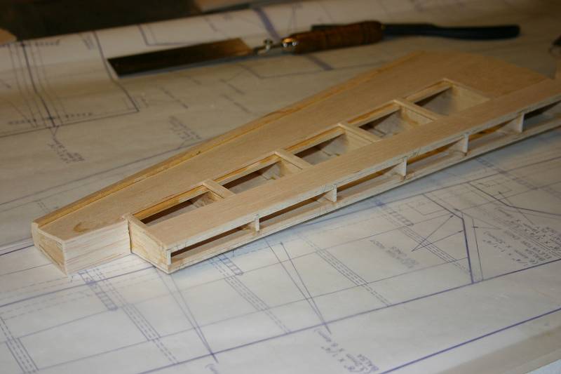

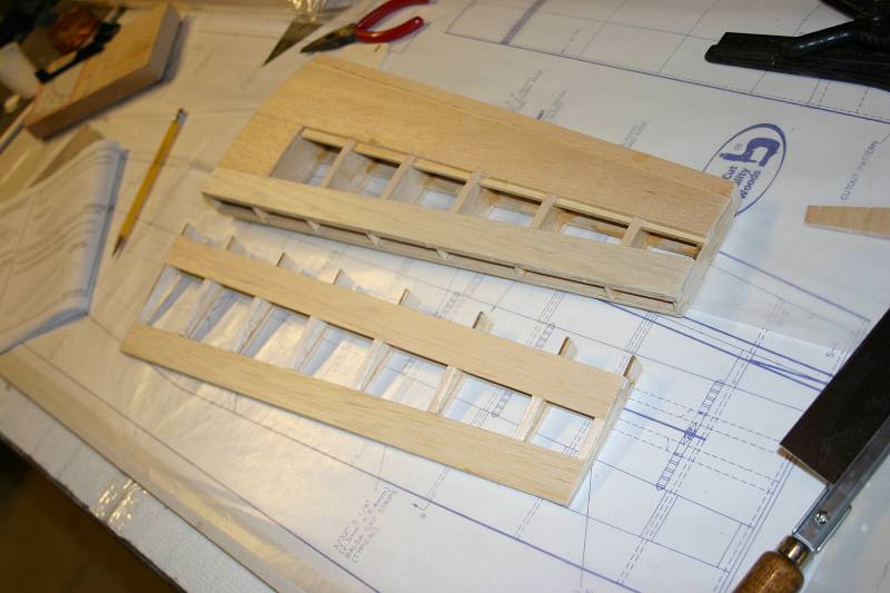

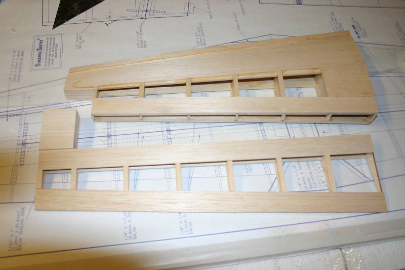

Ok, I started building the left horizontal Stab/Elevator today. Didn't get finished with it but a good start indeed. This section is built in one piece as both the stab and elevator and the cut when close to completion, after the sheeting has been done. The ribs in these pictures are set with the guage that tilts them slightly towards the tip of the stab.

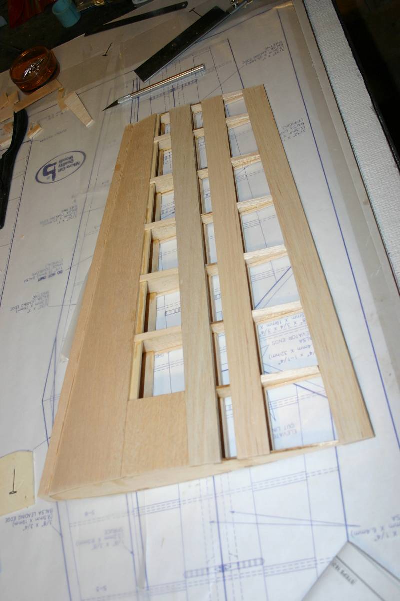

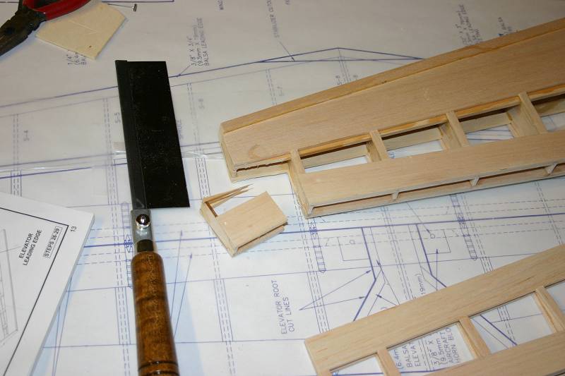

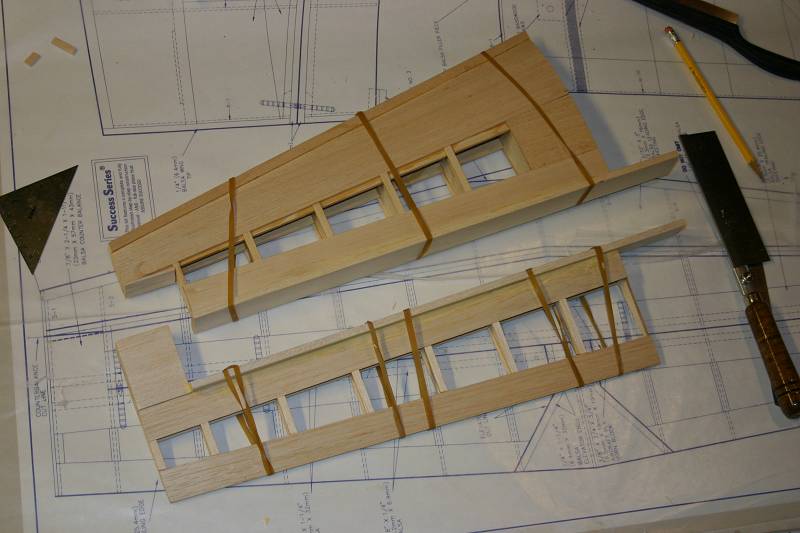

These pics show the leading edge, top spars, and some of the sheeting. All of the overhang will be trimmed off later when the bottom side is sheeted.

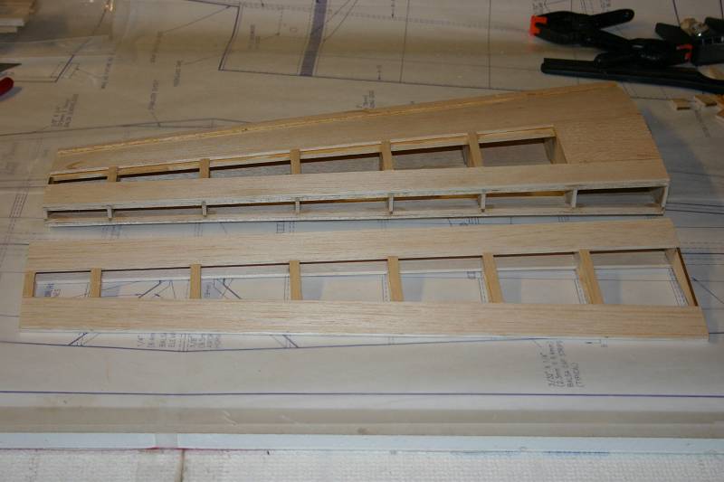

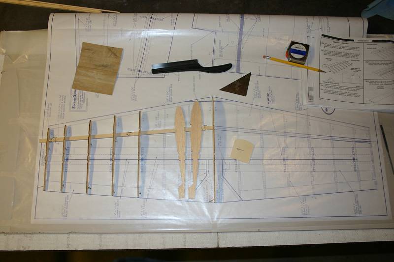

This one is the stab with all sheeting on the top side and the rib cap strips installed. The upper left and the lower bottom cap strips are left off until later.

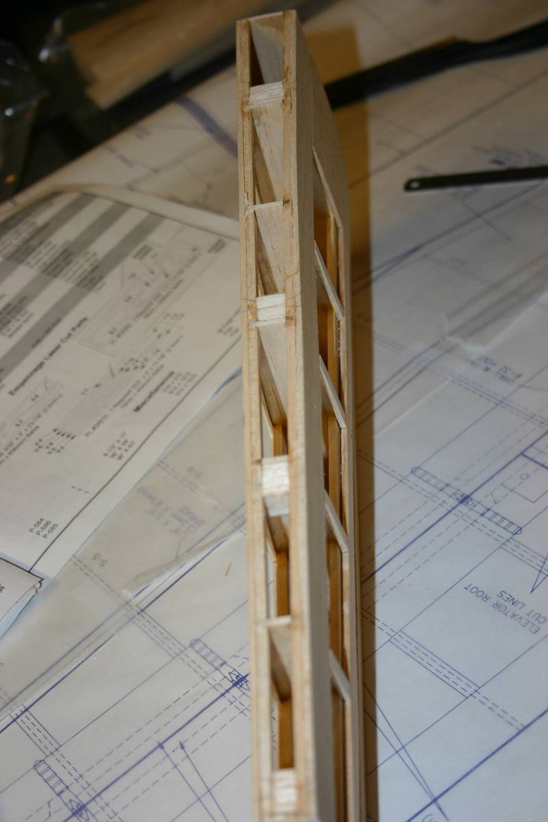

The instructions called for using scrap 1/4" balsa hinge doubler blocks to be installed in the stab between the ribs. I changed this to 1/2" and also added the hinge doublers in the elevator. Then, using tightbond, I glued the trailing edge of the stab and the leading edge of the elevator in place and banded it up to cure overnight. FYI, what I am trying to do with this build is to use the tightbond where there is going to be considerable sanding. I am still using CA in other parts of the build because of the time factor.

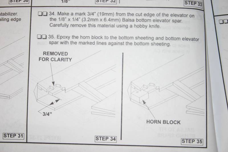

In this picture on the right, step 35, the horn block itself looked to me to be a little short. I plan on using a horn assembly that goes all the way through the the elevator, like the central hobbies one in post # 10. I would modify by using a 3/4" dowel flush with both surfaces and then drilling to accommodate whatever hardware is installed.
In this kit they call for a 6-32 post that is installed inside of the elevator, nothing exposed on the surface at all. I just think this might be asking for trouble if it ever loosens up, there will be no way of getting to it to re-tighten it without cutting into it. I may be wrong on this one? This might be the normal way of doing this?? What do you guys think?
