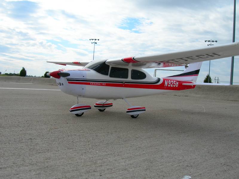

Well I am a noobie at this but I just purchased a Art-Tech Cessna 182 and I am awaiting its arrival. I don't know how much there is to building it but I thought I would post up some information I have found while researching it.
I decided on the Cessna 182 -4 channel after seing its realistic graphics and design, also I got hooked on it also after seeing this guys plane:
I also read some threads that got me to where I thought it would make a good 1st choice once it is set up properly.

Tips
1. Packaging Tape on Fusalage and Wings.
2. Upgrade Battery, LIpo adds 10-15 Minutes flight time.
3. Getting longer flight times -Use peak Charger to charge battery.
4. Cut throttle off when in trouble.
5. Avoid bad flying conditions- Do not fly in windy conditions. anything above 5mph.
Videos
http://www.art-tech.cn/english/Artic...p?ArticleID=86
http://www.parkflyers.com/html/body_cessna_movie_3.html
http://www.knvonline.com/files/cessna182s.wmv
Controls
4 Channel Radio Controls:
Throttle (Up and down left stick)
Rudder (Side to side on left stick)
Elevator (Up and down on right stick)
Ailerons (Side to side right stick)
Throttle: Used to maintain flight and vary flight speed with need.
Rudder: Rudder is used to turn the plane on the ground and in the air.
Elevator: Uses to make Plane climb and descend. Also used for loops.
(make a note that pulling down on elevator makes plane climb, and up elevator makes plane descend)
Ailerons: Used to make sharp turns and to perform rolls (corkscews)
1) Before 1st flight, cycle battery at least 2 times to ensure you’re getting full power out of it. (cycle means charge and run down the battery twice before using to fly)
2)On take off you want to take off from a smooth surface on the ground. Apply full throttle and gently pull down on the elevator.
Climb to a safe altitude before you make turns.
3)Don’t try to over control the airplane. The biggest mistake a novice will make is trying to over control. Just give gentle inputs from the transmitter. Remember that when making turns you need to compensate by adding up elevator (down on stick) to keep plane in level flight. Remember that too much stick in any direction may cause the plane to stall.
4)Remember on the elevator stick, up is actually down and down is up.
5)Make sure antenna is full extended on the transmitter and that batteries in transmitter are in new condition.
6) If you think your going to crash, shut the motor off right away. This will minimize any damage sustained to aircraft.
Note : 80% of crashes are from one thing: turning too sharp too low to the ground. You may not realize how fast a plane could drop in a tight turn and underestimate the importance of using the elevator to keep it level while making turns. The other 10% is from not keeping the flying speed up (too much elevator and/or not enough throttle) so it stalls and then falls out of the sky. The last 10% comes from pilot disorientation (losing your bearings when plane is in the air)
I am looking forward to getting mine!

sweet pic!! another upgrade, although substantially more money then probably the plane itself, would be to put a nice outrunner brushless in there. combined with lipos that would have great power and incredible flight time.

I own a Cessna 182 and the stock motor has plenty of power, especially if you use a lipo battery (flights last longer and overall weight drops noticeably).
Don't know where you are getting yours from, but I've heard some of the sources on E-bay use a 370 motor, instead of the 480 motor. Parkflyers.com offers the one with the more powerful motor. There is plenty of power, so I don't think you will be disappointed with the stock motor.

Glad you liked my pics of the plane with the nav light system I installed into it , you do know I have also installed working flaps as well ? these a great little planes but I would recommend upgrading the RC gear { tx and rx mainly } to a more named brand ...eg Futaba or JR etc if you need any more info give post on and I will try and help you out if I can I wouldnt go brushless on this plane the stock motor has more than enough grunt with 11.4v li-pos .oh yeah your right about the wind it doesnt like when its lumpy up there !

Well done 3z3k3l, great posts, I'm sure you're going to love this little plane!! One thing I would suggest to prolong the life of the plane and to protect it from all the little bumps and scrapes is to totally cover the fuse and wing with clear packing tape. It weighs next to nothing (I can't tell any difference in the flight performance) and will give the body and wing heaps of added strength. It also looks great too, makes it look shiny, almost like a Monokote cover job.
I also suggest that you spend a bit of stick time on FMS before your maiden to get used to the controls. I made the mistake of flying my Cessna for the first time without getting a feel for the controls and promptly crashed on the maiden flight snapping the wing in three places and totally destroying the front end, cowling, prop, bent prop shaft, motor shaft. etc. I was extremely pissed off and the plane still looks like crap after I patched it up but it flies beautifully now I know what I'm doing!!
Be conservative until you get the hang of it!! ...oh and avoid the brushless hop-up, that'll be too much power for any newbie to handle. The stock gear is more than enough to get you in the air and learn on.
One thing in your favour is that you've picked a great plane to learn on!! Just don't go crazy and try to do everything on your first few flights and you'll be fine!! Loops, rolls etc will all come in time... I speak from experience having flown and crashed many times!!

Hey Guys, I just got my Ebay Plane,
Took no time to put together. I think what took the most time was putting the packing tape on everything.
I can attest that the shipment packing, it is just a box over the plane's box. But so far I can't tell if anything is damaged.
Ok, The instructions it came with are really for the 3 channel version. It came with a 72 Mhz reciever with 6 channels and 12 pins. Pins 2-4 were already used. Where do I plug the wings into? I am assuming Pin 1 right? as this is a 4 channel? Also I assume to follow the color scheme so all the cables are aligned the same way, seems white is at the top.
Anyways, here is my first real problem...
I heard somewhere that sometimes the battery comes charged so I plugged my battery in just to make sure it wasn't charged, well all the alearons starting moving and going crazy, is this normal? As soon as I turn on the Remote Control unit everything stops. But if I turn it off again, the tail starts going up and down and side to side like it is possessed.
Also when I try to work the controls on the reciever after I turn the plane and the reciever on nothing happen. The plane is one foot in front of me so I don't think it is a range issue. Seems like some circuits are backwords or I did not wire something right or could someone be flying another plane close by?(not likely but hey who knows)
Side note, I unplugged the wings out of the receiver and the problem still happens on the standard wiring. Is this normal?????
Where should I look for the solution?
I will include some pictures soon.
Thanks!

Thanks ABC, Your dead on, just a noobie mistake on my part. I did manage to fix it.
1. I had "used" batteries in the Remote- Bought new fresh batteries.
2. Battery wasn't fully charged...- I fully charged the battery and when I re-tested, everything was working great.
3. The wiring worked on the number 1 pins for the wing to attach to.
I took it out for test run today, perfect day for it, it is about 70 degrees & sunny and a 1-2 mph wind. I first tried a throw launch at full throttle but the plan didn't climb at all, just flew forward then decended down, like there was not enough power. Hit the dirt hard.
I then took it to taxi out on some open pavement. I think I definately will need an steerable nose wheel. If anyone has a guide on how to build one I would love to hear it. It did great, got up to speed fast then started to take off, but immediately went left and onto the pavement. Think that one messed up the motor because now it sound like someone dumped a bunch of metal bearings inside and they are just bouncing together, but the motor still works. It's just loud.
After that I decided to just practiced mock take offs and turning and getting use to the controls.
I may end up buying the flight simulator software just so I don't mess up the plane, as I realized how much I don't know the controls just by taxing around.
Next I am going to get the lipo battery and charger, that and possibly the flight software to get me familiarized with the controls, anyone know where I can download it instead of waiting for shipping?
So far its great, Now to get it in the air...
****Update on Motor:
I found out what happen to the motor. I heard something rattling in the plane when I brought it home, I took off the wing and out popped this bushing.
The round bushing at the top had fallen out, I placed it back in and took a hammer and a large screw head, turned the screw upside down and lightly tapped the bushing back into place.
I put the motor back in and hopefully all is well. The shaft doesn't move from side to side anymore like it used to so I think its fixed. But I think I may have chipped a capacitor so I will see what happens.
